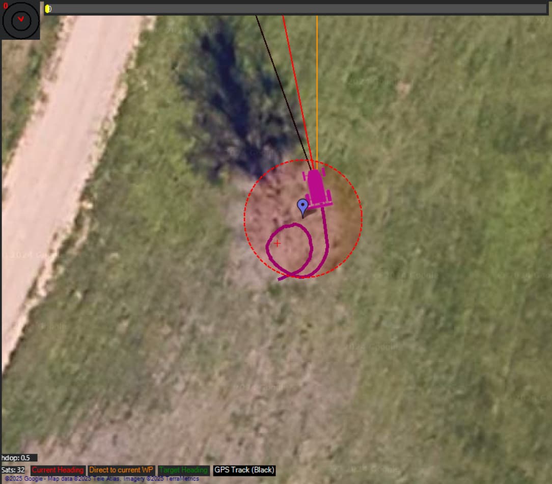

Ok - ran a test, in acro mode (to capture where my trees are). Here’s the .tlog that when played in MP, shows the path around the tree in purple, and the exclusion fence I’m trying to locate (RTKFixed):

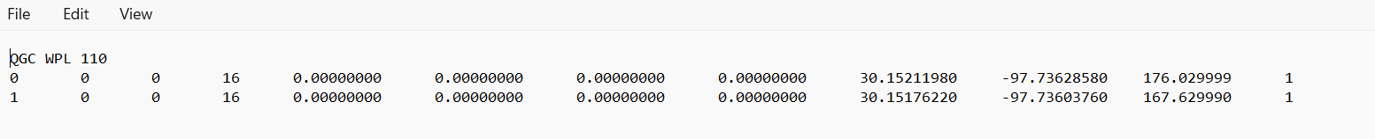

If I upload the .bin into the web Hardware Report, scroll down to the “Download Waypoints”
[waypoints_0.txt] selection, I get only 2 waypoints:
While making this run, I was manually adding from the RC controller at least 4 times around each tree.
Could it be that since I was in acro mode, nothing shows up in the .bin/HWreport waypoint file download? If so, where/how can I grab those waypoints I manually triggered from the r/c? My yaapu script showed the high/low triggers.
