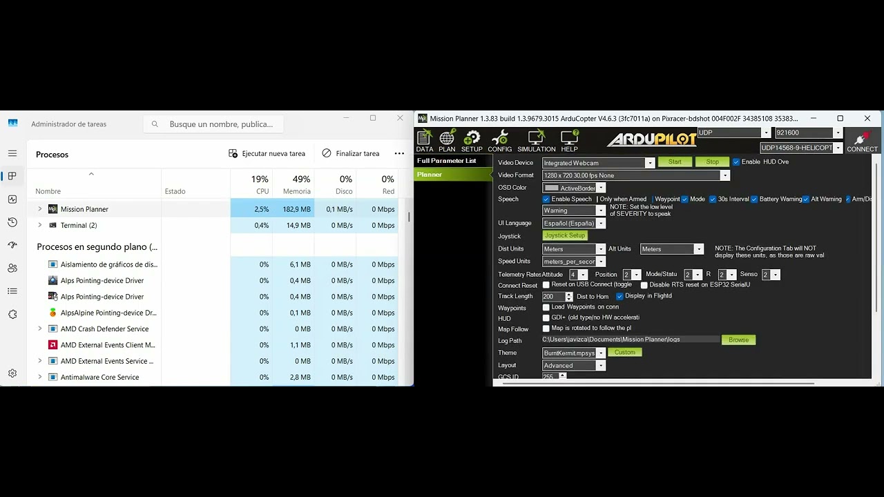

Hi.
On a particular laptop (i7: not old or slow) cleaned and upgraded the best I know, with MP upgraded to last beta, I’ve have always suffered slow parameters appearance on MP->CONFIG->Full Parameter List. The Youtube index should show the problem clearly on video:
What I know:
  • Connection to vehicle is fast and normal, but experiences the same delay: video shows button Load from file and option switching.
  • During the delay MP CPU load grows up to 90%, as can be seen on video.
  • First parameters load after executing MP takes around 30s to show parameters; reloading takes around 10s.
  • Downloading MP .zip and extracting files the same happens.
  • The laptop behaviour on other applications is normal.
  • To distinguish if it is a Windows problem, since the laptop has dual boot, I tried MP on Ubuntu with mono, but many errors appear.
Any help, workaround or anything to try?
Solved: no read access to Users on C:\ProgramData\Mission Planner\*.xml.
