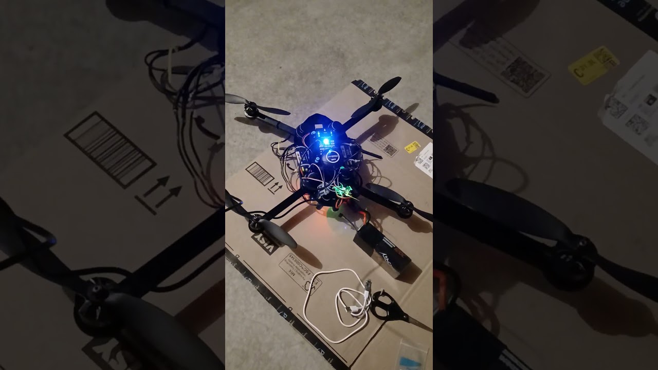

My name is King, and I’m currently building my first autonomous multirotor. I’ve been trying to get it flying, but I’ve run into an issue that I haven’t been able to solve despite a lot of troubleshooting.
The problem occurs during the Mission Planner Motor Test. With all motors selected, they will not continue spinning beyond:
  • 12% throttle for approximately 5 seconds with propellers fitted, or
  • 14% throttle for approximately 5 seconds without propellers.
After around 5 seconds, all four motors stop simultaneously, and the ESCs play their startup tones as though they have rebooted before reconnecting. The Pixhawk itself remains powered and does not reboot.

The main power rail is shown in this short unlisted video:
https://youtube.com/shorts/3A-KjVtys30?feature=share
Here is another video demonstrating the issue during the motor test:
At the moment, I suspect there may be a problem with the main power distribution, such as a voltage drop, intermittent power interruption, or another issue affecting the ESC power rail. To rule out software restrictions, I have already disabled the relevant Mission Planner safety settings (including BRD_SAFETYOPTION) that would otherwise prevent motor testing.

Thanks for the recommendation. I will look into an RC controller- the RadioMaster TX16S MK III does look pricey, might go for the RadioMaster Pocket as mentioned. As for the question before, the battery is 4S LiPo 8000mAh, and here are some photos of the setup:
Please also refer to this video for a walkthrough of the setup: https://youtube.com/shorts/3A-KjVtys30?feature=share
As I mentioned before, I suspect it could be a power related issue like voltage sag caused by poor solder joints or the battery itself. If you can have a look at some of these photos and offer some advice on how I can fix this issue, that would be much appreciated. Thanks for your recommendations once again!

The PMU position looks a bit unusual.
From the photo, it seems to be connected in this order:
Battery > Anti-Spark Connector > PDB > PMU
Or it also looks like the PMU might be installed in the wrong direction.
Could you please send a photo showing how the PMU is connected?

After rewatching your video, it sure seems like you have a power problem. I don’t know if you have a connection problem or a battery problem. You didn’t mention how old the battery was. Do you have a way to test the health of the battery? Many chargers can test capacity and also internal resistance.
Your soldering reminds me of my soldering when I first started soldering. I see multiple layers of solder on some of the joints (this is not good). The first photo shows one of the power connections coming uncomfortably close to the “S1” pad. Most of the power connection’s solder joints look sketchy to me. I believe your power distribution board was designed to be used with thinner wire. I’m pretty sure the wire being soldered to the board is supposed to fit inside of the provided holes. Power wires soldered only to one side of a PCB are usually provided with a solder pad at the edge of the PCB.. The pads/holes on your board are intended for through hole soldering. I also see a lot of solder on top of the solder mask. I know from painful experience that solder mask can’t be trusted to provide consistent insulation.
The connector adapter shown in your third photo could also be problem. I’ve certainly resorted to plug conversions myself but It’s generally best to use the fewest connectors in series as possible. If that were my setup, I’d replace the battery pack’s connector with a XT60.
I’d also suggest leaving the current sensing board out while testing. This would reduce connecters in series and make the system simpler for testing. Of course being able to monitor the current could be helpful in diagnosing your problem so you might just want leave the sensor out for a couple to tests just to eliminate it as the culprit.
Your setup looks kind of big for a 4S system. Is there a reason you didn’t go with 6S? There might not be anything wrong with using 4S on your quad. It just looks off to me. A 6S setup would let you use thinner wire with lower current while maintaining the same power delivery. Again, I’m not at all sure this is really an issue.
