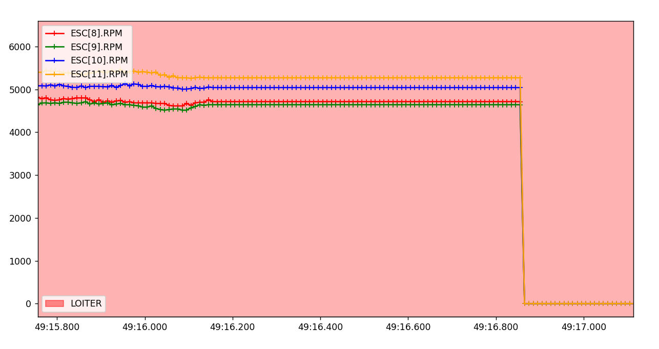

I’m going to go for ESC or some kind of power failure to the ESC.

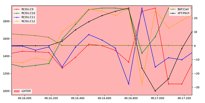

The overall current drops to nothing, while the command to the rear motors is going up, and the quad is pitching back (the command is correct for the pitch change, but there is no sign of response). The fact the current drops off says the ESC is off line.
The RPM data from the ESC also goes suspiciously flat at this point, also pointing to the ESC going off.

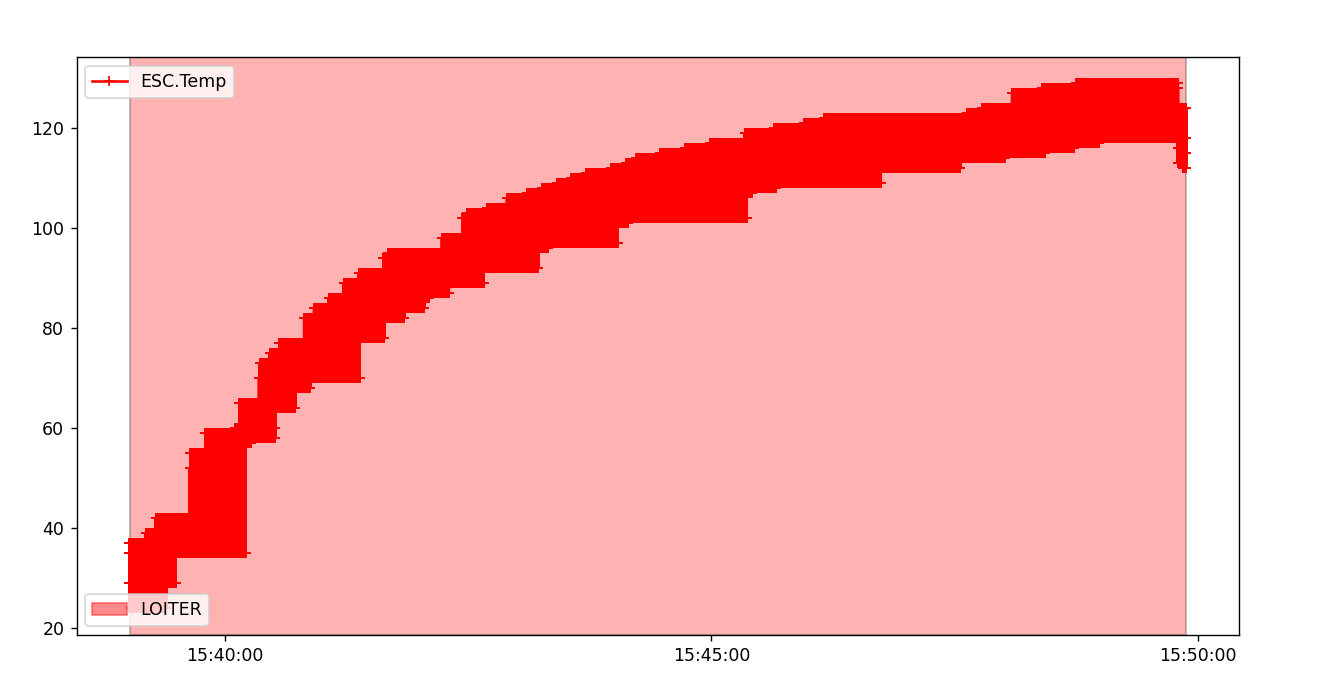

ESC Overheat - very probable, especially if ESC works fine after the incident.
Verify Settings of the Temperature protection. Possibly setup ESC temperature telemetry. If that is too complicated, fly for a few minutes and use your finger (on the ESC)…
I think you nailed it.
Edit: Better graph
A couple are pushing 130C.
This will heat-em up. It should look familiar.

I agree - it appears that the ESC shut down due to temperature.
I’ve built several other copters with this enclosed frame using other ESC’s, but haven’t ever had an issue. Maybe there’s a reason that this ESC has a big heatsink.

I have no experience with drones and ESCs like this. Is the behavior shown in your last picture completely normal, or are the motors being controlled back and forth too intensively? Could this be causing the overheating, or are you already reaching the limits of the ESCs with your drone hovering?
Yes indeed!
The last time you pointed out rcout oscillations for me it was because they needed to be reduced to get proper performance when enabling the rpm notch filter.
Last time I followed these instructions. I reduced the PID gains in half - and then a second time half again.
So today I just dropped the PID gains by 75% and performed a test hover flight. I landed after 2 minutes because the copter was so “mushy” I didn’t feel like I had proper control.
So then I re-loaded my original parameters and this time reduced the PID gains by 50% and performed an 8 minute hover flight. (it took a little over 10 minutes for the ESCs to quit last time)
The rcout chart looks about the same - and the temp comes up to about 120C again. When the ESC’s quit before the showed a max temperature of 128, 129, 124 and 118.

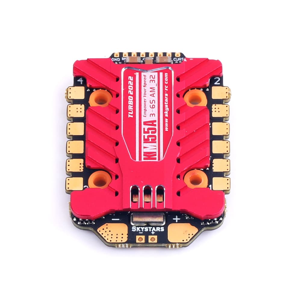

This unit from SkyStars is the only 20x20 ESC I’ve seen that comes with a heat sink. It seems maybe SkyStars knows there’s a problem.

Now, there is a remote possibility that the ESC heat shield is detached from the Mosfets. Since we know that your ESC had 130 C from the telemetry data, you have to measure the exterior of the ESC with a thermometer , if it is close to 110 C, that means heat is correctly dissipated.
Now, since you were flying for 10 minutes, I can guarantee you that your ESC would last for about 1…2 minutes if it had bad thermal contact with heat shield. So I doubt you have any problems with the ESC heat dissipation.

You make a good point about the thermal past on the Skystars heatsink - I’ll consider checking that in my options. But the fact that Skystarts includes a heatshink and it’s the only 20x20 ESC I recall using one - it’s suspicious.
