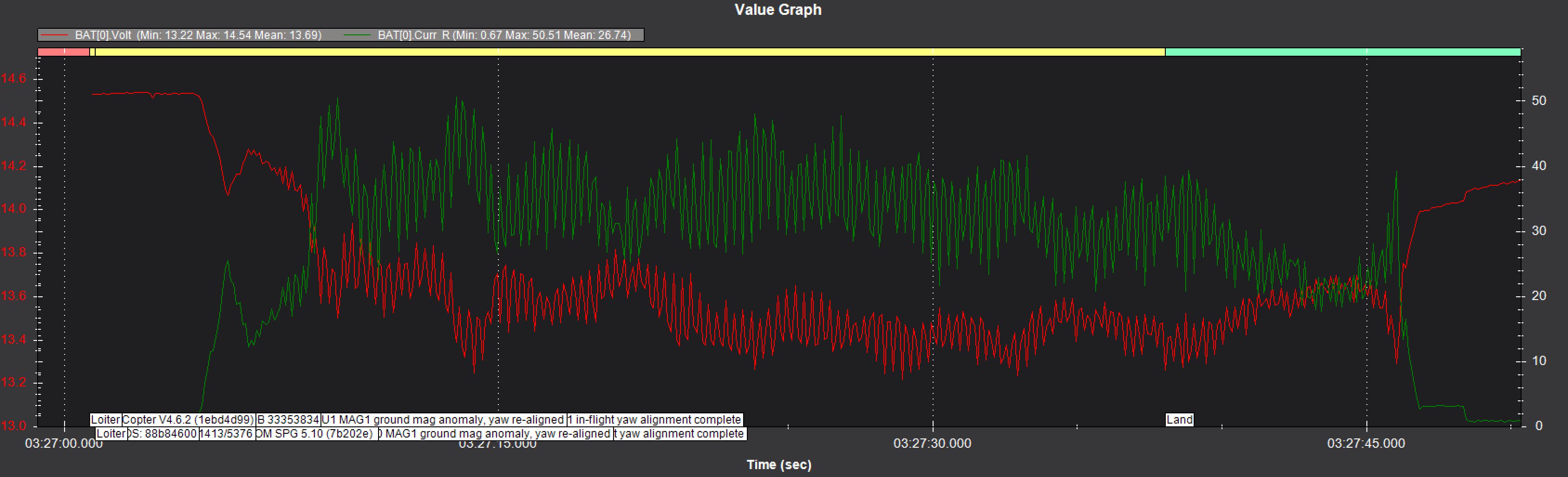

Hi!
I have a quadcopter:
  • Battery: 4s2p 4000mAh EVE 40PL
  • Motor: 2306 1750kv
  • Props: 5x3.1 inch
  • TOW: 1250g

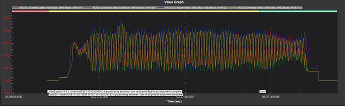

When I done a flight with fresh battery, everything seemed fine, I have seen no signs of oscillation. The weather was windy, but the drone was able to keep it’s position.

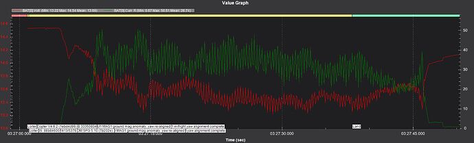

When the battery was well used (but above failsafe triggers) the motors were oscillating and the battery current was abnormally high due to constanty changing motor RPM.
Is there a parameter setting in the control loops to fix this behaviour of I just have to land and change battery? And increase failsafe voltage limit.
Are my motors/props mismatched to this TOW and this battery?

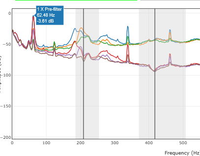

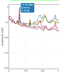

Check what vibrating on your quad at ~62 hz, it’s less with “full battery” by 25dB which still is huge.
Thanks for the suggestion! I haven’t thought about notch filter setting or physical vibration!
There’s a spike at about 325Hz. Shall I add a filter to auppress this spike?

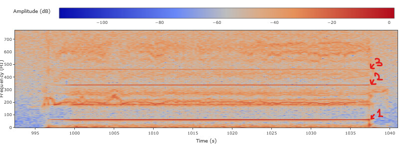

3 major vibrations are visible but only first is problematic, others attenuated enough by LPF.

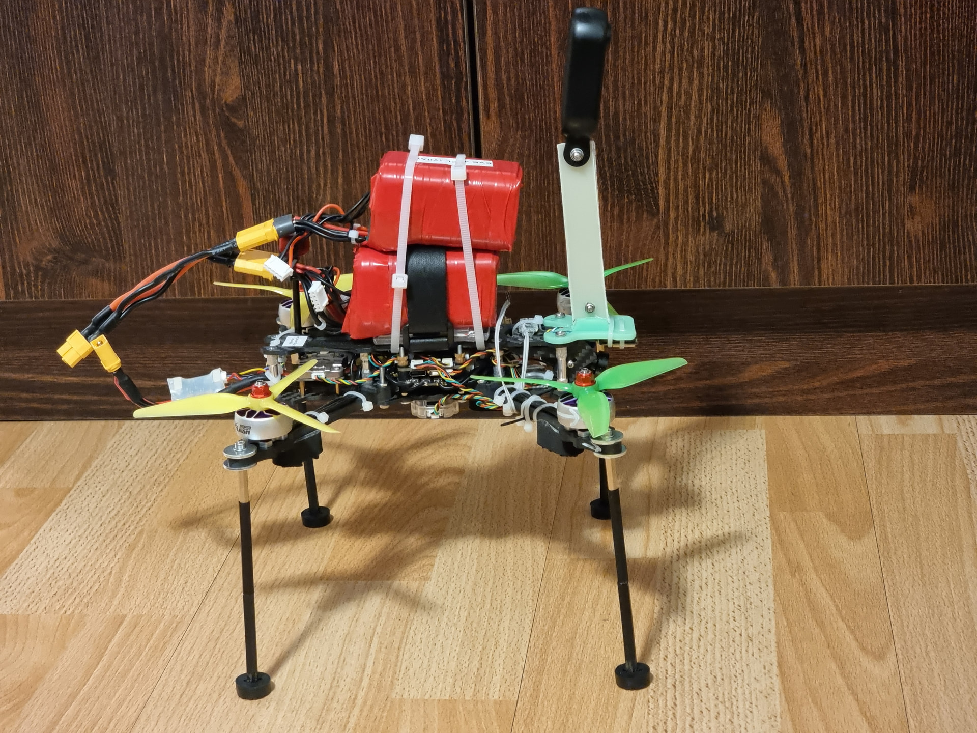

I think the source is either those legs either that small action camera at the front of the device.
Those legs are to provide space for a camera under the drone. The action camera is raised to that height because there’s a magnet inside the camera and that magnet disturbs the compass.
I will remove them and make a test flight. In 2026 :smiley:
More likely the vibration is a result not a cause. Perhaps it’s battery voltage compensation. Use the max and min values for Li-ion batteries, that’s not what you have. If that doesn’t improve the situation then PID’s will have to be addressed. IOW, it’s not a vibration issue.
From the low battery flight. Not seen on full charge:
Thought maybe it was discharge cutoff but that’s 2.5V for those cells.
Is current calibrated? I suppose not.

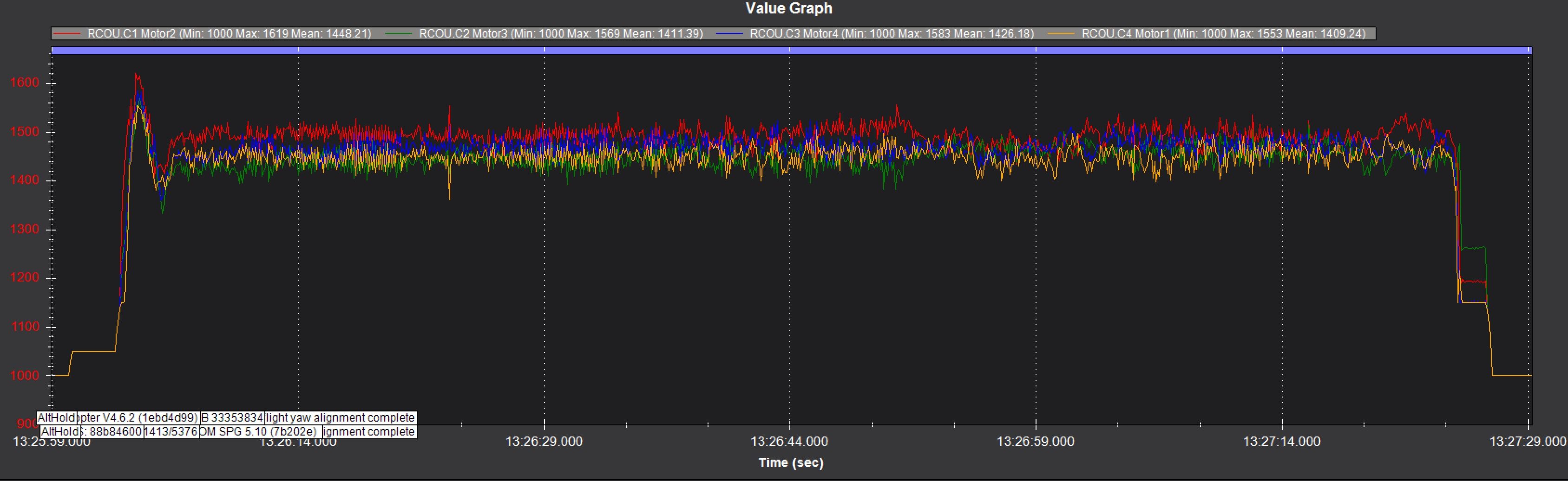

  2. The black part of landing gear (a few plastic standoffs :smiley: ) were unscrewed: https://drive.google.com/file/d/1ik0vzTNz_utor4PXMt375rP6MyWleAzN/view?usp=sharing
    Oscillation disappeared, battery current was about 14-16A. I think everything is normal in this case.

By removing the landing gear (which is a big but lightweight component on the end of arms) the oscillation seems to be solved, but the question: I need some landing gear because I would like to mound a small camera under the drone.
How to start, what direction:
Use a more rigid material (carbon fiber tube?) for landing gear?
Mount landing gear closer to the center-of-gravity of the drone?
Or am I at a completely wrong direction? :slight_smile:

It does not looks like the leg is a root cause of vibration but it changes amplitude and freq
With legs -2db @ 62hz
Without legs -27db @ 58hz
So 25db difference is like ~17 times stronger signal amplitude.
-27db can be tried to filter with static notch, but -2db is too strong.
Now check if removing a camera helps.

This applies ot the 3rd flight which I’m looking at. How are you concluding it’s oscillating? Seeing it, hearing it, from log review?
This looks like it could be D-term oscillation which we can address but need to know what you are describing.
Yes, I can hear it.
The motors were not emitting a constant frequency during hovering. It sounded, something similar to this one, at the first 10 seconds, where the operator pushes heavy throttle:
