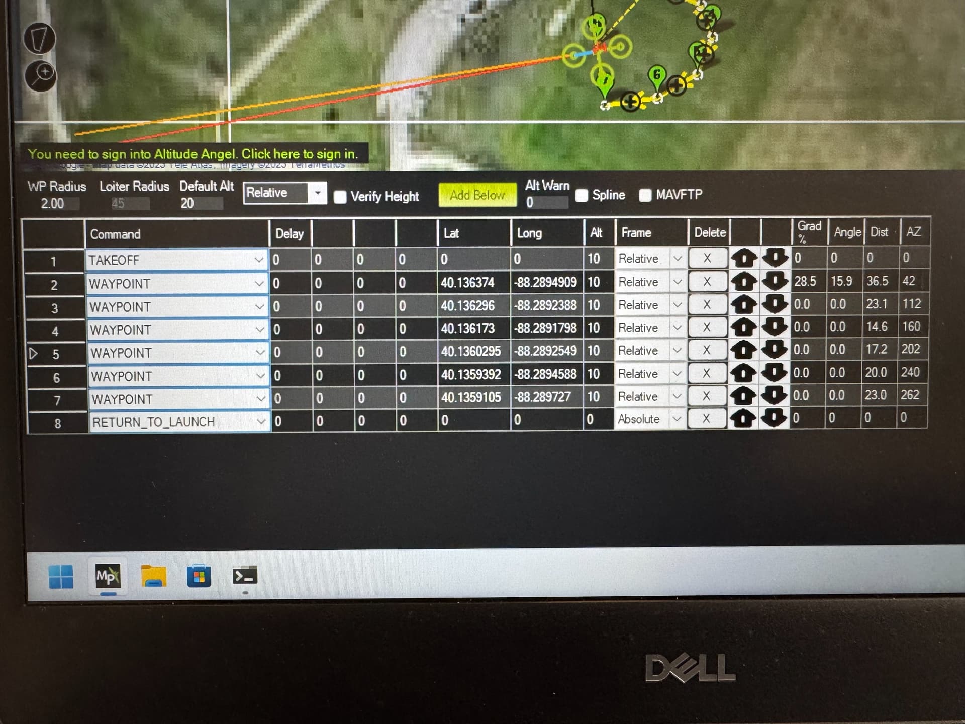

Our team is new to ardupilot but we’ve had a couple of successful flights where we have taken off using the data tab, made the quadcopter fly to waypoints and then clicked on RTL which made the drone return to the lauch position and land. Today, for the first time ever, we tried to use the plan tab to create a mission for the drone, uploaded it, and the drone excetude the whole mission perfectly and returned to the launch position but suddenly killed the motors while it was 15 meters high. We are unsure as to why this happened. Any suggestion would help. Here are the pictures of the mission setup, and the RTL parameters. We are running ardupilot V4.5.7

Thanks for the suggestions! I will look into setting up a battery monitor soon. I was wondering if the mission plan setup was fine? Because from what I read after the crash, the RTL command doesn’t make the drone land. Instead, it goes back to the coordinates of the launch location and then terminates the mission after a certain time. I was wondering if our drone crashed since it did not have any land command in the mission plan.

No it doesn’t it Lands by default. There is an RTL_ALT_FINAL parameter that is default 0, meaning it will Land. You had a power loss.

In the video (and in the log) the copter falls before it has reached the RTL point. Like Dave says your mission RTL entry is correct and RTL will land anyway.
Even if you had set RTL to hover (Loiter) at some altitude a correctly configured battery monitor would allow the copter to land when the battery depleted anyway.
