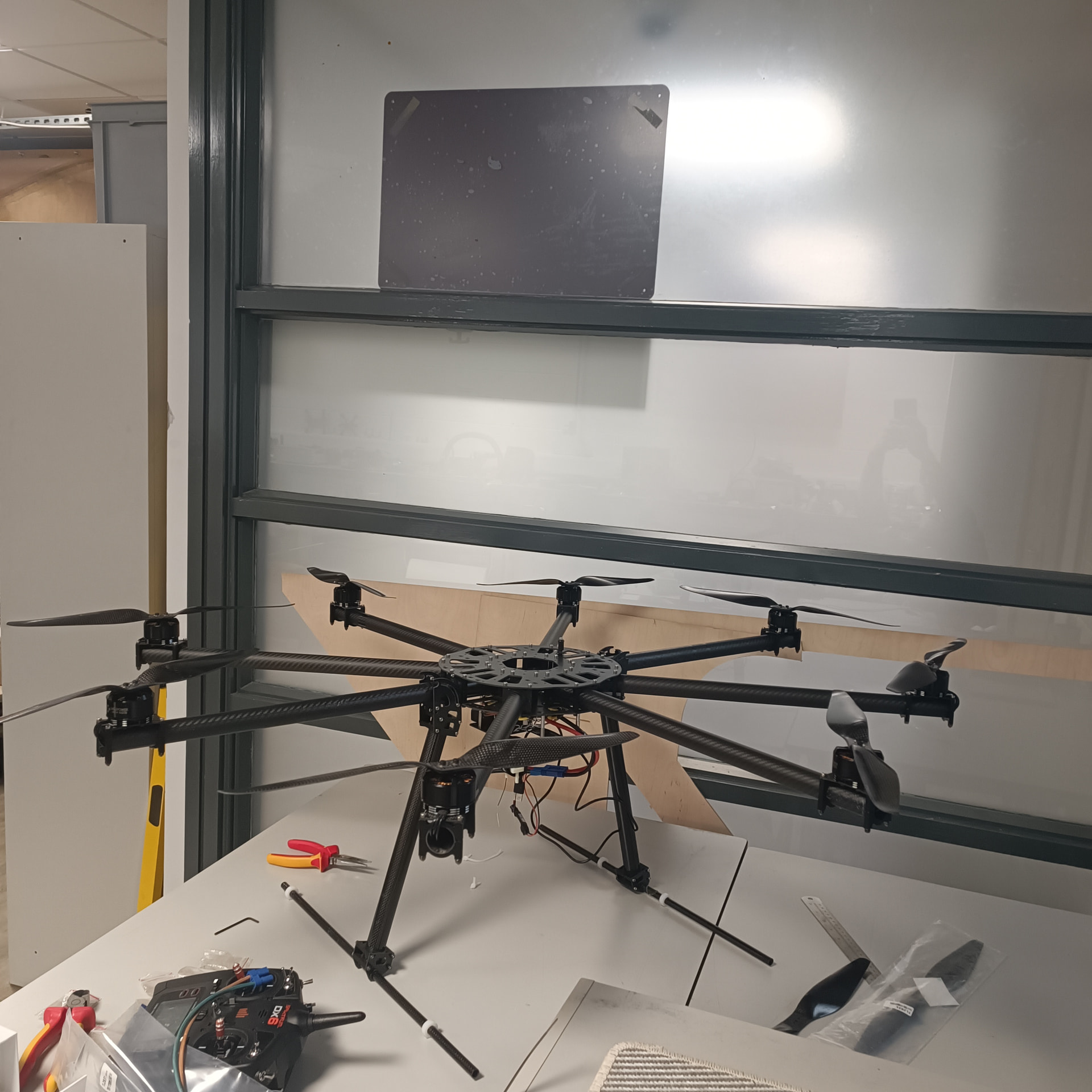

I am working with an octocopter. My issue is :
  • At 0 throttle 1 motor spins slowly
  • Increasing throttle makes other motors spin but 1 motor stops unless I move yaw and pitch stick in a certain direction but depending on pitch and yaw 1 motor stops and starts.
  • I’ve done accelerometer, ESC, compass and Radio calibration but nothing has worked.
  • There’s suspicion that it maybe instability due to when I tested the motors together first time, the propellers weren’t on and that confused the flight controller.
I’m curious if anyone has encountered this themselves and if there is a possible fix for this.
It’s irrelevant testing on the bench with the transmitter so those results are expected. Use Mission Planners Motor Test function to test motors.
That some motors stop completely is possibly concerning, despite the invalid test methodology. See the following articles:

Is this related to the EKF expecting the copter to tilt/move according to the inputs but it actually doesn’t?
I also have some sort of issue related to motors where I can go to the full RPM of something like 11200 using motor test but when I put my RC throttle to 100%, the max RPM the motors reach is about 7400. Don’t know if this will happen in flight. Broke a prop and waiting for a new one :grin:
Yes. It’s probably the most reported non-issue on the forum. It’s the gift that never stops giving. Many new users just don’t get it which is somewhat understandable.

Open loop means that change in motor RPM doesn’t cause craft to change its attitude, attitude rate, acceleration etc.
It generally isn’t representative of control loop response in flight.
IMHO it can be used to test some things if you understand what you are doing. Namely that FC orientation matches expectation (though that can be more easily checked by looking at MP HUD)and that RC sticks cause response in the correct direction ex. pushing pitch forward causes aft motor(s) to spin up relative to front ones. But nothing else especially regarding control performance.
