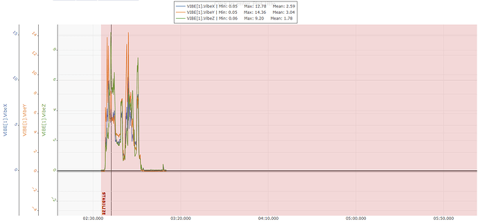

I have been experiencing some issues with my quadcopter:

The esc’s however still beep 5 times and i can still fly the drone but twitching occurs while flying. It seems like the drone becomes unstable for a second and the regains stability again. See the provided .bin file for further details. 00000082.BIN - Google Drive
Currently I’m following the methodic configurator and i stranded on the VTOL quicktune step 22, I didn’t want to do this yet because I need to resolve the twitching first.

Here are the vibex , vibey and vibez results on uav log viewer:

That is a nice .param file, but what we need is a zip file with all the files in the vehicle configuration directory.
Okay here is the complete zip of the copters directory https://drive.google.com/file/d/1YU4jU2YHbVOwA_T9cx_ZO7Gin0pOKLO3/view?usp=drive_link
That link is protected.
This one should be fine, sorry for the inconvenience. APM.zip - Google Drive
No, the vehicle configuration directory created by the ardupilot methodic configurator software.
This directory:
The one where all the .param files are and the vehicle_components.json file is.
BTW this procedure is described here
Holybro_X500_V2.zip (399.7 KB)

You did a good job in the components editor window. Most parameters are correctly set. But you did miss a lot of “reason changed” fields.
Yeah sure go ahead, you have permission.
I will take a further look to give a reason for the parameters.
Wait for the template to get published in a new release before doing that.
Okay I will thank you so much in advance already!!
Try the latest development release, not the stable release.
It contains your template with corrections.
