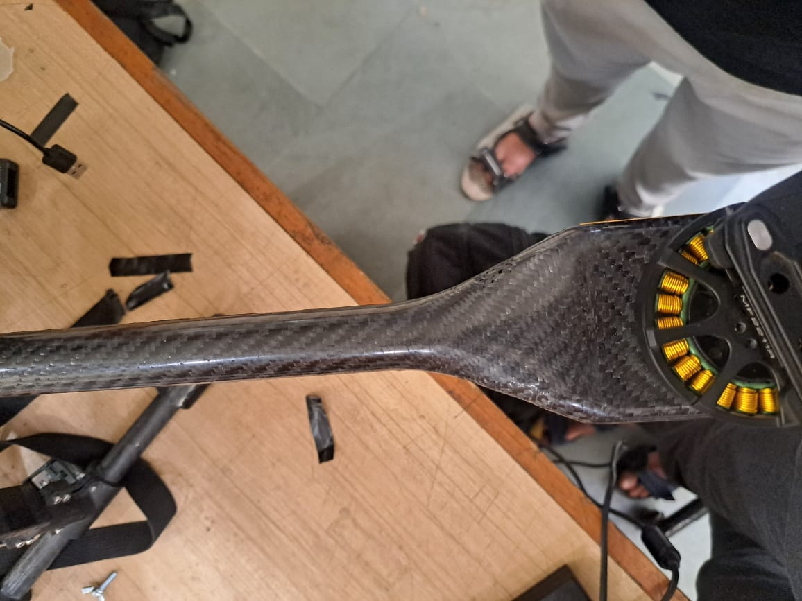

Hello there i am using Pixhawk cube orange+ with mini carrier board. 27000 mAH solid state battery with t motor custom motor similar to mn6007s with 22.4*8 inch mf2211 t motor propeller with flame 70a esc. All up weight of drone is near 7.5 kgs and having wheel base of 990 mm.
I have configured notch frequency correctly by analyzing graphs. But after that i am stuck at tuning part.
  1. I have started autotuning at base PIDs but i am not confident about performance of drone. It seems to jerky for me.
  2. Than i have manually set PIDs by log analysis to really really lower values just to make sure next autotune as good as possible. It successfully worked but my PIDs are too low also below default values and output was really too bad.
  3. Than from stock values i have started manually tuning my drone and it really helped a lot like i am attaching log file here.

ATC_ANG_PIT/RLL_P gain looks way too low to me.

Some of those Antigravity motors are a bit low on torque or sensitive making them difficult to tune, and poor in wind. Just keep that in mind.
There’s some frame or motor mount twist - be sure to fix that before anything else.

we have molded rods balanced with spirit level so i guess it’s not an issue

Anyway, make all those other changes, being sure to get all the motors exactly level, because I believe it is actually an issue - just check your motor outputs.

i am aware with 2 motors running high and 2 motors running low but it’s maybe yaw imbalance tuning drone can eliminate that i guess …
It looks like yaw imbalance to me, and that’s caused by twisted motor mounts, unless you made a rookie error and put very different pitch props on CW and CCW motors (unlikely :slight_smile: )
