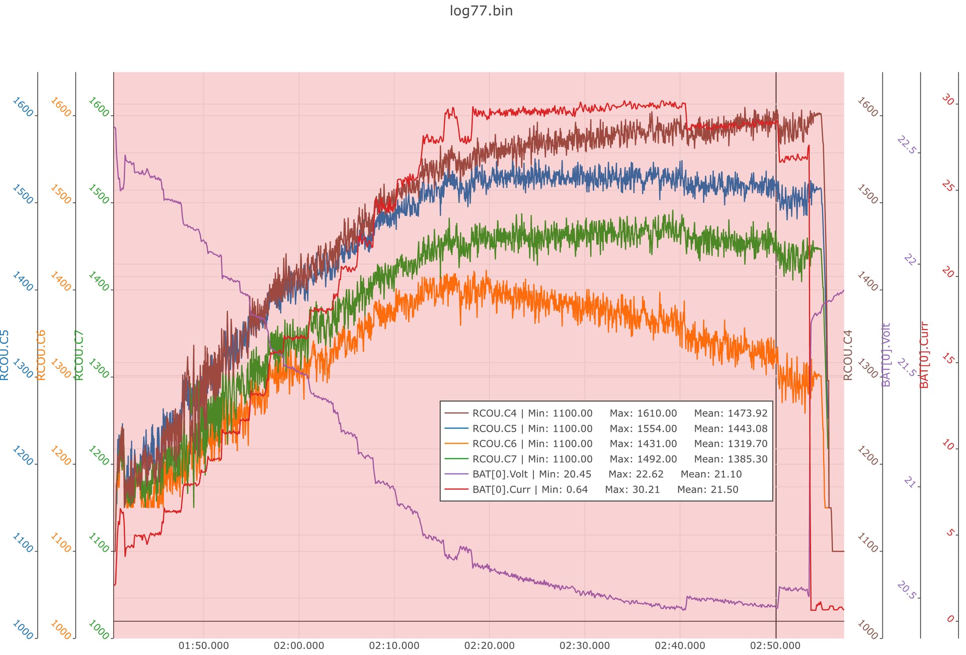

I’m getting sudden mid-air power loss on my VTOL in QLoiter. Motors stop and it falls on its nose. Has happened twice with virtually the same logs.
After 60-75s of hover (~27–30A total), all lift motors stop within 0.2 seconds. FC stays on and logs data, no error messages. Lifting motor RCOUs jump up as current drops, so FC tries to keep flying.

Log from incident:
I was able to replicate the current cliff with about 40 seconds of 27A+ tied down load testing.

Overheat. It’s probably the temperature cut-off, or something in the ESC is cooked.
It looks more and more like the ESC is the issue. Swapping esc signal wires and corresponding servox_function still caused the cutoff.
Will replace and hope that solves it. Thanks for your help!
