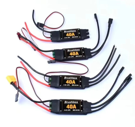

motor 4 wont spin until im on 20% (motor test) , and the same happen after arming , tried esc calibration and using difrrent motor and esc.

With those ESCs, it is not surprising to see them turn on soo high.
Try using some other testing source, like arduino (with pulse value display). like this would work https://robu.in/product/digital-servo-tester-esc-consistency-tester/?gad_source=1&gad_campaignid=20381096599&gbraid=0AAAAADvLFWcpiWDqxIH14rVfS04qJMtI0&gclid=CjwKCAiAnoXNBhAZEiwAnItcGwVoK2EbqptA8_qUHo--9LpKdhzxE_ubHSR-PBIDBsBNoODhZZqEqhoCMLEQAvD_BwE
if it turns on only at 1200us, then its issue of esc

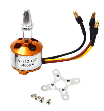

You should also consider replacing these motors, they have collet prop adapter, which give a lot of vibration - not good for flight.

Replace the defective ESC.
You have very low quality components.

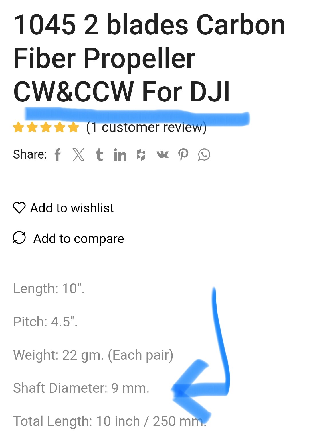

I used Balanced Carbon Fibre 1045 props, BUT remember to check whether the Props you buy have a label of “DJI type” in them. Basically, that propeller’s hub’s hole diameter should be 8mm or more, otherwise they will not fit into the motor’s shaft!

So yes, if at other place, then prefer the one which satisfies. But just note that you are never using that collet type (I used those collet type A2212 1000KV too once and my drone was vibrating like a wave generator!
Well with some smart brains, I decided to use 1400kv A2212 with 11 inch props. not only wave generator, it was heater too.

The collet types were made for planes, that too early times, never for copters.
