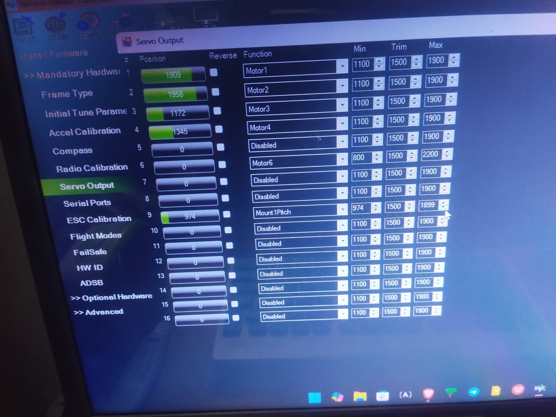

Motor 3,4 spinning less than motor 1,2
is all motors spin in same speed , in the servo output in mission planner motor 3 and 4 are spinning less compared to motor 1,2 no matter what channel it is and I’m using f450 frame

This is meaningless. Use Mission Planners Motor Test function to test motors.

can you explain why motor 3,4 are not getting same as 1,2 irrespective of the channels if i assign motor 3 for channel 1 it’s behaving the same
There is no problem. Are you testing on the bench with the Transmitter?

Did you run the Motor Test in Mission Planner to determine if the motor order and direction are correct?
In any case start over from here Methodic Configurator

I mean motor 3 and 4 output is low when full throttle is given it goes to max and within seconds it decreases and stays wher it’s shown in the image

Only the motor test counts. Arming the drone and running the motors on the bench is fun, but it doesn’t tell you much because the control loop is confused. It is adjusting the speed of the motors to get the drone to a specific attitude, either because it’s not sitting 100% flat on the bench or you’re moving it, or you’ve given a stick input. (P-term). Because the drone isn’t getting the reaction it expected it keeps upping the correction (I-term). At this point it’s almost impossible to figure out what it’s going to do. As long as the motor test works as expected, then don’t worry about arming on the bench. I know it’s fun to hear the motors zoom as you move it around, we’ve all done it, but it’s not telling you anything that the motor test won’t properly quantify.

done motor test and everything is perfect
Use the Ardupilot methodic configurator software like we told you to do. And complete steps 4 to 18 before doing the first flight.
