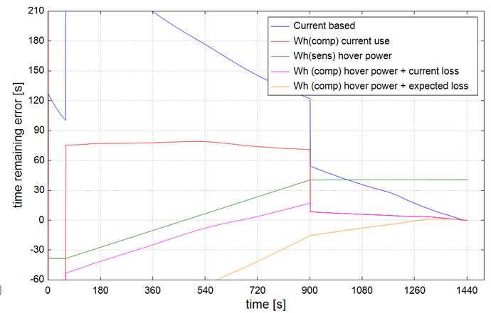

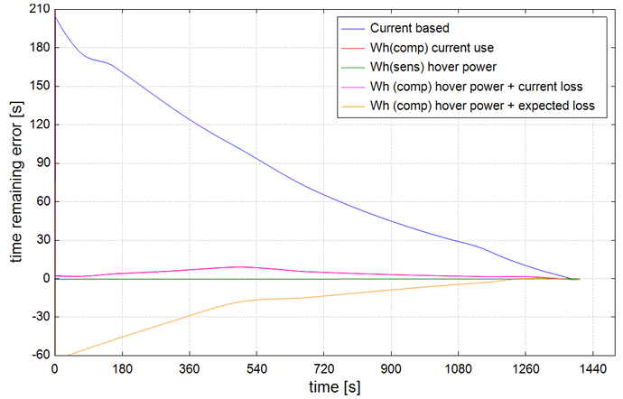

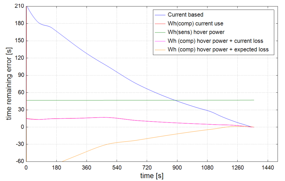

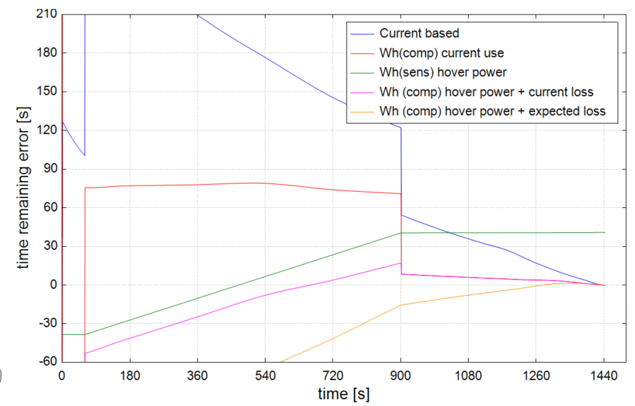

I played a bit with the idea writing a simulation of my helicopter’s battery.
I tested two estimates of Wh used, “at current sensor” (for now I assuemed negligible losses behind the sensor) and “at voltage source” (sag compensated). Both are subject to inaccurate capacity estimate. The issue is made bigger by the fact that unlike capacity in Ah, Wh isn’t provided by the charger and even if it was it would need to account for charging lossses.
The other source of inaccuracy is prediction of power consumption/losses. Wh at sensor is very accurate if power consumption and exact capacity after losses is known, however if internal resistance changes the prediction becomes inaccurate (in my model it is ~constant 24s for 1385s flight which is 1.7% overestimation at ~25% increase in internal resistance and ~6.4% at ~100% resistance increase. The big issue is that it does not converge to 0 on depletion.
The other option is counting Wh at voltage source, this method is resistant to changes in battery’s internal resistance but makes predicting power draw harder, as losses varry a bit with voltage (due to internal resistance changes).
Ideal case (fresh calibration)
Increased resistance from 0,15 to 0,25 for most of the hover
Dynamic flight (decreased power 32W → 29W during 60 - 900s)
Wh (comp) - energy consumed was calculated at ideal source terminals
Wh (sens) - energy consumed was calculated at power monitor
current loss is current at measurement time squared times battery resistance
expected loss is expected current at minV squared times battery resistance
Additional simulations indicate that using harmonic mean of current loss and loss at V_min should provide pretty good, slightly conservative estimate of hover time remaining.
Next I will test with data from a real flight.
