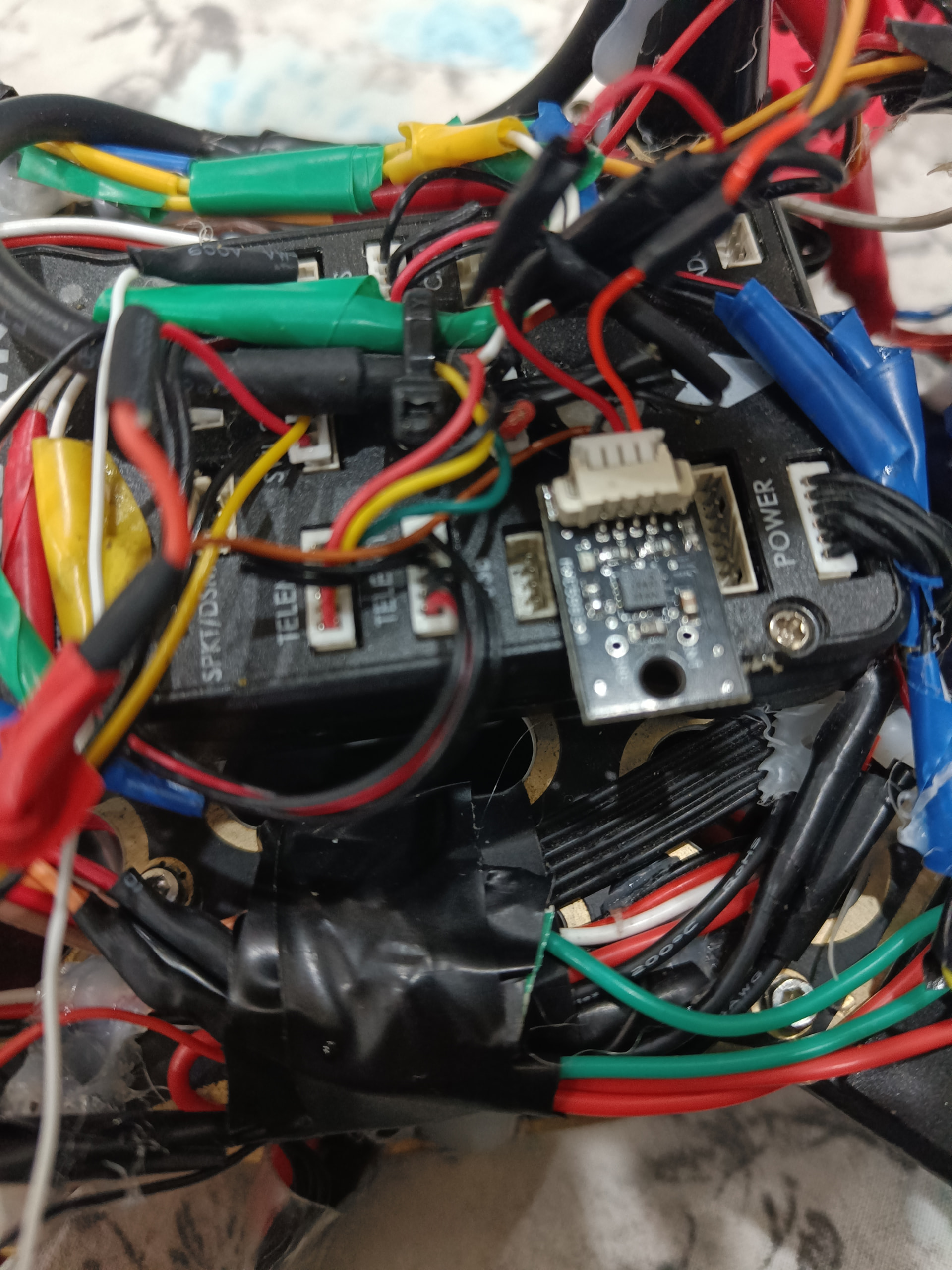

I am trying to use a external compass with arducopter but it is not getting detected.
This compass is connected to the i2c bus of the pixhawk 2.4.8
This is the third compass on the vehicle, and the second compass is connected to the same i2c bus.
Both sensors have their sda and scl connected in parallel.
The compass is mmc5983ma on a breakout board. This board is getting power and led turns on.
I have flashed a custom build including this compass model (mmc5xx3) for copter 4.6.3
It doesn’t appear in the hw id tab and neither in the compass tab.
Please help
Thank you
Have you checked that both devices have different addresses?
Thank you for your response
Both devices have different addresses.
The hmc5883 compass has decimal 30 address, and still works.
The mmc5983ma has hex 0x30 which is decimal 48
This is further verified by the hmc5883 still working and getting detected normally
I have also tested swapping the sda and scl of the compass module, but it did not work.
Can it be related to not using an i2c splitter?
Pull-up resistors are present in the pixhawk and on the sensor module (likely) so it shouldn’t be an problem

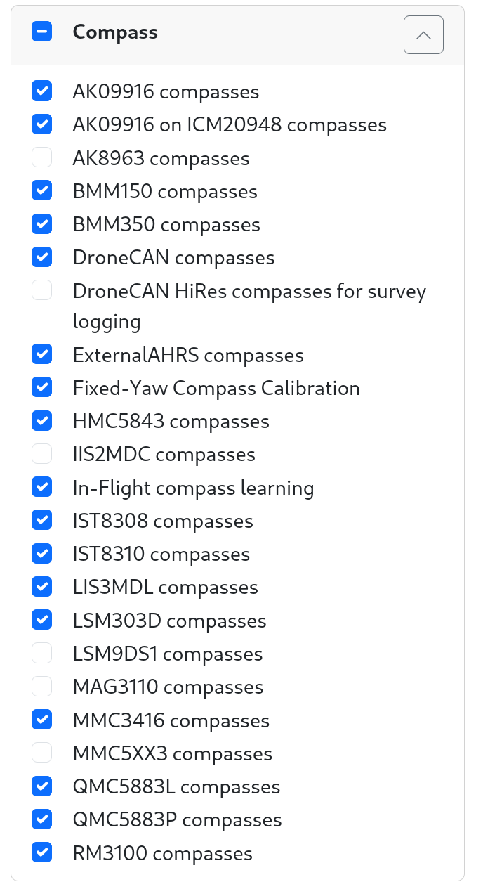

I took some help from ai and in the hwdef of pixhawk1 it says probe for two mags and there isn’t and definition for the mmc5983ma compass. According to ChatGPT, this means that the driver won’t be compiled into the firmware. I don’t know if this is true but if this is true then how do I fix it?
What value do you have in COMPASS_DISBLMSK ?
This shows the compasses available in the default Pixhawk build:
I added the MMC5xx3 compasses and produced a new build. Download your new firmware from this link:
If you need any other options like bdshot or other drivers, you’ll have to learn how to use the custom firmware builder. It’s incredibly easy.

I have already used the custom firmware builder. I added the mmc compass. Built the firmware yesterday and flashed it to the pixhawk
I used pixhawk1 board and added ibus telem which I also needed.
I disabled many other not needed compass models using the compass disable mask in params, but did not disable mmc5xx3 and the other mmc3 series and ist8310 and ist8308 and HMC qmc family compasses

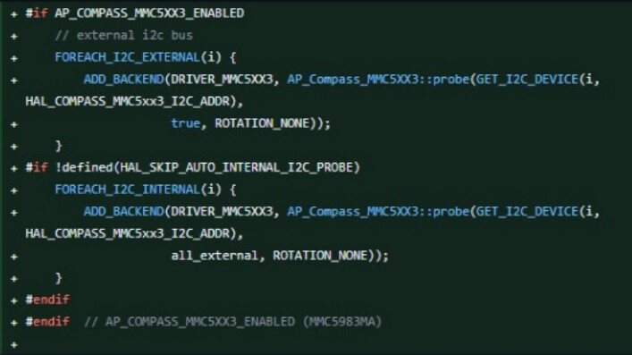

I tried to compile and I was on last step - ./waf copter
Unfortunately it gave compilation error regarding ADD_BACKEND
With my little knowledge, I thought it should be changed to add backend in lowercase as that was visible everywhere else
However, chatgpt suggested adding this snippet on top:
#ifndef ADD_BACKEND
#define ADD_BACKEND(driver, backend) add_backend(driver, backend)
#endif
There is no need to do the above changes in copter 4.6.3 and the snipped given by @Nischith_Raj has to be added in compass.cpp
However, in 4.7.0 dev version the above snipped also needs to be added
The compass is getting detected now!
