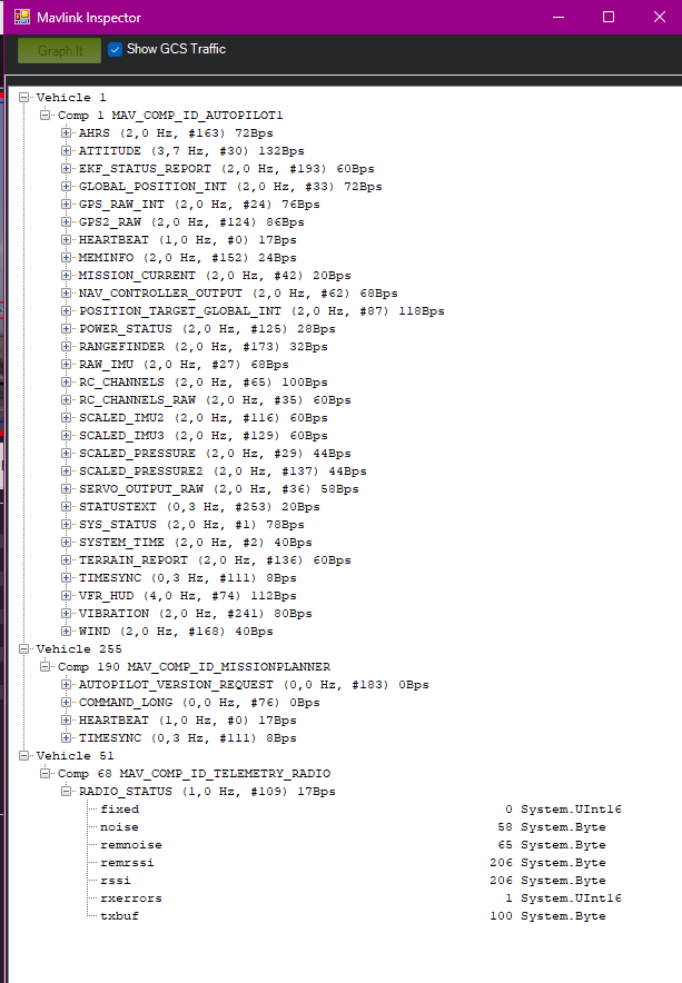

Mission Planner gets stuck at “Getting Params” over TELEM1 telemetry, but USB works normally
I’m having an issue with Mission Planner over telemetry.
Setup:
FC: Cube Orange Plus
Module: RFD 868x                                                               Port: TELEM1
GCS: Mission Planner
Baud: 57600
SERIAL1_PROTOCOL = 1 (Tried 2, nothing changed)
SERIAL1_BAUD = 57
SERIAL1_OPTIONS = 0
Mission Planner connects over telemetry and I can see live HUD/attitude data, but it gets stuck at “Getting Params” and never finishes downloading parameters.
USB connection works normally and parameters download quickly.
This issue started suddenly; telemetry parameter download was working earlier during testing.
What would be the best way to solve this?
Thanks.
Check SR1_PARAMS. Try setting it at something like 20 or 30. (reboot required to test) If it keeps changing look at your Mission Planner settings for the telemetry rates.
