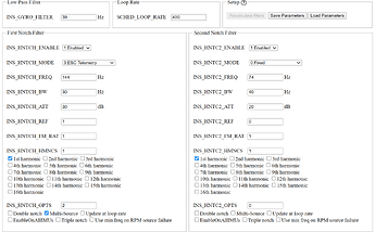

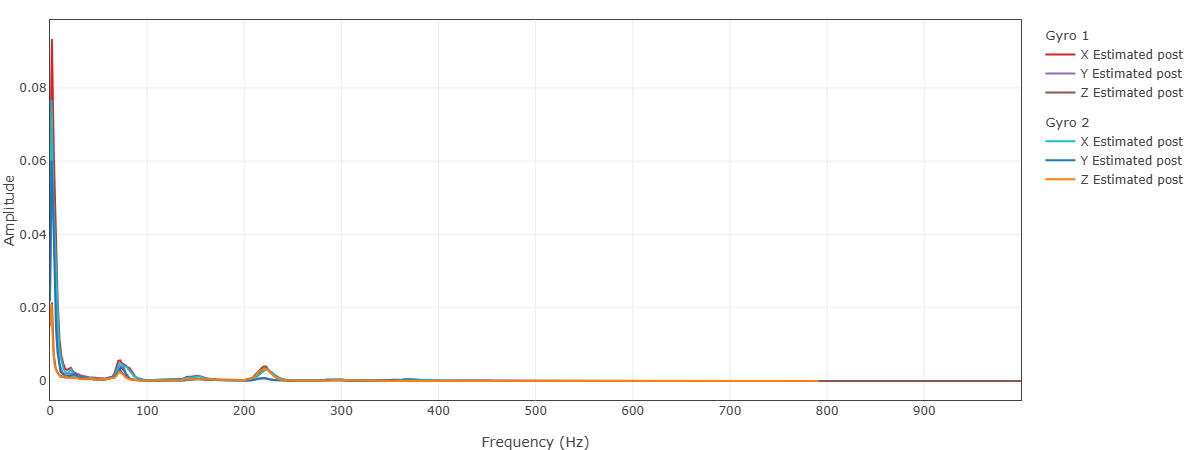

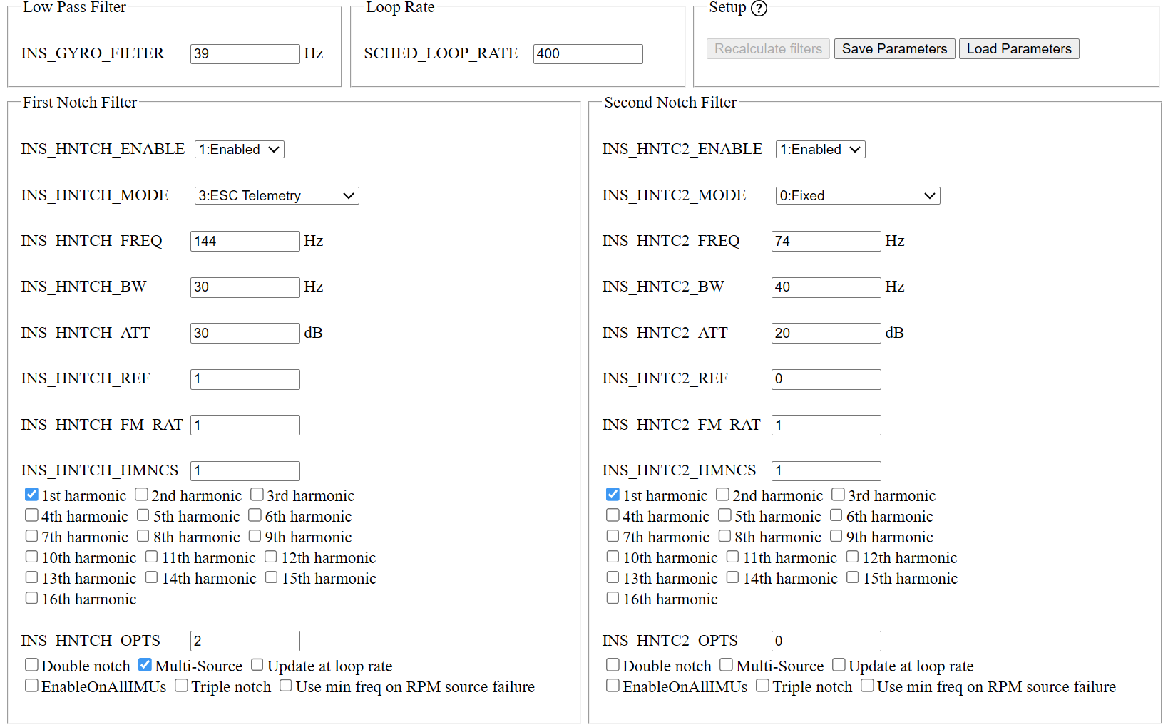

I am working on another drone with the following configurations. The team is working to improve the FCU mounting to reduce vibrations. The propellers are well-balanced. As for the Harmonic Notch filter, have I set it correctly? However, I was unable to suppress the 1.95Hz noise.
MicoAir743v2-AIO-45A, 4.6.3 bdshot firmware. flight log.
INS_GYRO_FILTER,39
INS_HNTCH_FREQ,144
INS_HNTCH_BW,30
INS_HNTCH_ATT,30
INS_HNTCH_REF,1
INS_HNTCH_FM_RAT,1
INS_HNTCH_HMNCS,1
INS_HNTCH_OPTS,2
INS_HNTC2_FREQ,74
INS_HNTC2_BW,40
INS_HNTC2_ATT,20
INS_HNTC2_REF,0
INS_HNTC2_FM_RAT,1
INS_HNTC2_HMNCS,1
INS_HNTC2_OPTS,0
INS_HNTCH_ENABLE,1
INS_HNTCH_MODE,3
INS_HNTC2_ENABLE,1
INS_HNTC2_MODE,0
Of course not. You don’t suppress rigid body modes. Use your favorite LLM for a definition if you don’t know what that is.
