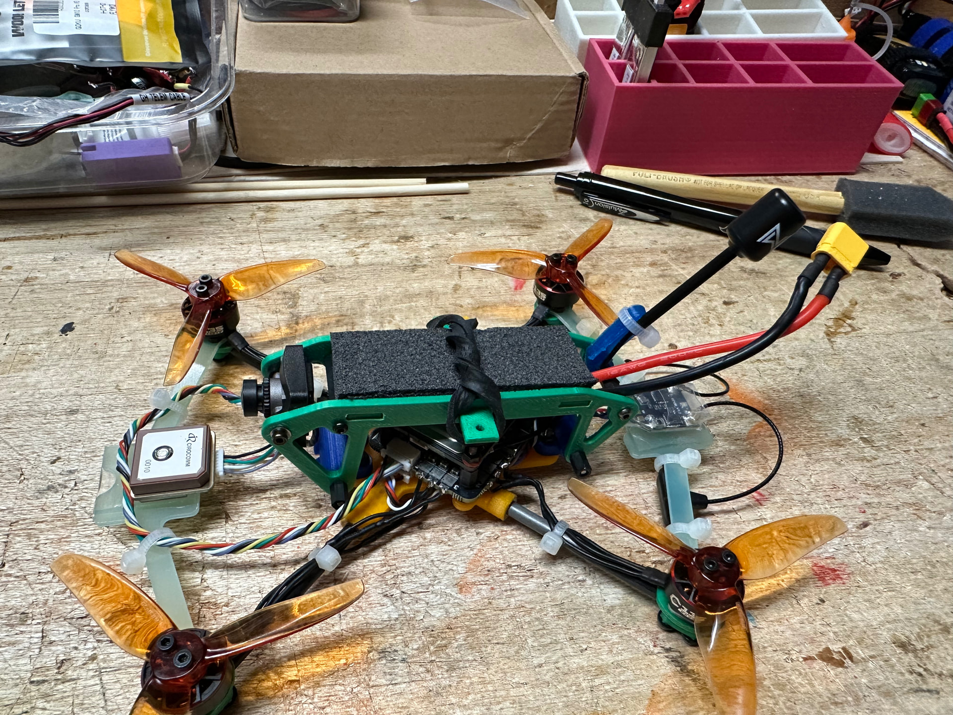

  2. I original purchased a Mico Air H743 AIO directly from Mico Air (FC version 1.1) I encountered issues. So I bought the Mico Air H743 AIO Version 2 and am encountering the same issues.
  3. I set it up with Ardupilot and can fly it without video just fine. I can fly it in stab mode. I can fly it in loiter mode. I can navigate a preset number of waypoints. I can have the machine come home when I hit RTL.
  4. I wanted to add a VTX and camera to see where I am going. Since this FC does not have an onboard OSD chip (my understanding only.) I have decided to use a Walksnail 1S VTX V3. The VTX is plugged into the UART port meant for a DJI VTX using 4 wires. I get video image and OSD data on the goggles no problem. However I lost the ability to lock on to the GPS and cannot switch to loiter mode without an error message. I was getting GPS glitch messages and cannot establish position messages.

I have quad with micoair h743 aio 45A with walksnail 1s and it works just fine. perhaps You have vtx antennas too close to gps. This is a common problem with getting fix and related not only to walksmail itself.

Thank you for your confirmation that your setup works. I will try another VTX in my case. In the meantime my VTX antenna and the GPS module are at two extreme ends of the quad. So they are about as far apart as physically possible. I would love to power up the FC before the VTX. I will try using the USB port as power first.
Just to be sure… You have trouble getting gps fix inside?
I would also try to use shorter cable for GPS module, and perhaps shield it. Not sure how much improvement shielding gives You but I’ve heard that this helps.

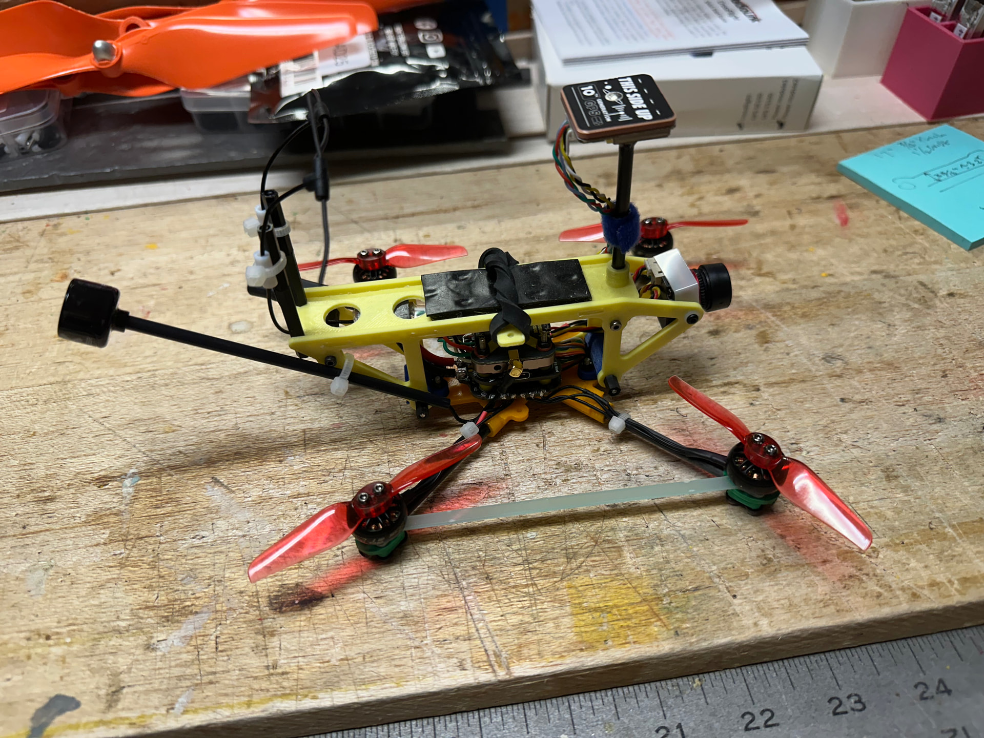

I am using various lithium polymer packs. Almost good news. I swapped out the Walksnail 1S VTX with another one I have on another quad. I just had two flights without any issue so far. Knock on wood. I will continue to test before I am more comfortable. It may very well has something to do with certain Walksnail VTX. Everything is the same except for the different VTX. Go figure! I will report back as I fly more.
Gentlemen, I like to express my gratitude for your help. I believe I may have solved the issue by swapping the Walksnail 1S VTX. I have no idea when one VTX can create such issues but I just tested 4 more flights. Very uneventful.

looking to your mechanical antenna setup i have a small remark.
Such GPS antennas have best receive pattern from above and reduced to angles to the side greater than 90°. In your case the antenna is sitting below the I think vtx Antenna on the right and also below the video camera itself . So it is getting all noise from these systems. Best position for GPS systems is the highest point on a mast above all other electronic and electric systems
Yes thank you. I know what you are talking about and agree. To a point. I do have many other multicopters with the GPS modules as the highest point on the quad. However with this build I mounted the module in front for convenience. As I mentioned the module location did not contribute to my issues. It was the Walksnail VTX.

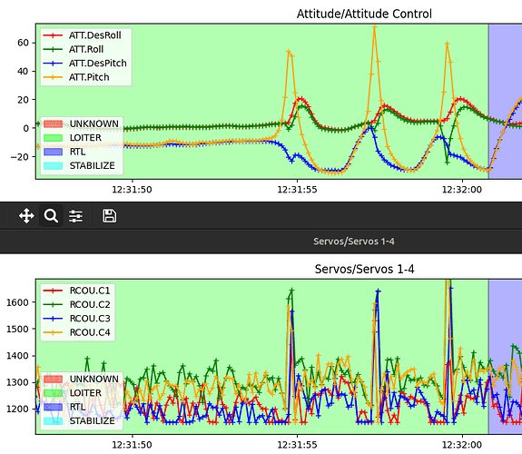

This time I am testing a Mico Air H743 V2 AIO with 45 amp speed controllers. Walksnail 1S VTX with nano camera. ExpressLRS transmitter and receiver. Many successful flights until today. I was coming back from a short loiter cruise. Nice calm and sunny day. When the quad almost reached home it suddenly reared up at random three times. I click RTL right away and the quad settled into a landing at home point. No other issues. I continued the flight for the rest of the battery pack and it was nice and smooth.
I am just curious what could have cause such a glitch.
I am using Ardupilot firmware version 4.6.2 as came from the factory. Is it a software glitch?
The issue started at :41 seconds into the video.

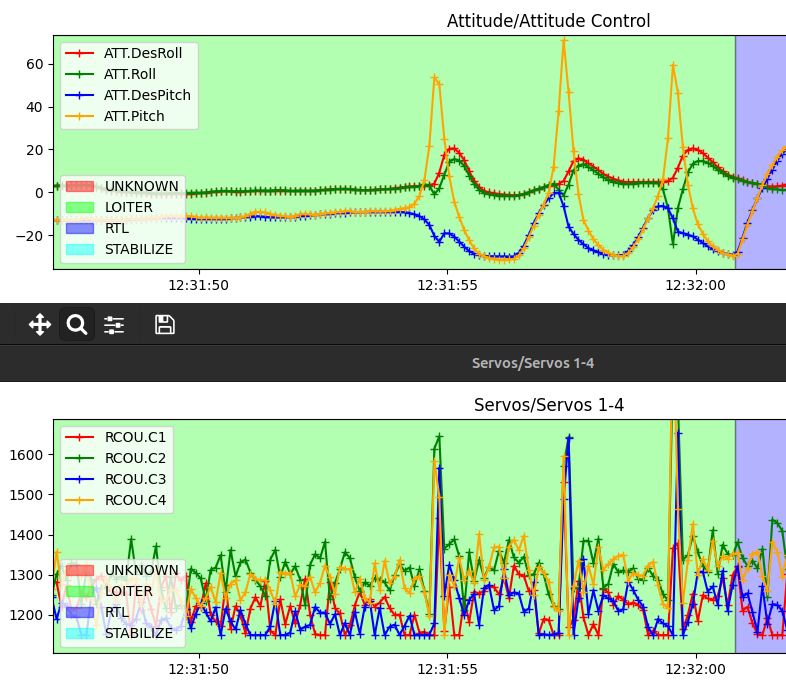

Yup, motors are hitting minimum speeds. I see the MOT_SPIN_MIN and MOT_SPIN_ARM are still on default and likely need to be turned down.
I see a lot of other tuning parameters are still on defaults.

Wow, thank you for looking at the file. Ok I will check the MOT_SPIN_MIN and _ARM parameters. Any suggestions as to whether I should increase or decrease the parameters. I know I am running a “relatively” high kV set of motors (5,500 kV) on 3 cells so my throttle setting is pretty low.
As far as the other parameters I am pretty of the philosophy that as long as the quad flies stable I leave the parameters alone. The only parameters I do tweak are the PID numbers if the quad is not as stable. For most of my flying the default settings seem to satisfy my needs. I had been down the road of chasing the optimum tune but mostly I cannot tell the difference much in a small quad like these. However I can change the motors setting if I am having low throttle issues that you can see.
Thanks again for checking on the file.
They need to go down. The motors are hitting their min limit so you are getting a control saturation. I can’t tell you how much. It’s going to be based on your build. You need to follow the link I provided and test it to see for yourself.
Thank you. I will turn them down…….slowly and tests.
