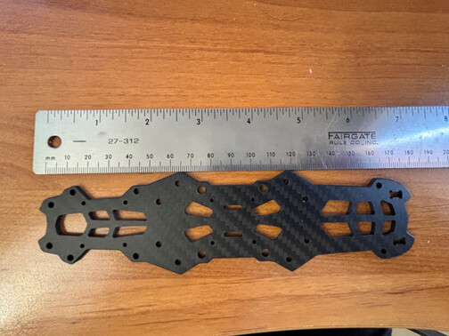

I don’t know if this will help you but here is generic 7" bottom plate. You can see where the standoffs mount, it would need to be inside those.

Thanks. This will help I guess. Yes the mounts are still 30x30. Just wanted to know the board outline limit. Some frames have a covering on the side I guess

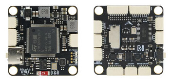

Okay this is the 100 pin version, which is commonly used on common FCs. There are 144, 176 and I think H7 even comes in a 204 LQFP which measures 28x28. LOL.

Here is a link to a 7" Frame Stp assy model.
