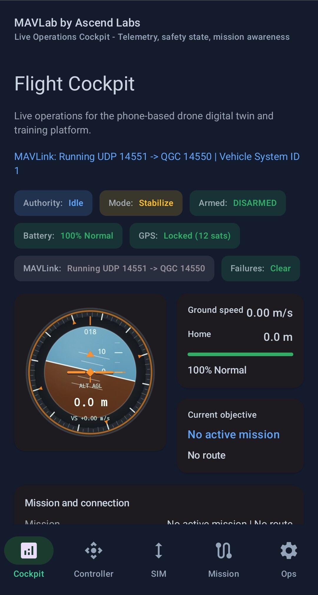

I’d like to share MAVLab, a free and open-source Android app for learning drone systems hands-on.
The main idea: it runs a full drone digital twin — 6-DOF physics, a cascaded-PID autopilot with ArduCopter-style flight modes, a mission engine, and a MAVLink v2 server — entirely on the phone. Then unmodified QGroundControl or Mission Planner connects to it (same-phone split-screen, or desktop over Wi-Fi) and drives it as a real vehicle. So a beginner can plan and fly a full autonomous mission with the actual professional GCS, using nothing but the phone in their hand — no Pixhawk, no SITL, no Docker. It’s meant as a first learning layer before ArduPilot/PX4 SITL, not a SITL replacement.

  • Presents to a GCS as an ArduPilot-like copter over MAVLink 2.0 (UDP) — verified with both QGroundControl and Mission Planner
  • Full mission workflow: upload from the GCS → AUTO execution → live progress (MISSION_CURRENT / ITEM_REACHED) reported back
  • Command surface with COMMAND_ACK: arm/disarm, takeoff, land, mode change, mission start, stream-rate, capability handshake (full list in Appendix A of the report)

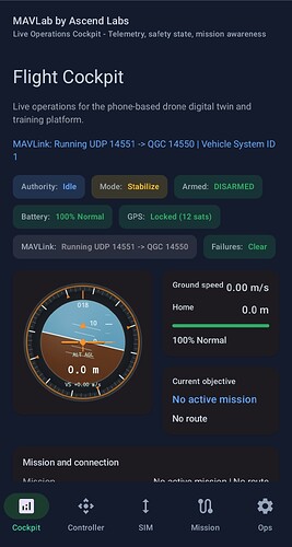

  • Phone sensors as flight input — tilt the phone and the aircraft responds; gyro/accel/mag/GPS fused into attitude
  • Real-time 3D digital twin that tracks the true vehicle state

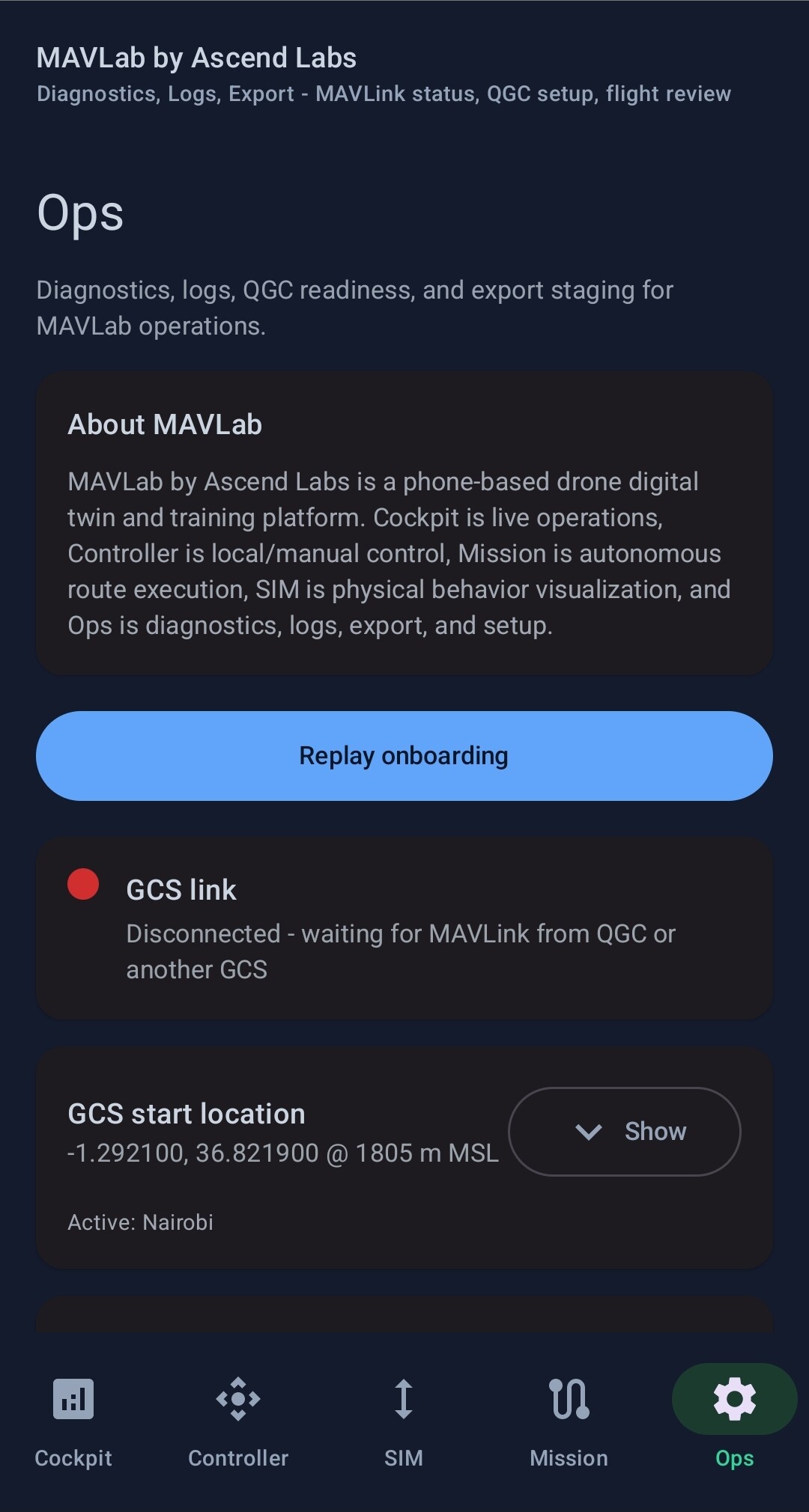

  • Five teaching surfaces: Cockpit (telemetry) · Controller · Mission · SIM (3D) · Ops (diagnostics/setup)

  • Same phone: open MAVLab, then QGC in split-screen — QGC auto-detects the vehicle on 127.0.0.1:14550
  • Desktop GCS: put the phone and computer on the same Wi-Fi; the phone’s UDP broadcast links automatically
  • Start location is configurable in the Ops screen (default is Nairobi)
