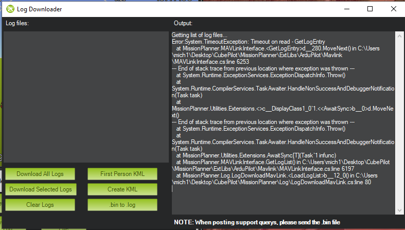

Do you have a .bin log file with log_disarmed set to 1?
No just following the documented configuration process.
Thank you for your answer. I just found out that I was supposed to have a bin file. Apparently I can not download it, or I do not have it.

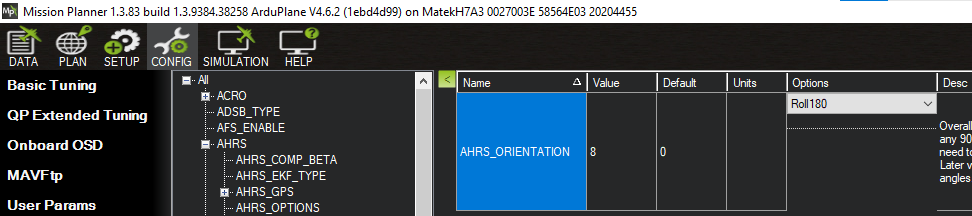

I just realized a big limitation of my board: it only works if the PCB has the bottom up ( components down) WHO designs a board to be used only like this ??? I tried to recalibrate the accelerometer to use it nomaly ( for me ) but then the symptoms from my first post show up… this is NOT ok Matek!!!
Is there a setting to fix this ?

Of course there is. Some details here Board orientation

If you look in the description shown linked by @Jai.GAY you clearly can notice that the standard us is with Components on downside. You was able to get the information before ordering the FC. So this is not a fault.
You are able to configure ardupilot in nearly any rotation as linked by @dkemxr

All you need to know is in the link I posted under “alternative orientations”. How do we know how you have mounted the board? Just saying it’s component side down doesn’t define it sufficiently. After you have configured the AHRS_ORIENTATION Parameter correctly use Mission planners HUD to determine if it’s right.
Kudos Dave : Roll 180 deg
Nice! That would have been my 1st guess but you could have also rotated it in another plane so no way to know.
This only shows your setting but how should someone can check if it is correct if you don’t show also how your FC is mounted.
So show ALL DETAILS
