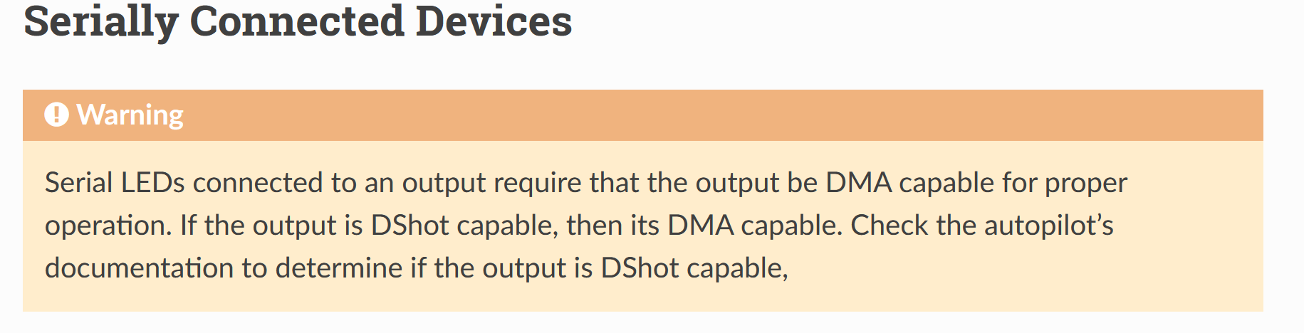

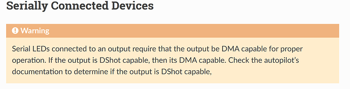

Just saw this as well - I thought that having “enough” DMA channels on an H7 flight controller wasn’t typically an issue, but I’m sure I’m missing something. - External LEDs — Copter documentation
