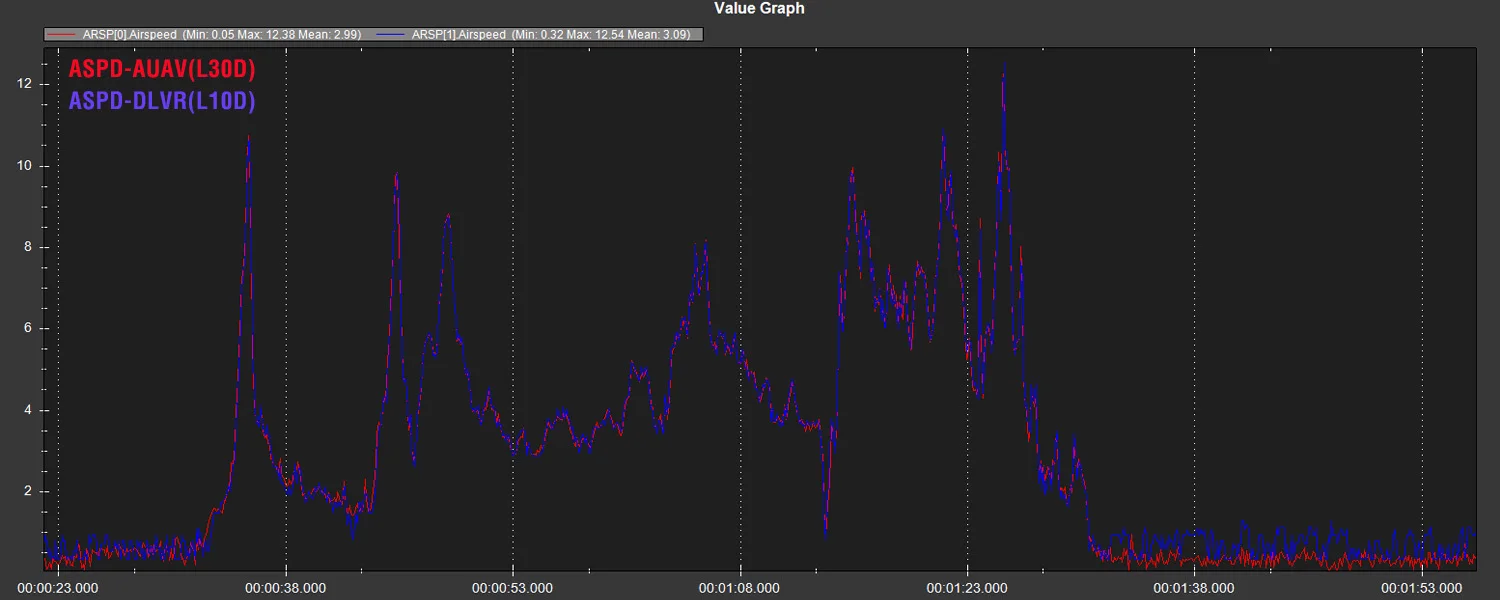

Matek ASPD-DLVR vs. ASPD-AUAV for VTOL use

Key differences:
AUAV Pressure Range: 7500Pa
Speed Range: 400 km/h(111 m/s)
“AUAV has better offset in still air.”
DLVR Pressure Range: 2500Pa
Speed Range: ±250 km/h
I don’t really care about the top speed, but I care a lot about the 0m/s to ~9m/s range (the stall speed of th T2-Cruza is reportedly 32km/s (8.88m/s)). From the data I have collected, it looks like the AUAV is the better choice for my application, but a second opinion would be greatly appreciated. Am I leaning towards the correct choice, or is there a better (CAN) airspeed sensor for low speed operation?
Thanks!
Looks like the AUAV has a more stable reading. Would be interesting to see, how the different pressure versions of the AUAV compare. The L05D should be enough for normal planes without a turbine/rocket motor and by datasheet more accurate.
Another point i came across regarding the AUAV Airspeed sensor: It has two signal paths, one for differential pressure and one for absoulute pressure. Thats pretty amazing!
Barometer readings inside the fuselage of a plane are usually influenced by compression effects having the measuring point outside should result in more accurate height measurements.
