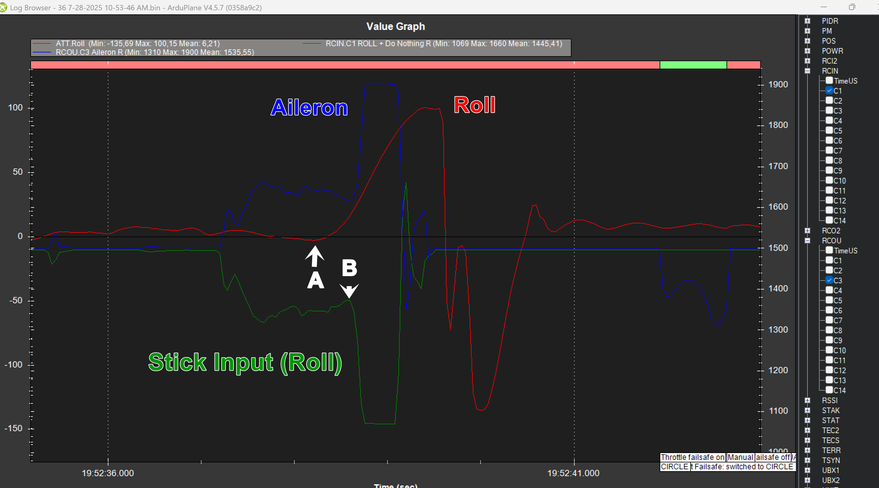

Hello. I’m new to this and would greatly appreciate some help analyzing my flight log to see if we can figure out what happened.
Upon launch, the plane flew for about 1 second, before crabbing right, then rolling hard right and hitting the ground.

You have started in manual mode, so the aileron position (blue) behaves exactly as the stick input for Roll (green).
Roll input is slightly to the right. At A there is enough speed for the aileron to take effect and the aircraft begins to roll (red) to the right. At B you notice this and apply full rudder to the right, causing the aircraft to tip completely.
I suspect that the stick input on the transmitter is steering in the wrong direction! Be sure to check that the rudder deflection in FBWA and manual is correct: Starting up and calibrating Plane — Plane documentation
Rolf

I should’ve mentioned this is a relatively heavy plane - I’ll have to double check, but AUW was in the neighborhood of 4-5kg. Despite full throttle input, it’s been suggested that the launch was too slow and that a stall occurred. Is there anything in the log that could confirm that?
You are right. Assuming that the aileron direction was correct, a tip stall is even very likely. The aircraft then tends to tip to the side on which the ailerons go down (A reason for differential ailerons: greater deflection being upwards) . Sorry I didn’t think of that right away.

This is very helpful! Using UAV Log Viewer, I can see that there was a decent amount of unintentional roll input to the left when pitching up. How likely of a culprit would you say this is compared to other ideas you might have?

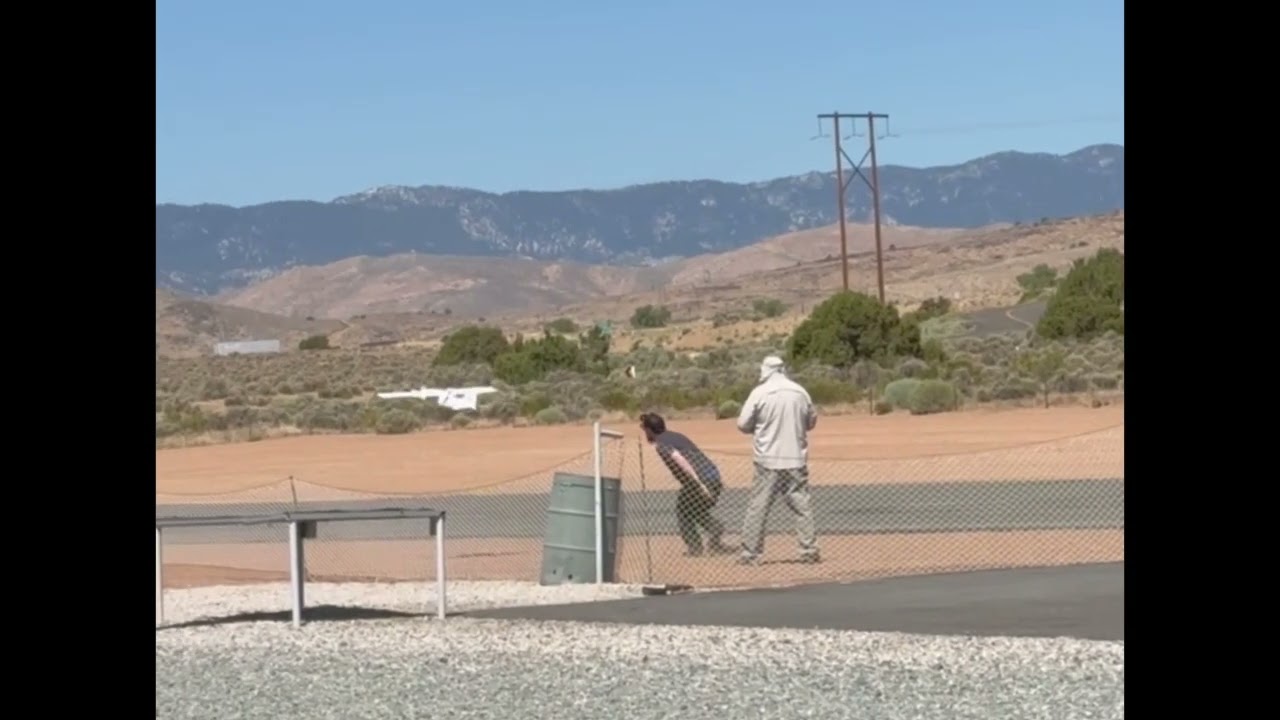

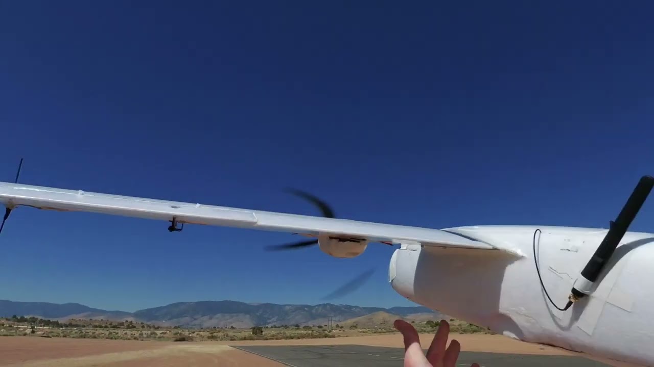

Here are two videos of the maiden attempt.
Phone angle:
Head mounted angle:

This was my first time throwing such a large plane. After seeing the phone angle video, it seems like the throw had pretty good heft, but I don’t know if it should’ve been more level (pitch wise). There was essentially zero headwind.

From my experience it looks that the speed at the throw was not enough to hold altitude and also the speed not rises fast enough. In such situation it is not the best idea to put elevator up. This increases the angle of attak possible followed by a stall. To increase speed elevator must be neutral or very low down. If than still the speed is to low to have enough lift trust for the plane, you directly smooth land in front of the starting place.

As also @Rolf and @menschel assumed I also think the main problem is to less motor thrust at the moment of throw. If the motor thrust is such limited best is to throw the plane not with nose up but with nose slightly down and as much speed as possible. I know this is not easy for such a plane. You throw the plane with two hands. I think this is due to the wide hull which makes a spear-like one hand grip impossible.
And yes elevator and ailerons should be neutral at the moment of throw.

is your video a slow motion or realtime.
It take about 15sec between launch and crash. On 9m/s this is round about 100+ meter.
But it looks much less at the video.
Also you compare your launch with others but you also states that the other increase quickly the speed. This don’t happen on your video.
So I think both the speed at launch and the motor thrust are to low an this caused the crash.
The 1st video (phone angle) is slow motion. The 2nd video (head mounted) plays in realtime, then one more time in slow motion. If it helps, I can make the 1st video realtime too.
