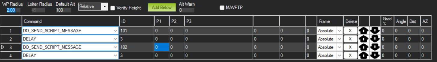

Thanks for the info, I wrote a seperate LUA script for the dropping when on a mission. I cant get the mission to enter the scrypt as it goes into the mission but does not display the set messages and also dont activate the servos.
I think I am setting up the program incorrectly, see screenshot of plan.
Here is the code I am using for the drop.

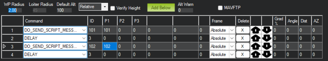

Mission bait dropper needs to run in a loop, I personally would unify them.
Thanks, is it possible to do them separate as when i combine them I screw up even the manual and rtl functions (maybe something I can do after I get it to actually work). Am I setting the script up correctly in missionplanner on the planning tab?
I am not sure about the id and P1 values.

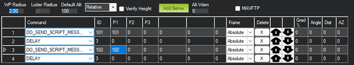

This is the example for receiving DO_SEND_SCRIPT_MESSAGE commands:
Thanks so much, for future reference this worked for me.
function update()
  -- check for scripting DO commands in the mission
  local time_ms, p1, p2, p3, p4 = mission_receive()
  if time_ms then
    gcs:send_text(6, string.format("Mission CMD: p1=%d", p1))
    if p1 == 101 then
      -- Drop left bait
      SRV_Channels:set_output_pwm(95, 1000)
      gcs:send_text(6, "Mission: Dropped LEFT bait")
    elseif p1 == 102 then
      -- Drop right bait
      SRV_Channels:set_output_pwm(94, 1000)
      gcs:send_text(6, "Mission: Dropped RIGHT bait")
    end
  end
  return update, 100
end
return update()
