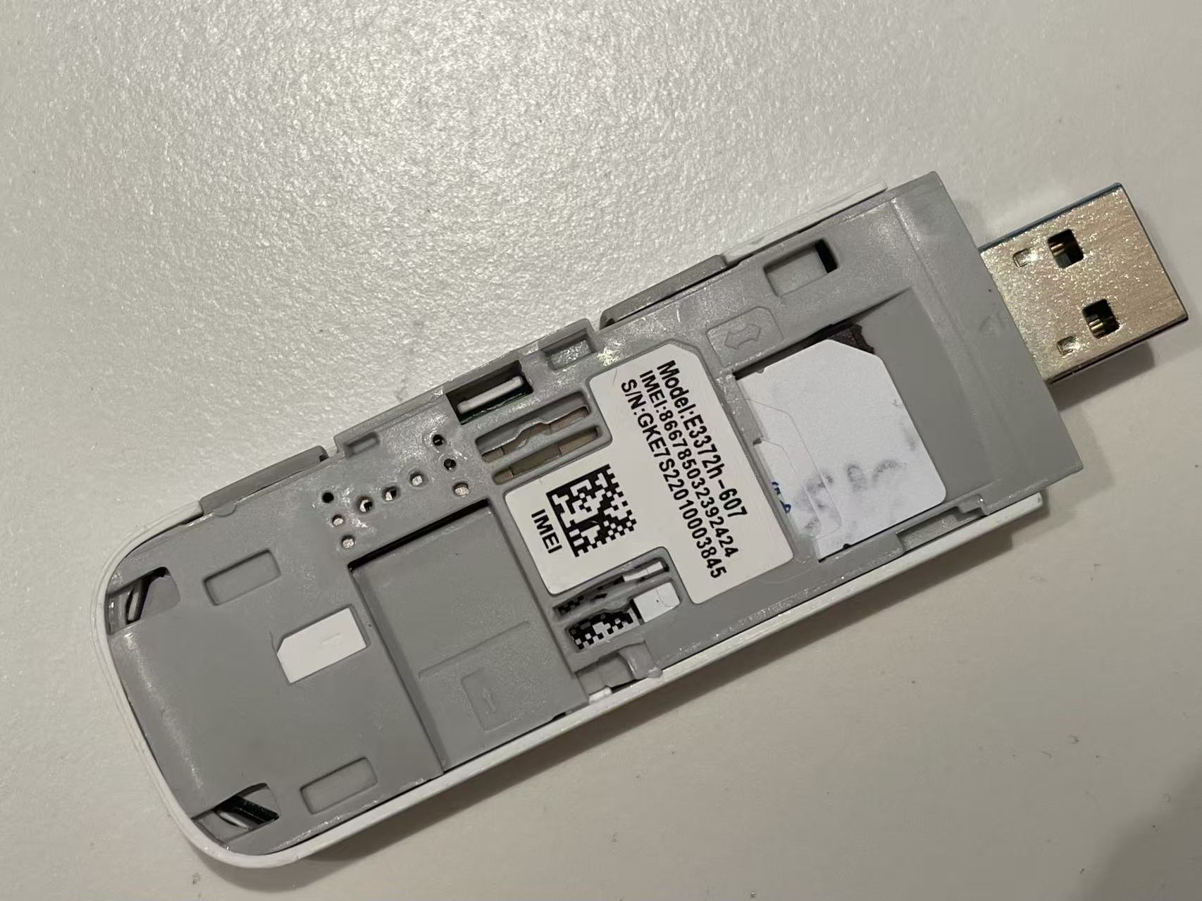

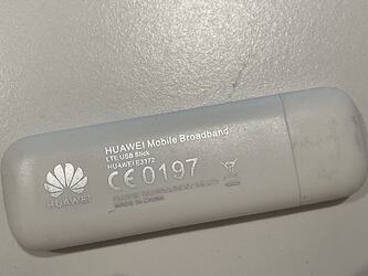

Any chance you may consider to add this commonly used Huawei LTE USB dongle modem to the supported collection?
Or describe how to include it…
I have used LTE for telemetry and rc control for some years, and it’s difficult to go back to limited range. I use other solutions for FPV video.
I would love to take out all my RaspberryPi units from my drones if I just could.
This LTE USB dongle from Huawei is working for me across Europe and also in China, Just swop SIMs. It’s so convenient to swop the modem and sim from model to model or my Mac.

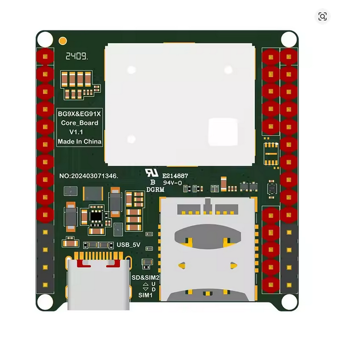

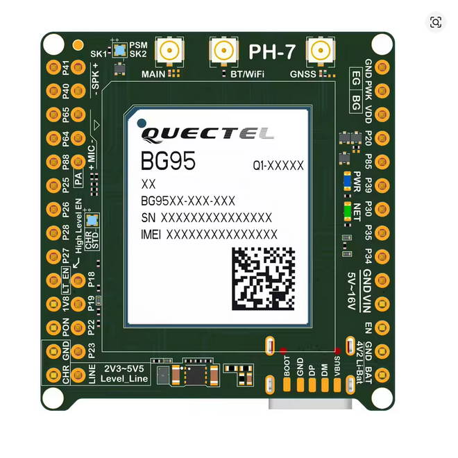

I’ve just tested the Quectel BG93-M3 with the most recent script from github.
Its working as expected.
This is a offical evaluation board design from Quectel which has a better layout than the and-global board i bought with simcom modems.
You can activate an onboard 3,3V level shifter by bridging pin 1V8 and LT_EN. It works with my CAN-Adapter and also directly on my Pixhawk 4 UART.

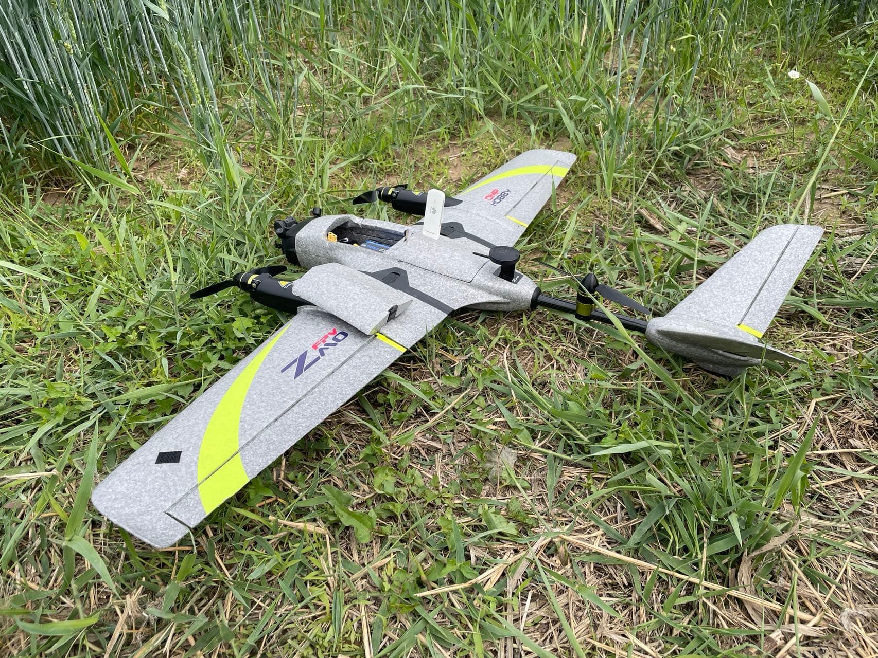

Did a first flight test with my SIMCOM 7600E-L1C today. Its connected via a Vimdrones Pico CAN-Adapter because of some level shifting issues.
Overall i am not completely happy with it. MissionPlanner had some trouble to reconnect after a sudden connection loss. Took nearly 10 attempts to complete parameter download an establish a connection. RSSI was at 31, 120m altitude.
Also i found another small “bug”:
When initial_baudrate and regular baudrate don’t match, the script won’t be able to connect to the modem after a software reboot (without repowering the modem), because it tries the initial_baudrate again.
Maybe its reasonable to try regular baudrate after several failed attempts on initial_baudrate?

I’ve now received this board and have been doing some testing. I’ve been comparing it to a Simcom SIM7600E-H on the same antenna. The BG95 is doing very badly, with a very weak connection, and frequently losing the link. Changing power supply did not help.
I suspect the key difference is the BG95 is a CAT1 modem, and the SIM7600E-H is a CAT4. The local cell providers don’t seem to allow CAT1 connections from all towers, I end up connected to a tower on the far side of Canberra with the BG95, whereas the CAT4 modem connects to a tower that is quite close (you can see what tower you are connected to using the hologram.io web dashboard).

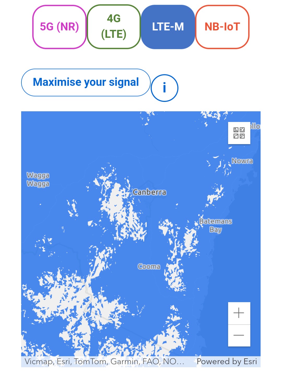

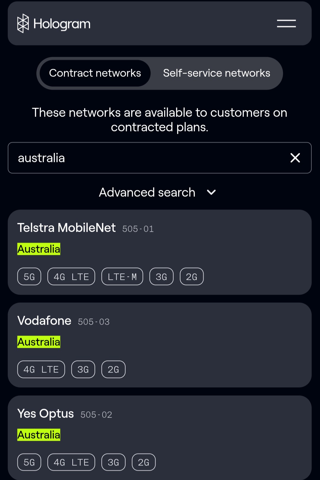

I suspect the local providers (Telstra, Optus and Vodaphone in Canberra) don’t have good support for CAT-M1.
Great that your modem is working well now!
Did a short visit to the Telstra coverage map.
Looks like there are indeed some white spots in your area:
Optus and Vodafone AU just mention NB-IOT and don’t provide detailed coverage maps.
