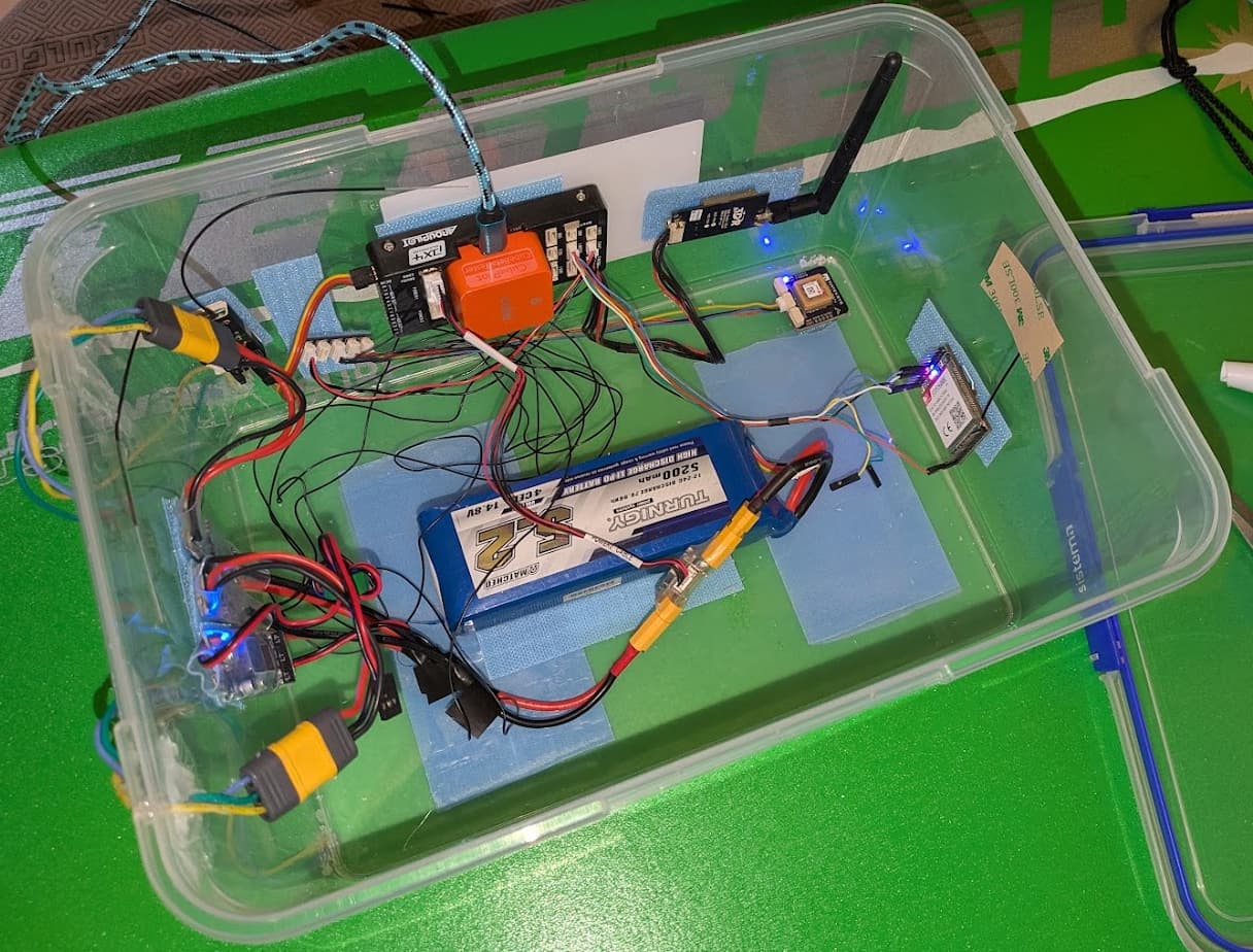

ArduPilot now has support for direct-attached low cost LTE modems, allowing for connection to cellular networks without a companion computer.
In the picture above I have attached a SIM7600E-H CAT1 LTE modem to a CubeOrange in my autonomous buoy project on the Telem1 serial port. This gives me connectivity over the a large area for my boat without relying on a GCS radio and without any line of sight issues. The modems are very cheap, down to US$20 or so, so the main cost is the SIM card you need to get to use the cellular network. The SIM card cost varies a lot between countries and type of plan.

The lua script can setup the connection in either ā€œtransparent TCPā€ or ā€œPPPā€ mode. In transparent TCP mode the script creates a single TCP connection to a single server. This is useful for a simple telemetry link, and can be a good choice if you want to minimise the amount of memory used by the system. When using transparent TCP the script has parameters for the servers IPv4 address and TCP port number.
The other option, PPP, sets up a full IPv4 network stack to the modem. This allows you to use all of the NET_Px parameters to setup multiple TCP and UDP links, both incoming and outgoing. It also means that other lua scripts can send and receive data over TCP and UDP, allowing for a huge amount of flexibility in what you do with the network connection.
Note that to use PPP you need PPP support compiled into your firmware. Use the custom build server to ensure your build has PPP support.

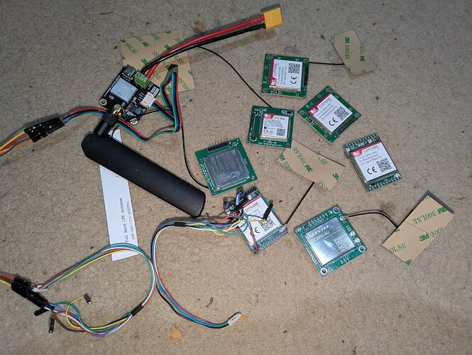

Modem Chipsets
The only LTE modems I have actually tested so far are the SIM7600E-H and the Air780. I have several other variants on order that I expect will work and I’ll update this post with updated information as I test other modems.
If you are thinking of buying one right now and you want to get one that has been tested then get a SIM7600E-H, but I strongly suspect all the SIM76xx variants will work. Another one that I suspect will work well (but is not tested yet) is the EC200. I have one of those on order that should arrive soon, and the datasheet looks good.
I ordered most of my modems from AliExpress, but you should also look at other sites. DFRobot has some nice designs with a variety of chipsets and there are a lot of other resellers, including Amazon, Digikey etc.
Regarding the Air780, while I have it working, I haven’t been able to get it to report signal strength while connected, so I don’t recommend it. Having the signal strength show up on the GCS and in the logs is very nice.

One thing I have noticed with the SIM7600E-H I have at the moment is it is quite power sensitive. For example, if I connect the modem to a CubeOrange and only power the cube with USB then it never gets past the ā€œCREGā€ step in the lua script as the modem can’t register on the network. If I power the cube with a CubePilot power brick then it works fine, but on some boards you may need a separate BEC to power the modem.

I now have the following modems tested and working:
  • SIM7600E-H
  • SIM7600G-H
  • Air780
  • EC200
  • SIM7670
There are some limitations however:
  • the Air780 can’t report signal strength while connected, which is annoying
  • the SIM7670 only does TCP connections so far, no PPP

my collection of modems is growing, not all tested yet
