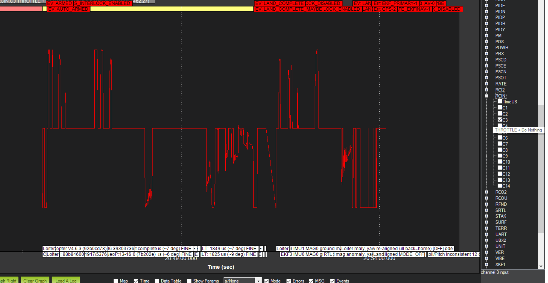

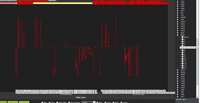

Looking at my controls in Mission planner, I can see that I definitely was trying to command a disarm with throttle channel 3, but the motors would not slow down. I can also see a significant role, but it appears that it says landing complete and landing complete. maybe during this entire time but there’s also EKF IMU0 IMU1MAG ground mag anomalies.

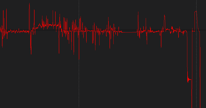

You can see the Roll graph and also see the Throttle control trying to disarm at the end but the speed never dropped to the lowest speed near disarm type speeds.
  1. EKF/GPS/compass fault occurred.
  2. That appears to have triggered an EKF failsafe / navigation failure response toward LAND.
  3. During/after landing, the aircraft reached roughly −52° roll and the controller continued actively driving opposing motor pairs trying to correct attitude.
  4. The land detector was toggling between LAND_COMPLETE and LAND_COMPLETE_MAYBE, so it was not cleanly recognizing a settled landing.
  5. Mission Planner independently flagged GPS_GLITCH and a major compass-field anomaly.
  6. The remaining unexplained issue was why your manual/Lua emergency-disarm commands did not shut the motors down immediately.

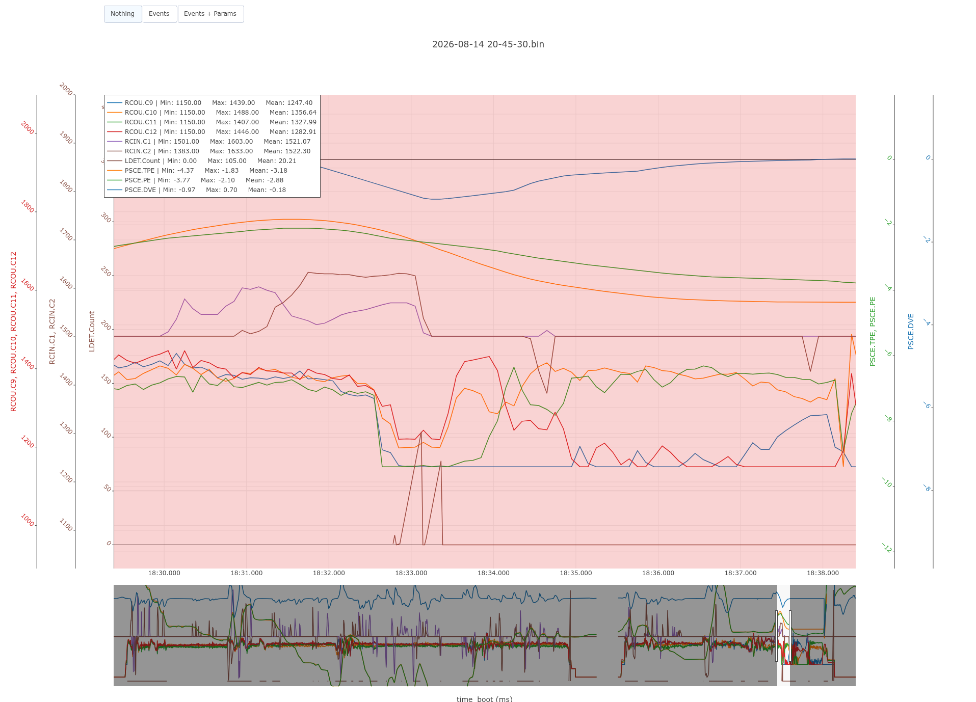

I think that the most probable cause is quite strong action on the pitch/roll stick during the final phase of landing. Here is the relevant portion of the logs:
The brown plot with two peaks at the lower part is the landing detector count. It was only active during that period and has actually reached the state “maybe landed” before the rest of the copter decided otherwise.
The reason it decided otherwise was a growing discrepancy between desired and actual positions (PSCE plots shown), and a quite high desired velocity. That’s why the drone started flying sideways, but at this moment some of its landing legs were already on the ground - so it was kind of standing on the edge. It wanted to fly few meters sideways - because of your earlier quite aggressive actions on pitch and roll sticks.
Switching to LAND immediately removed the desire of flying sideways.
TL;DR: better switch to LAND when you want to land, then repositioning with sticks would do a more correct job.

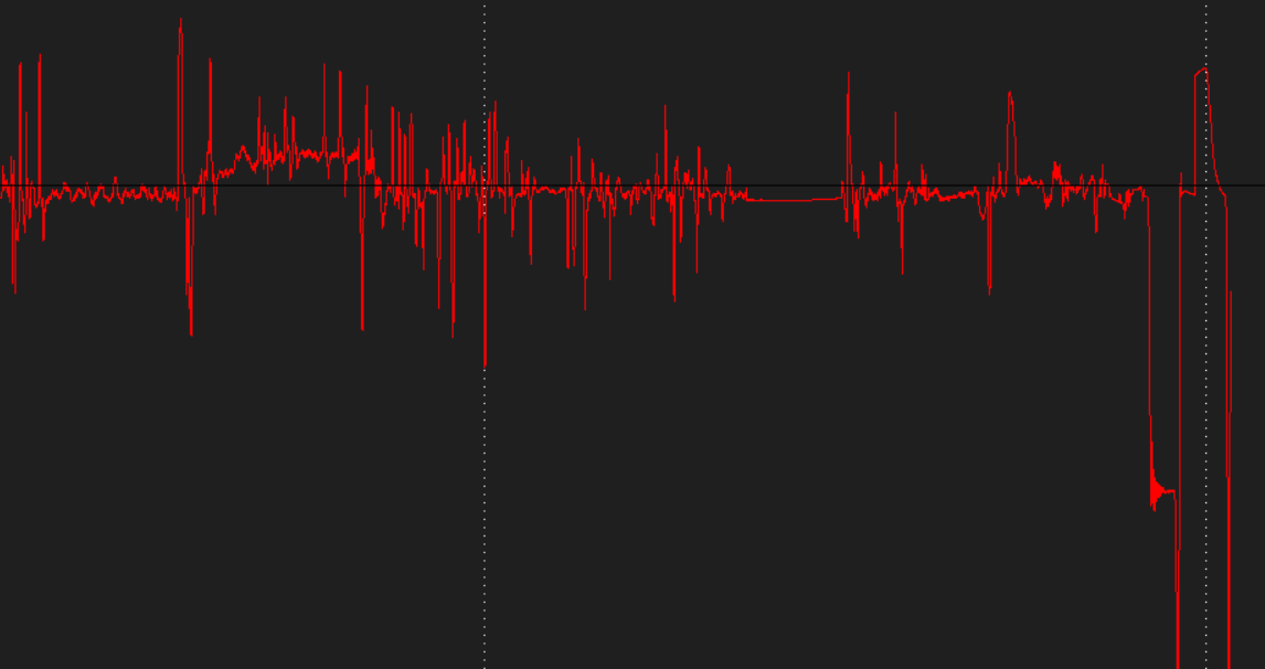

The EKF error that triggered a LAND switch in the standing-on-the-edge flight was most likely triggered by insane (VIBE up to 50 on the first IMU and up to 100 on the second one) vibrations, which happened when roll reached really high values - so I suspect propellers touching the ground. In these conditions with such vibrations, one cannot expect the machine to behave well, it’s an emergency - so, getting back to potential EKF problems, this is not an indication of any problems.

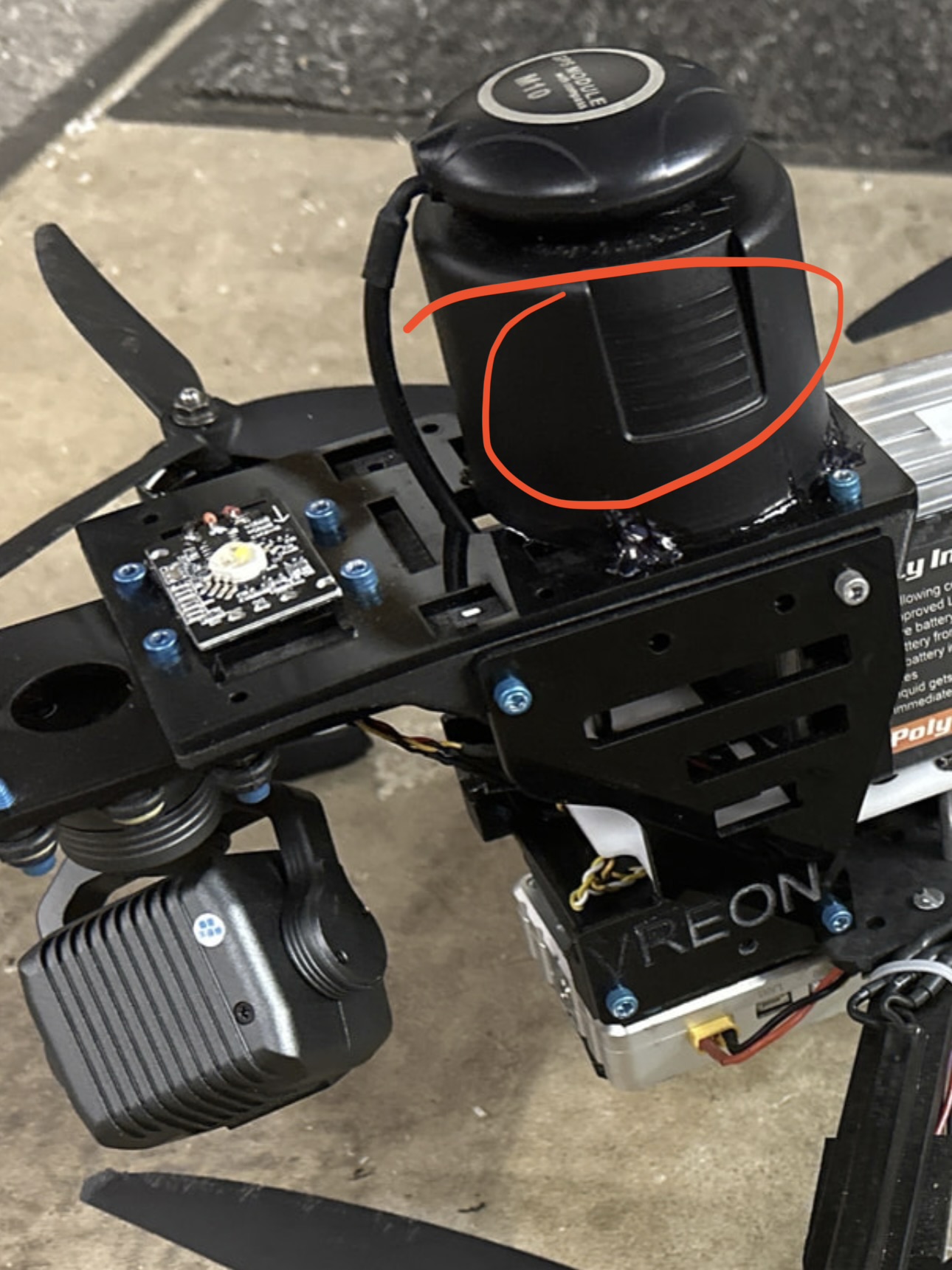

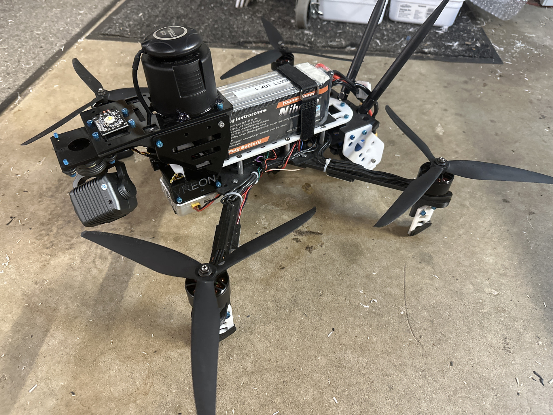

For the source of magnetic inference, based on your photos, I don’t really think that motors or other power wires have a lot of influence. However, I would consider checking your proximity sensor (am I right that the cylinder below the GPS module is a proximity sensor?) for being a potential source. I have no idea what it is, but some contain a rotating sensor head, which is then obviously driven by a motor, which may turn on when the vehicle is armed. If so, it may explain what you see.
But this is a pure heavy speculation.
Thanks very much for all of the detailed analysis. I only get the YAW on the rare occasion that I do get EKF variance on takeoff in which case yes there’s a YAW affect but during normal flight, I never see the YAW as you described. I’m not aware of any steel or magnetic material in the ground under the asphalt in my driveway during most testing. I’ve seen this happen at other locations at a Concrete driveway, which certainly could’ve had Rebar in it. Not sure if it was magnetized.

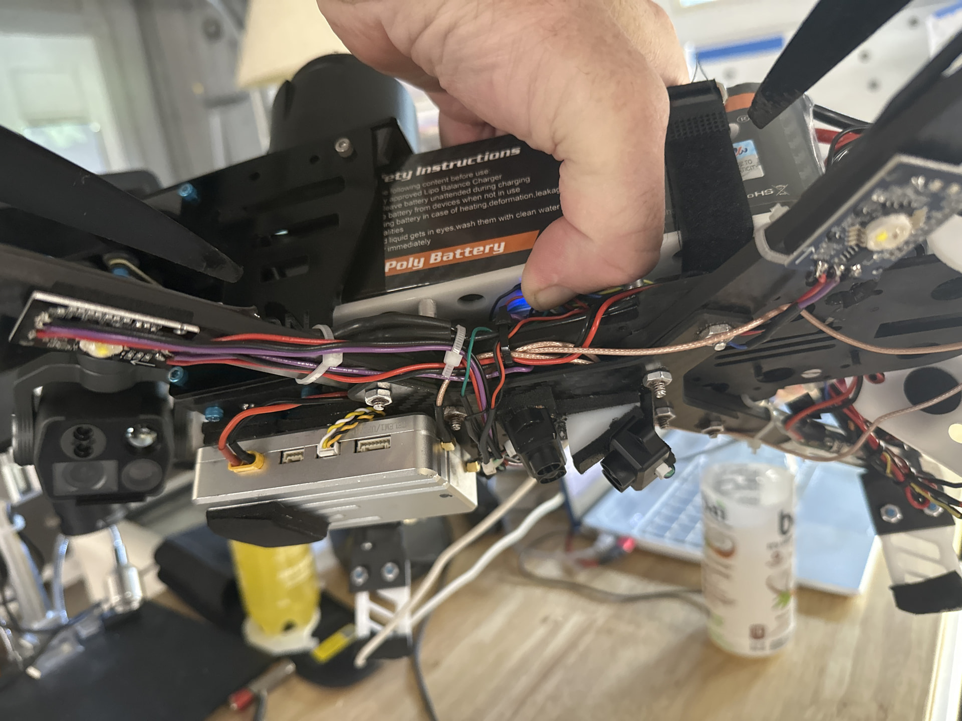

I will attempt to do the compass motor calibration tomorrow. One thing to know is is I use the PM 06 and a TEKKO 32F4 and there’s no elegant way to get the total combined current. You have to get the motor current and read it off of the TEKKO current output or you have to take the current off of the PM 06 which is driving camera, gimbal, rear spotlights, several PEC. Right now I’m taking current off of the PM 06 but tomorrow I’m going to switch that to the TEKKO. So I can use the current on the Compass motor calibration instead of throttle. I would love to find a setting or calibration that would solve this problem. I built this drone for search and rescue for pets and it has a 640 thermal, 48 MP daylight camera, laser rangefinder, and rear spotlights with tilt motor.
I got my disarm back working again, so I’ll be able to mitigate this experience in the future I had deleted the file. The very front device is a camera with gimbal, which yes has three motors in it. I have TF mini on the bottom, actually two of them went straight down and one Forward aimed down slightly.

This round tubular thing is the top of a spray paint can to raise M 10 trying to solve this problem.
The large aluminum box on the bottom is the SKYDROID GR03 long range transmitter.

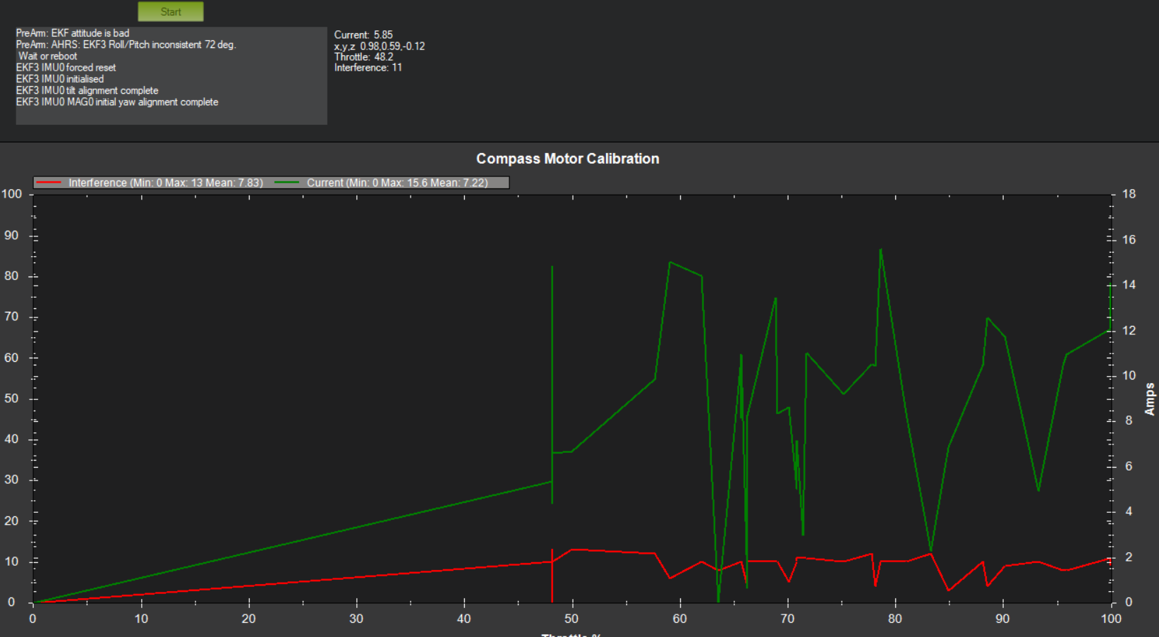

I learned how to do CompassMot today, I tested without props just to see how to do it. I’ll need to rig up a system for prop method. I put friction on some motors to simulate load. After each test it shows some errors but if I run the motors from the remote control, disarm, repeat I do not get EKF. Chatgpt says because I can run the motors and stress them using TestMotor and using remote control without EKF errors on the bench that it is likely those errors are coming from something related to the Compass Mot calibration
