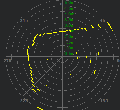

Seems averaging is done for the whole sector. I tested that on my desk, and the issue I see almost immediately is detecting narrow objects. I put my finger about 15cm from lidar, and because of averaging the whole sector was averaged to about 90cm with wall beeing about 2.5m from lidar.
I would say averaging should be just for single batch of measurements and rejecting low confidence values.
I would say this is kind of safety issue as narrower obstacles might not be detected as beeing too close.
I have done some more testing, in direct sunlight even with the confidence filter at 250 at still gets interference in direct sunlight, its not as much but It’s still there. Without the filter it’s a solid sector of noise.
What I’m thinking is that due to the random nature of the noise rather than averaging over the sector im going to compare data over 2 passes, that will drop the effective update speed from 10hz to 5hz but it should get rid of the random noise. basically, if the second pass isn’t within ±10cm then its rejected.
if that’s too slow then I will look at using doing the same but with odd and even angles.

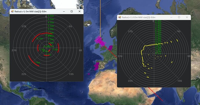

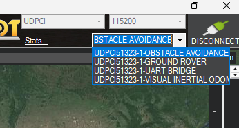

Quick question - how do You get more than 8 sectors in MP proximity diagram?
because I’m not using it as a native device, I convert it into to a mavlink proximity device with its own heartbeat, then I can select it in mission planner and get the 72 segment high resolution display directly from the rangefinder when I open the proximity display.

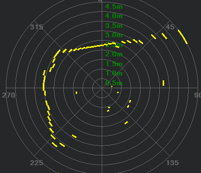

I did a quick test, and it seems measurements are stable,but I noticed some strange behavior I will have to test a little more to confirm it.
In general - there is about 3m to the wall, I put my hand like 0.5m from lidar, and it detects it fine, but… when I am moving my hand away for about 20cm suddenly it is no longer detected and distance jumps to 3m.
10cm hand from 1m would be 5.7deg, so angular resolution of LD06/LD19 should allow to detect it
