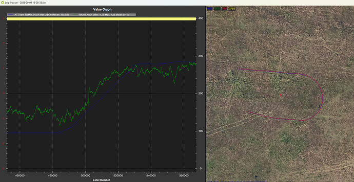

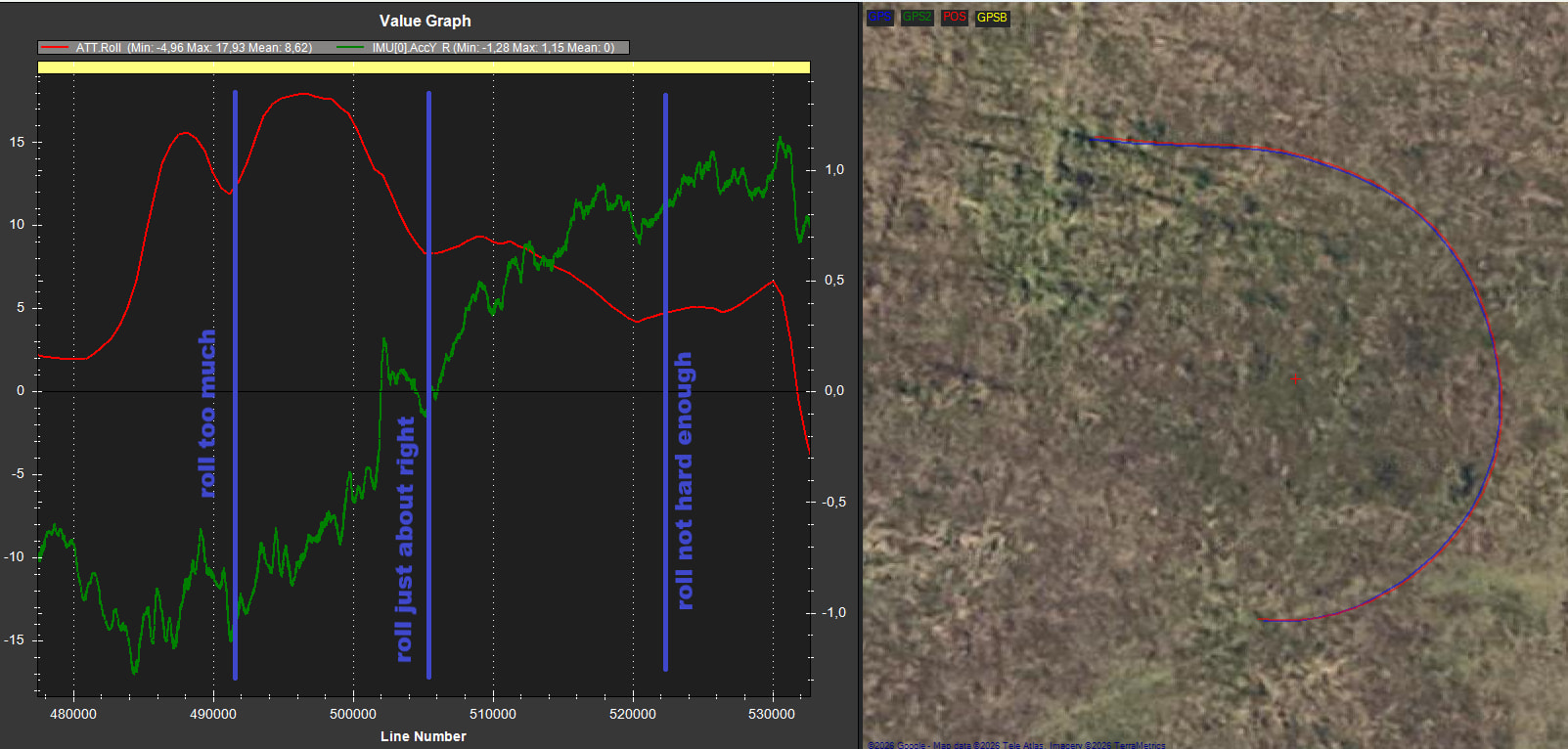

Looking for Acc.Y and Roll it looks like too much roll is applied when starting turn and not enough at the end

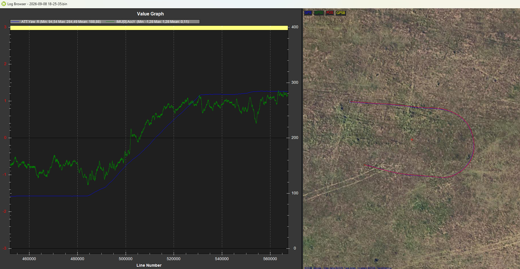

Small update - only with code change from post above, Turn seems to be less aggressive and I do not see initial aggressive roll, but still Y acceleration is not close 0. However I see also improvement in keeping altitude on breaking and turning in loiter with that change.
If anyone is interested, log from flight with change only from post above: https://drive.google.com/file/d/11U_f9WUknhkrRHcIiHgQHem0T9avbFt5/view?usp=sharing

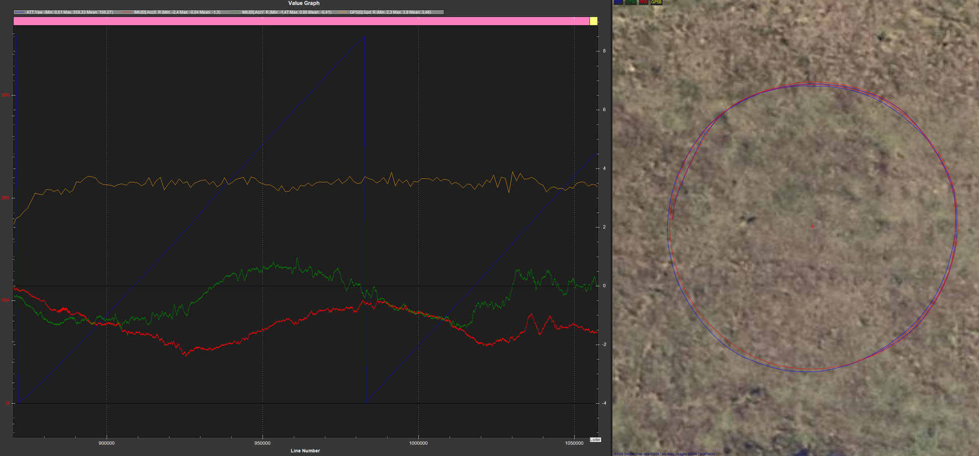

Today I did some test using circle flight mode with option to face toward flight direction instead of center of circle.
Looking on IMU[0].AccX and IMU[0].AccY there has to be something wrong with my understanding of those values. Velocity should be constant so why AccX is changing? Also centrifugal force and angular acceleration should be constant, so why AccY is changing? Sine period seems to be 1 full rotation. Would wind explain that? I would not expect slow wind to cause -1g to 1g swing on AccY
That is a smasll 3.5" drone and when loitering before initiating circle roll and pitch was man 1.3deg for roll and -2.28 for pitch.
… because it’s not 1g but 1 m/s^2?

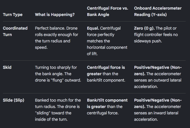

Ok. let’s start with the definition of a coordinated turn.
A coordinated turn will result in the aircraft heading being alinged with the velocity vector.
This is the broadest definition that holds for changing speed and turn rate.
In the case of an aircraft that navigates with a single thrust vector in the body fram z axis this will mean that the body frame y axis acceleration is zero.
Now let’s apply that to a real multirotor using coordinated turns in Loiter. The code applies a lateral acceleration target that is calculated based on the forward velocity and the commanded turn rate. That defines the ideal kinematic path the aircraft will take. This is passed to the position controller and it reacts to any position or velocity errors and corrects them by adding an additional acceleration.
A 1 m/s^2 correction is a 5.85 degree angle offset.
Any change in pitch or yaw command will change the trajectory and the aircraft will need to follow that change resulting in corrections. The same will happen for any wind or external disturbance. Any heading error will move the y axis acceleration away from zero.
This is the pitch and yaw rate:
In a fixed rate turn Loiter is asking for exactly the centripetal acceleration required for a perfect coordinated turn. Any change in pitch or yaw command has 5 controllers all dynamically working together to follow a changing path while dealing with all the imperfections of the real world.
Maybe 5 degrees of roll variation isn’t too surprising :slight_smile:
