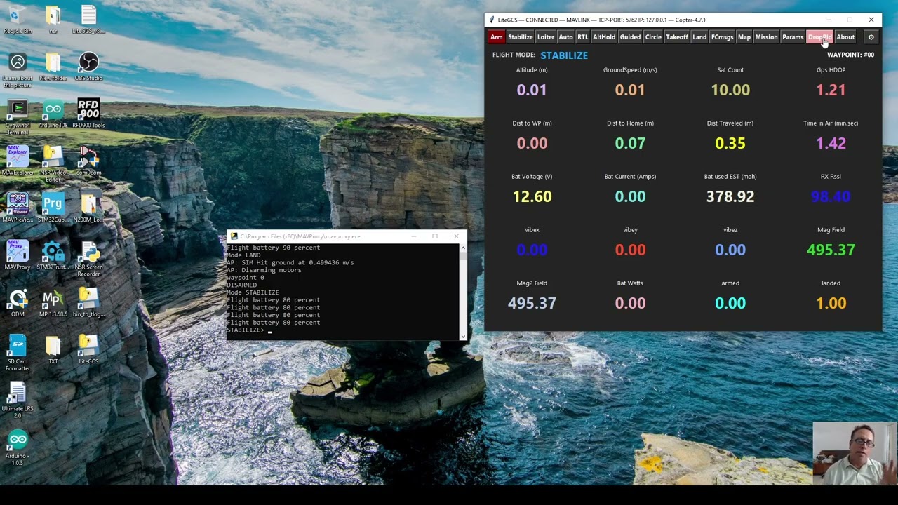

While in the flying field, I always dreamed of a lightweight GCS which have all the important buttons and important telemetry data on one panel infront of me, so I created one !
It has most of the good features I dreamed about. It can even run on Pi Zero 2W, Raspberry Pi 3B+ and above. In this case, I requires HDMI monitor, Keyboard, Mouse, Telemetry Radio, 5V, 3Amp source.
Let me make it clear, it’s not the competetor of Mission Panner or QGC nor it can compete, it’s just simple handy, lightweight GCS for flying Field.
This is LiteGCS ver 8.2.8, an upgraded version with some more added features and functionality.

    Press Settings button ( Extreme right on LiteGCS )
    Select TCP port 127.0.0.1:5762 for connectivity with SITL.
    Under PC Keyboard Flight control, check the box “Use PC arrow keys as RC sticks”
    You may or may not required to check boxes “Reverse Pitch”, “Reverse Roll”
    Press save button, you will be required to close the LiteGCS and re-launch it.
    After re-launch, LiteGCS will quickly connect with SITL on TCP-5762.
  3. Wait for some time as even in SITL, it takes some time to 3D Lock GPS.
    Press Guided Button, press Arm butto then quickly press Takeoff button and quickly type any altitude value like 5 ot 9 or 33 and press enter from your keyboard.

  6. Testing Drop Payload:
    See, if you can see button with exact text inside “Payload”, if yes then click on it but if it is displaying light red button “DropPld” or light green button
    “HoldPld” then continuously press this button for more than 3 secons till the Payload configuration window opens in front of you.
    Here in this window, you can select any of the six Aux1-6, you can select desired pwm value dor Hold Payload and Drop Payload.
    Do change if required, press Save button, close LiteGCS and re-launch.
    Drop Payload Testing:
    Focus on mavproxy black window which displays flight mode like STABILIZE>
    Type exact command in the quotes “status SERVO_OUTPUT_RAW” and press enter
    It will display all servos status, look for “servo9_raw”, most likely you will see its value 1100
    Now press light red button “DropPld”
    Now again focus on mavproxy black window and type same command as earlier “status SERVO_OUTPUT_RAW”, and press enter.
    It will display all servos status again, look for “servo9_raw”, you will see its value 1900, this denotes payload has been dropped,
    and now the button color will change to light green and button name will be “HoldPld”
