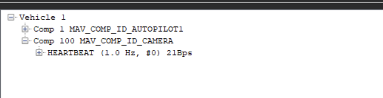

You need to understand MAVLink routing to configure everything correctly. But in short,
  1. Your onboard RPi must have the same SystemID as the FC
  2. Your RPi must emit heartbeat (typically at 1Hz)
  3. Your RPi must have ComponentID that isn’t 0 or FC ComponentID (IIRC typically 141 1) or Component ID of any other device on the same vehicle.
then Ardupilot should route communication to and from the RPi correctly (according to MAVLink routing rules) and you should see your camera on MAVLink inspector.
Then you have to configure Ardupilot for camera control over MAVLink by setting CAMx_TYPE to MAVLink (5) or MAVLinkCamV2 (6) depending on MAVLink camera control protocol you want to use.

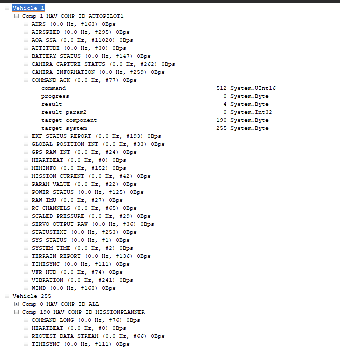

Sounds like I’m definitely missing the proper ID setup. I was viewing this as the RPI having none- or a unique SysID,(this was also suggested to me from a skilled ardupilot member) and I had assumed that the componentID was not important for this task and could be left 0, but the description you provided makes perfect sense.
I had this mavinspector screen open on my laptop this morning from previous tests, so I included it.
Just to ensure I understand, this shows my FC as sysID 1,component 1, my GCS as sysID 255, component 190, and my RPI as sysID 255, component 0. ? I’m fairly certain I will need to set the sysID and compID in python for the RPI and not in Mission planner, I’ve looked quite a bit at the available settings for Mavlink comms there along the way- and do have the camera options set the Mavlink.
Looks so to me.

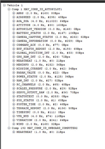

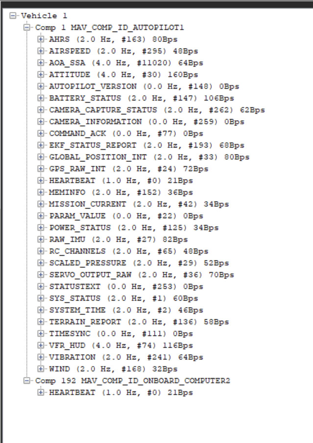

I’ve been able to set Sys and comp ID’s, after alot of fiddling
As directed- Target and source need to match, which looks like I have right, and I have a comp id that is not 0. I also seem to be sending a heartbeat, but, My listen code is not getting anywhere still.

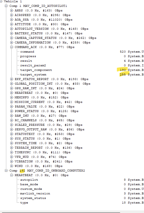

It would seem the message Im trying to listen for is routed specifically from GCS to FC. I can see in the Ack from FC, its sending the ack to SysID 255, comp 190. (Im assuming the same occurs when the message is sent from GCS to FC, but Im disconnected/away currently) Seems to me that these messages would not be available to the pi since they are specifically routed. I either need to change the component type to 0 to broadcast, or, set my pi to the same systemID and component ID as the FC? This would deviate from the advice given from @LupusTheCanine however.
So in the below, my RPI wont see this ack message from the FC, as its being routed to sys255, comp190. IF I set the rpi to 255, 190, I might be able to see the message? Seems having 2 devices with matching addresses is not correct however.
If your message targets broadcast component or RPi it should reach the RPi.
If Ardupilot gets commanded to take photo it emits appropriate MAVLink command (assuming it is configured for MAVLink camera control)and it should emit its own ack. Your digicam will send it’s ack to the FC and it should forward the ACK to GCS).
My message comes from the GCS, from what I see the comp ID is set dynamically for it? So I didnt see a way of broadcasting the command from GCS so the RPI could see it.

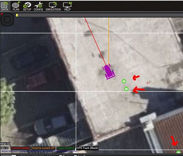

When Ardupilot receive a command to capture a photo (from GCS/LUA,…), it will also emit and broadcast CAMERA_FEEDBACK message - you should see it in mavlink inspector and also as a mark on Mission planner map. Camera should be configured as mavlink type.

I’m not seeing a mark on the map- nor CAMERA_FEEDBACK (180) in mavlink inspector.

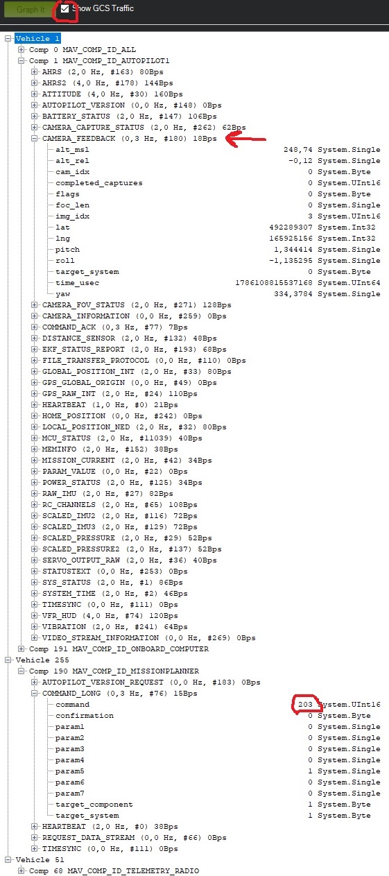

Are there any other prerequisites to having this DO_DIGICAM_CONTROL (203) command be broadcast that I might be overlooking? If I take a freshly flashed FC, set cam1 type to mavlink, and trigger from right clicking the map screen, DO_DIGICAM_CONTROL (203) gets broadcast and not directly routed to the connected FC?
Thanks for this suggestion. Since my approach is still not working after numerous attempts and angles following documentation and responses here, I’ll try this as a means of knowing the message has been sent and confirming the pi sees/handles the message.
Do you have CAM1_TYPE set to 5 ?
Then when you execute “Trigger camera NOW” in Mission planner, you should see msg 203 from GCS and also msg 180 from FC in mavlink inspector (then its simple to capture 180 on RPi).

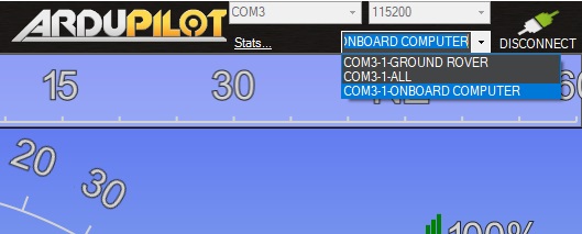

For debug, you can also send a 203 command straight to the RPi like this:
(RPi probably needs to emit heartbeats at 1Hz to show here)
