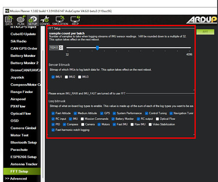

    Fast and Medium attitude and Fast harmonic notch logging / Fast IMU
  • Page 29
    INS_LOG_BAT_OPT=5 but 4 is enough as documentation suggest, also RAW gyro logging should be mentioned.

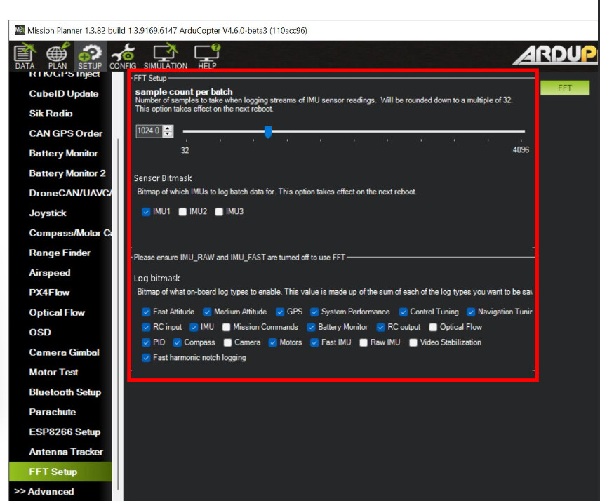

Are this also wrong? How do you think?
