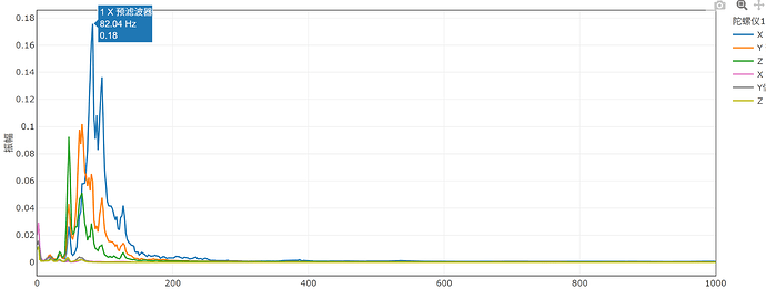

Continue to seek advice on solutions for lifting with ropes

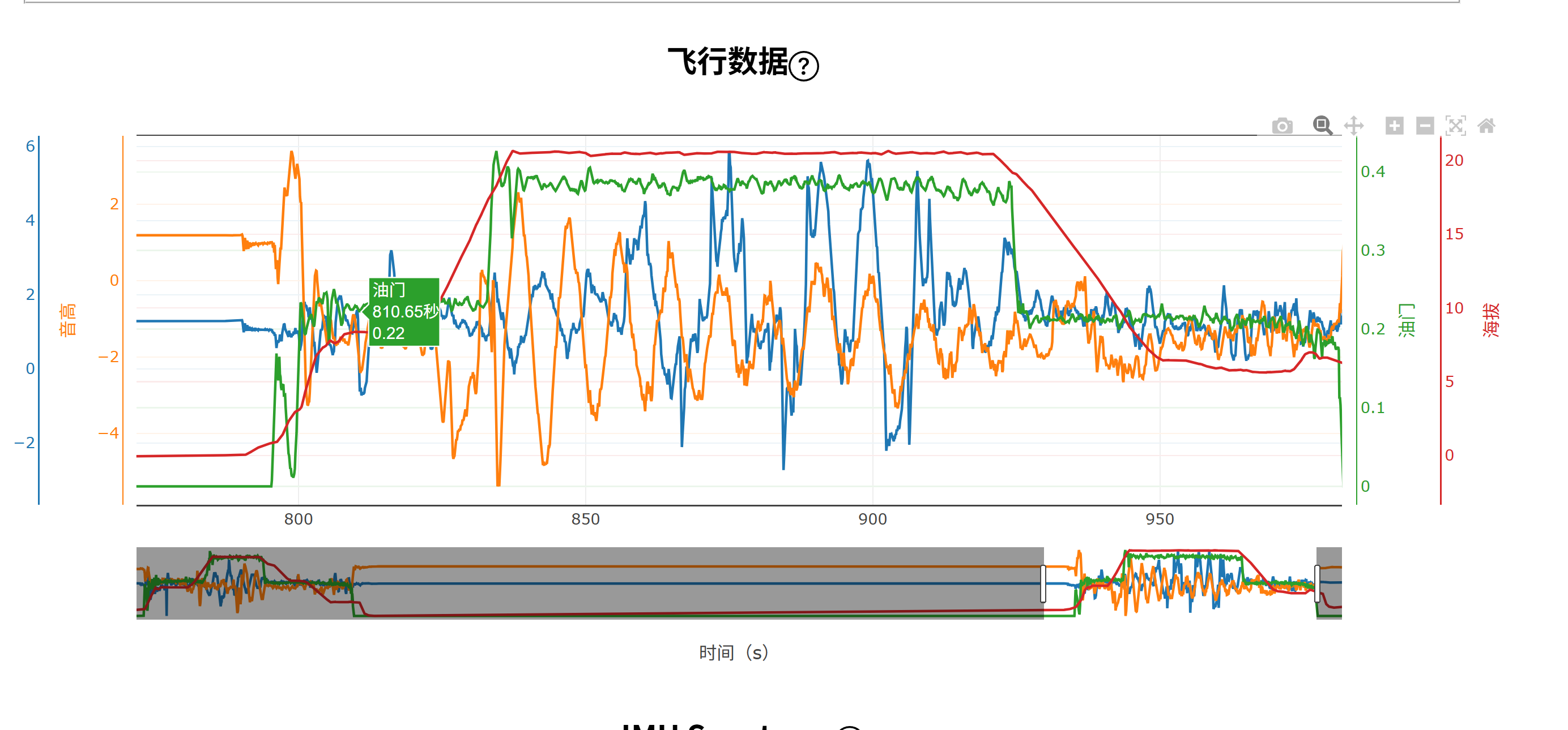

I need the drone to take off with a throttle of about 0.2, and the vibration situation is shown in the following picture

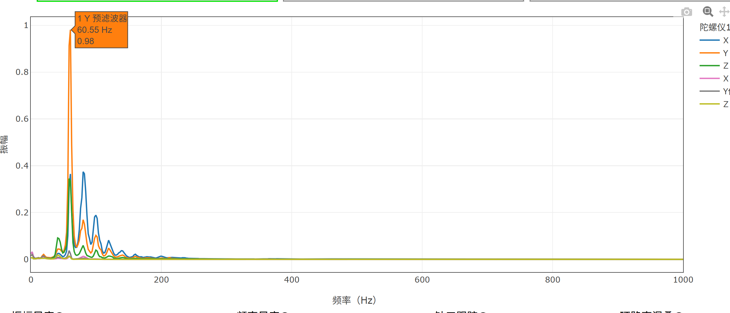

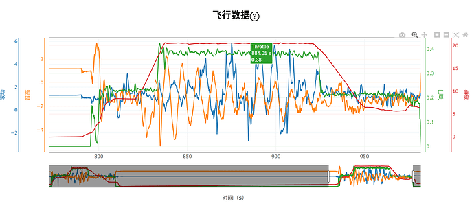

After I lifted the cargo onto the drone, the throttle was about 0.38, and the vibration was as shown in the following picture
Can I set INS-HNTCH-ENABLE to INS-HNTCH-REF=0.2 and INS-HNTCH-FERQ=82
Then press INS-HNTC2EneBLE to press INS-HNTC2-REF=0.38 INS-HNTCH-FERQ=60
Set up 2 filters to solve the filtering situation between no-load and full load? But this brings another problem, because each time the load is different, is there a better way to solve it,
