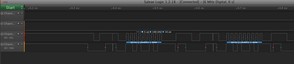

What kind of connections has your Here+ V2. I just read some information on a CUBE forum, that the on board ICM20948 is not directly connected to the external I2C but internal via SPI to an internal STM32F3 micro. Only the compass is emulated as AK09916 for backward compatibility on I2C. So it seems the problem is not on the ESP32 (FC) side but on the Here+ side.
So I think that I cannot solve this.
i will have a look to see if i can find another gps module.

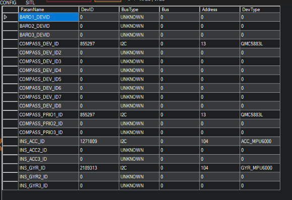

In the meantime I have here a version with MPU6050 and AK09916:
the hglrc 5883 works with the matek h743 without issue
the latest firmware you posted looks like the here+ works, i will test it properly tomorrow.

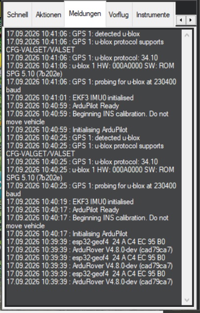

SERIAL3_BAUD = 115;
SERIAL3_PROTOCOL = 5;
GPS_AUTO_CONFIG = 1;
the ESP32 FC detects my Holybro M10 and changed baudrate to 230400 as expected

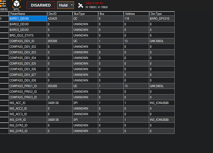

So now I have prepared a new firmware which is looking for
IMU MPU6000 series
COMPASS QMC5883L, QMC5883P, AK09916, IST8310

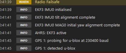

5883 compass is working now but gps is still not detected, its one of the fake ublox modules so i dont know if that is the reason as my genuine M8p works right away.
But the MATEK FC works with the GPS and the ESP doesn’t know anything about GPS handling. It only handles serial and we know it handles the M8p.

The here+ module on esp32 and h743 works both AK09916 compass and the genuine ublox m8p GPS is auto detected.

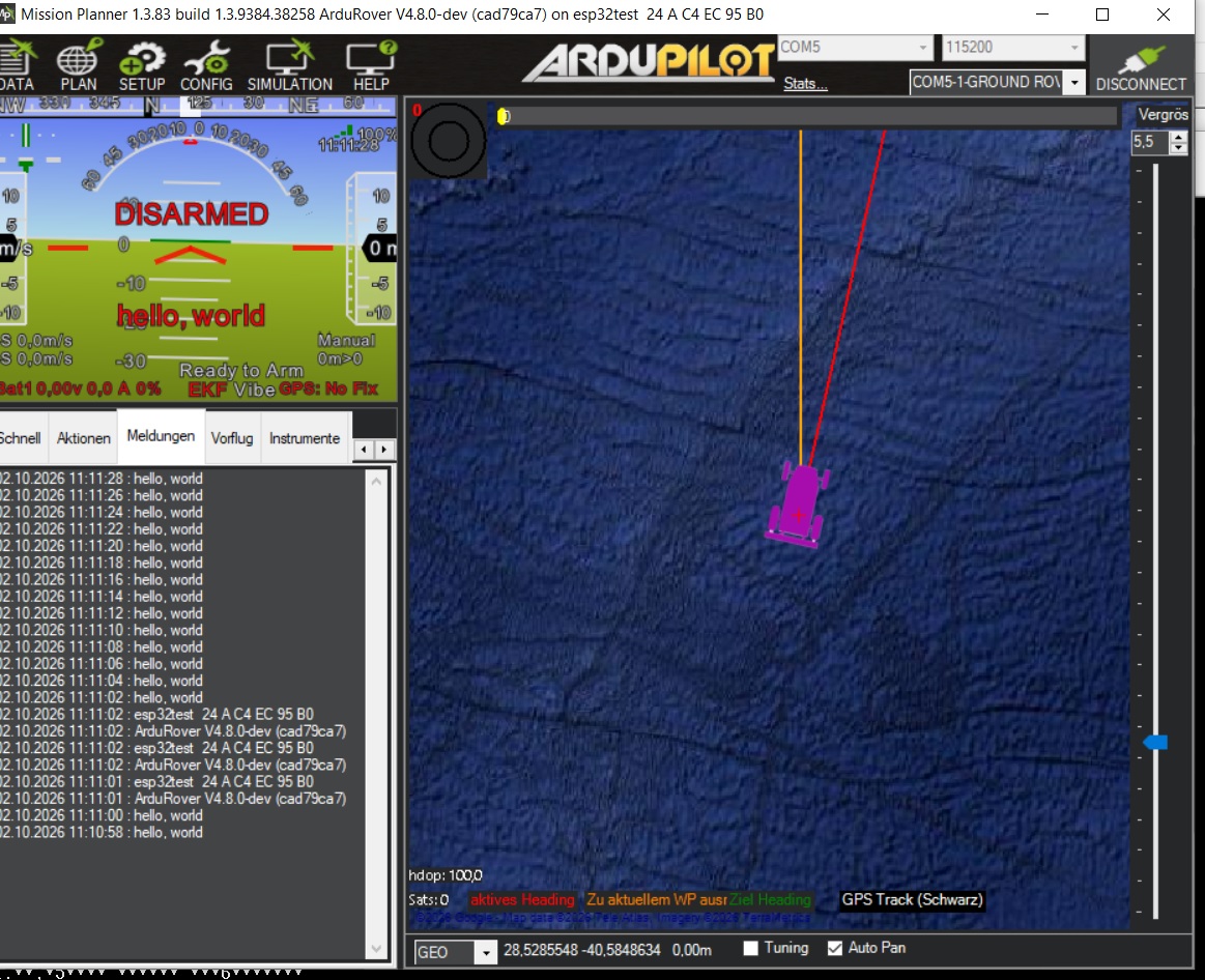

Some good news @geofrancis. I just tested my platform by just switching one SERVO_OUT to GPIO (-1) and assign a RELAY to the assigned ESP32 GPIO pinnumber. For example SERVO2_OUT is assigned to Pin 27. With the mission planner SERVO/RELAY tab I was able to switch now the pin verified by an oszilloscope.
And the best part is that this works not only with the pre-assigned PWM outputs but with any ESP GPIO that isn’t otherwise in use.
For example, I was able to successfully demonstrate this using GPIO 2 as RELAY_PIN 2.
