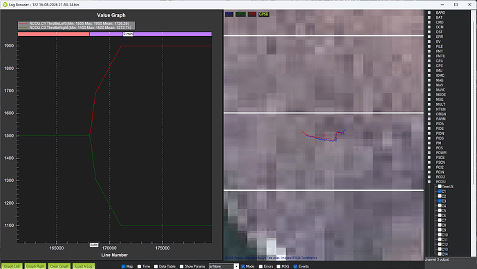

I’m getting the following error in Ardurover messages in the CPP app.
Anyone know how to fix it?
got MISSION_ITEM; GCS should send MISSION_ITEM_INT
Thx

It’s when I send a mission from the app to the pix, nothing happens and looking at the messages I see the above.
Hi @sbbrs,
This is a warning that AP is sending out because we prefer to receive the MISSION_ITEM_INT message because it has slightly better accuracy than the MISSION_ITEM message. This is something that the app developer should fix.
This is a warning though so I don’t think it should stop the mission from being loaded or used. FYI @peterbarker.

Hi @sbbrs,
Not sure how new you are to ArduPilot but of course, after the mission upload the vehicle needs to be put into Auto mode and it also needs a good GPS lock.
An onboard log would be best if possible.
I’m fairly new to ArduPilot, the vehicle was in Auto mode via a 3 position switch on the handset (Auto/Manual/RTL), and I had around 20 sats and a GPS Fix according to the CPP app.
The log files from both the Pixhawk and the Carp Pilot Pro app are here
Hi @sbbrs,
Txs for the logs. A few things I’ve noticed:
  1. Autopilot is using ArduPilot-4.5.0 (ArduRover V4.5.0 (53ad2c2a)). This is quite old so you might as well upgrade to 4.7.0. At least upgrading to 4.5.7 which was the last minor update to 4.5.
  2. The fmuv2 firmware is loaded but the vehicle has 2MB of RAM so the fmuv3 firmware will fit and will provide more features. To upgrade to the fmuv3 firmware you’ll need to specify the board using Mission Planner’s “all options” link or use the custom build server
For some of the logs the vehicle remains in Manual mode but the one starting with 122 the vehicle does switch to Auto mode and it looks like its motor outputs move so I think it’s trying to execute the mission. To me this means that the warning is perhaps being printed but it’s just a warning.
