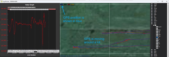

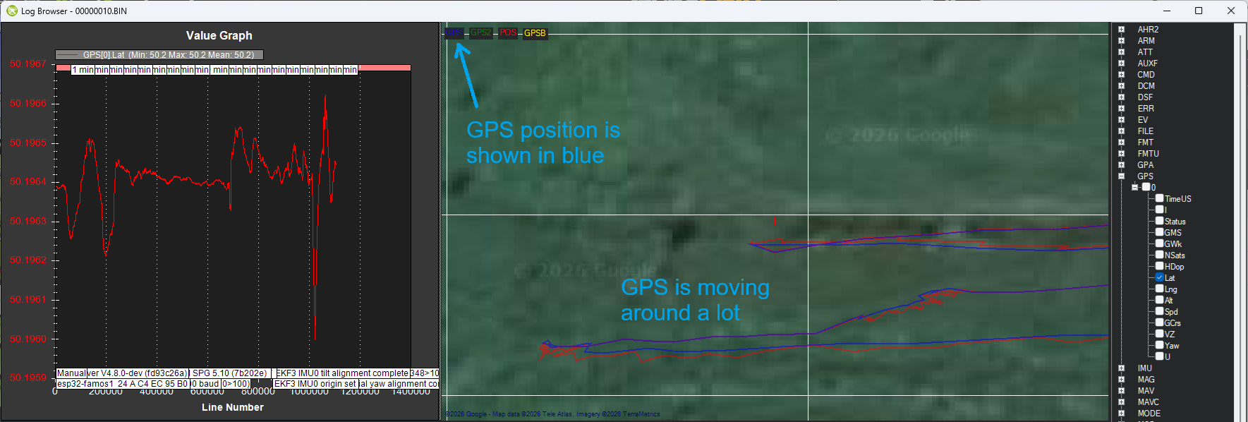

I just tried to produce such a logfile:
The board was this time indoor near to a small window to the west.
Take in account, my ESP32 FC has no baro, so also the hight is taken from GPS and HDOP is poor.
It takes long to get a 3D-Fix and therefore only near to the end of the log you can see AHRS changes between DCM and EKF
I am not sure if this is also represantativ for a “real” FC
Hi @Juergen-Fahlbusch,
Thanks for the log. In this case the issue is the GPS’s reported position is moving around a lot presumably because it’s indoors. This is expected.
I can also see that the AHRS is falling back to DCM which I wouldn’t have expected so I’ll look into that. txs!
Yes, the “moving” GPS is as expected, I specially wanted to do it like this with a poor GPS to show the AHRS fall back to DCM

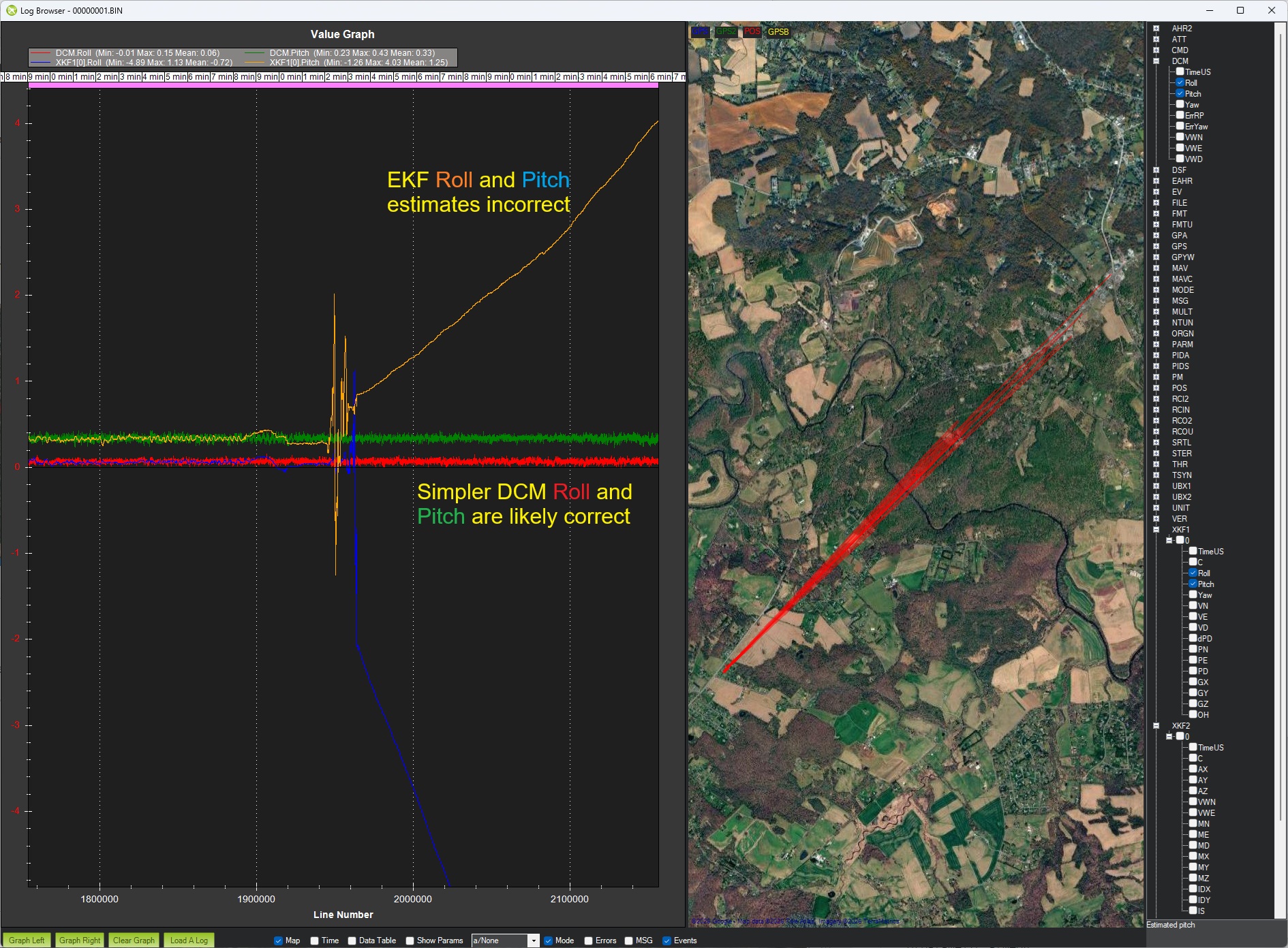

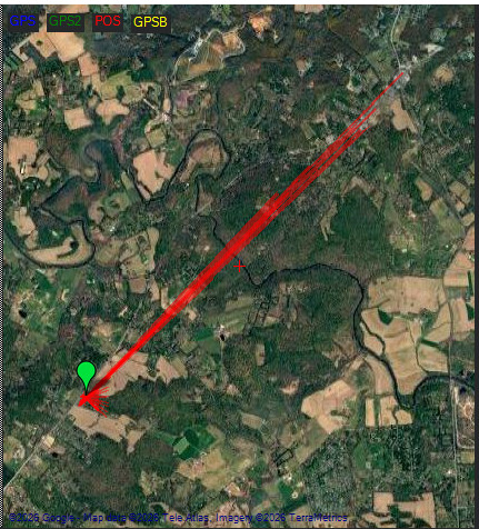

Here is a .BIN file from when this happened today.
It took several hours to develop. Note the position jumps in different radial directions (which gradually rotate) and distances.
Hi @Christopher_Milner,
Thanks very much for the log! This is an interesting log because it’s clear the EKF completely loses its attitude estimate. It’s all fine for a little over 2 hours and then the roll and pitch diverge from reality. The graph below shows the simpler DCM attitude estimate (which is likely correct) vs the EKF estimated attitude.
I suspect this has something to do with GPS-for-yaw being used. I’ll bet that if you set EK3_SRC1_YAW = 3 (GPS with compass fallback) the issue would go away. I’m not saying this is the proper solution of course, just a potential work-around.
I’ll discuss with some of the other devs. txs!
P.S. a replay log would be nice to have bug I also suspect it might be enormous.

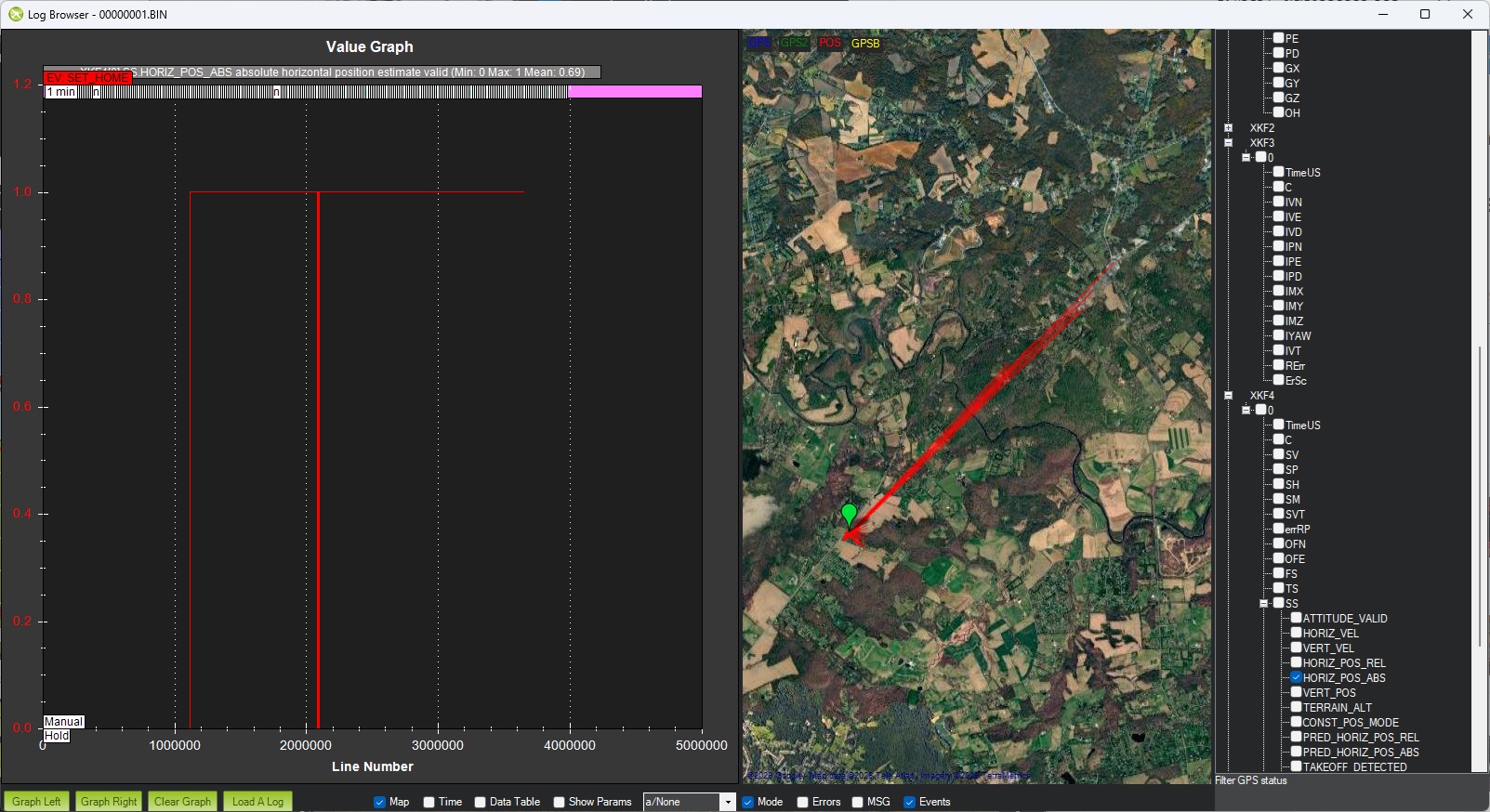

Other times I have seen this occur the EKF flags are all “good”. Our companion computer monitors the EKF flags and I have seen this problem (position jumps) happen at the same time as the companion computer thinks, based on EKF flags, that all is well.
Can you tell from the .BIN file whether the EKF flags indicated a problem?

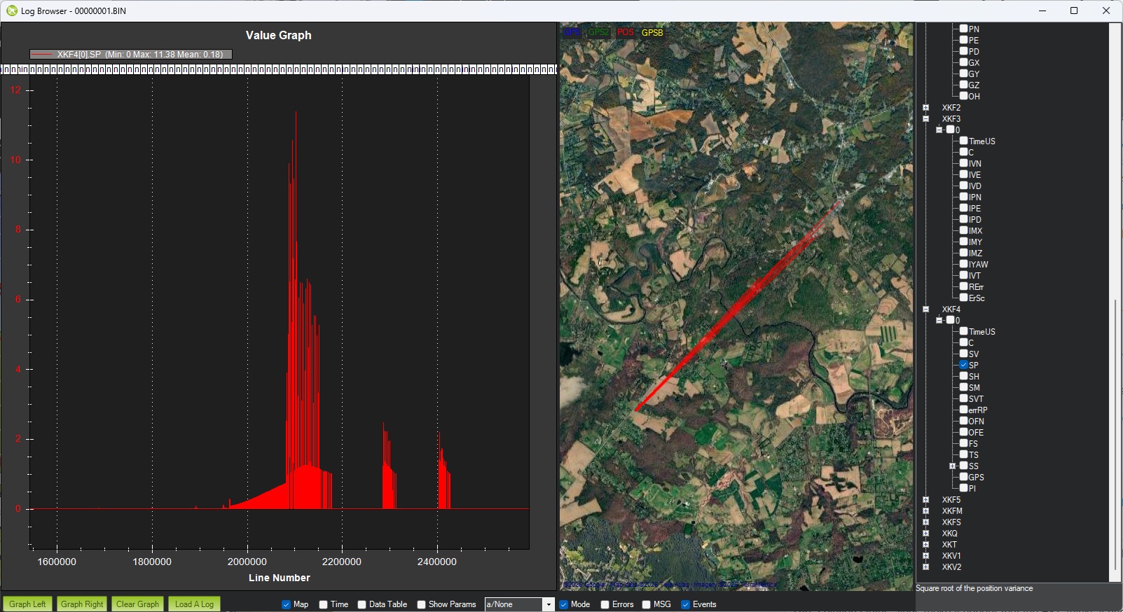

The “solution status” flags make it appear that the EKF thinks it has a position estimate
But looking deeper at the variances it’s clear the EKF is not confident.
Variances over 0.8 will lead to the EKF failsafe triggering and the vehicle stopping (see code here) but again, I’m not saying this is normal or good. Just that we have a check that would stop the vehicle from arming or trying to move autonomously if this happens.
