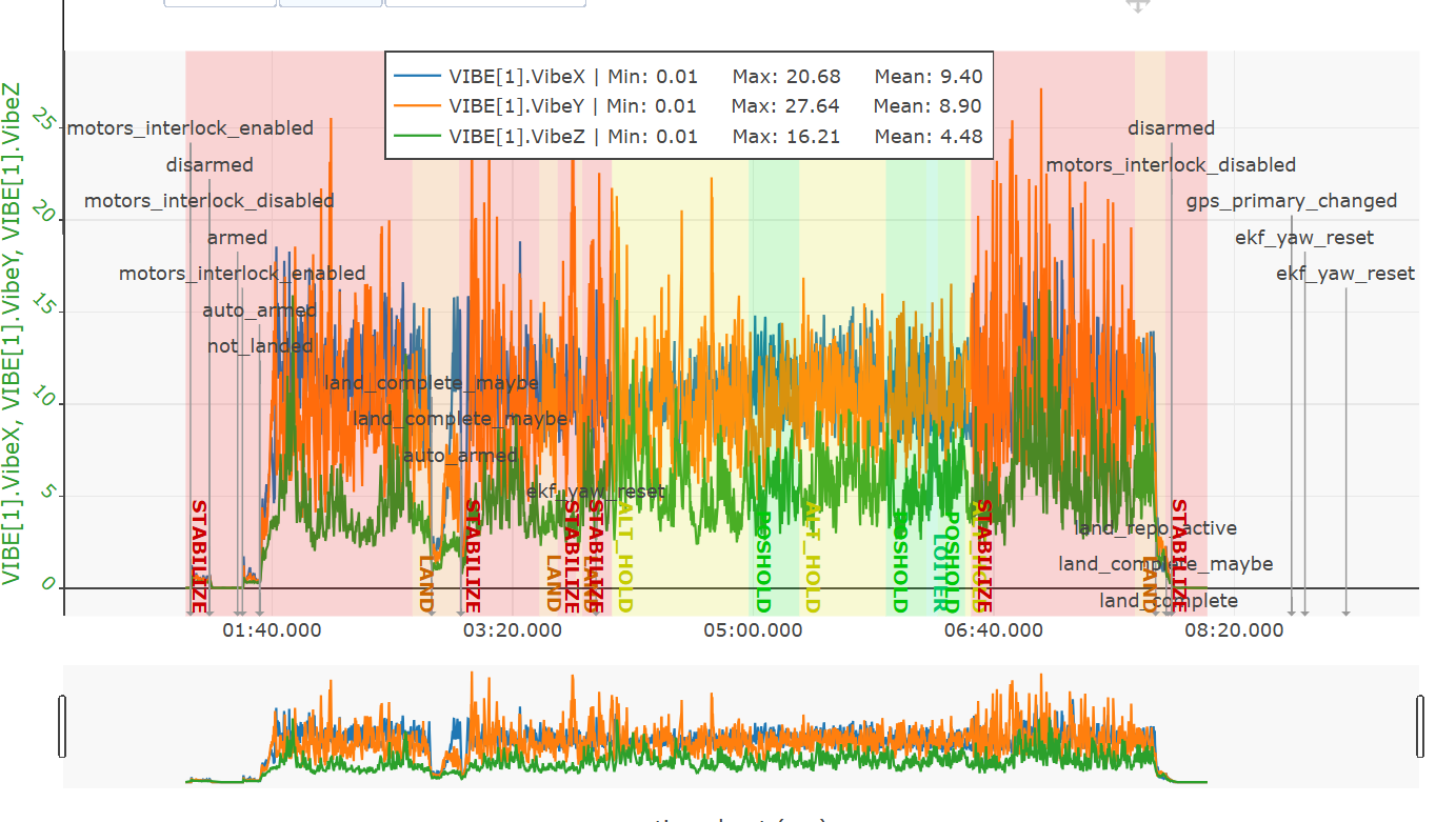

I need your help to solve an issue I got twice with 4.6b4
It’s all about LAND after battery failsafe.
My copter flown away just after FS kicked in.
First time I managed switched it back to Stabilize in RTL phase. So quit fast but it was at about 10m alt. Had some time.
Second time I had not change to act. It was LANDing from just 2m maybe then got power and skyrocket to the nearby tree. Good it was there. In that case RTL was disabled so only LAND could kick-in on critical batt failure.

Hi @Paul_Paku,
The issue is very high vibration levels
It looks like the LOG_BITMASK has been changed so that the CTUN message isn’t displayed which means we can’t easily compare vs the throttle level. Still, it seems that when the RCOU (motor level throttle levels) goes above 60% the vibrations increase dramatically.
We have some advice on the wiki about vibration isolation so hopefully that will help. It’s a frame issue though.
Thank you, will look closer to vibration but I understood values at 20-30 are good.
Right side are a tree hit vibration. Same day I made few landing tests but without batt failsafe, it went good no problems.
Anyway, will look into vibrations.
According to common ArduPilot forum knowledge, and quoting @xfacta:
  • Vibrations over 30 are very bad
  • Vibrations over 20 are causing issues even if you don’t know it yet
  • Vibrations over 15 are in a grey area - it could go either way - check clipping, it must be zero
  • Vibrations below 10 are good
Thanks, do not know where I read 20-30 is ok.
I modified one foam, and looks better and flies much better.
And it lands nicely, what was a point.

Hi @amilcarlucas, @xfacta,
My general advice about Z-axis vibration is:
  • above 60m/s/s there will definitely be problems
  • 30m/s/s ~ 60m/s/s is the grey zone where there may or may not be problems
  • below 30m/s/s normally works
I think the average I see on vehicles is about 15m/s/s.
I definitely would not say that 20 ~ 30m/s/s of vibration is “good”
I think vibrations in the X and Y axis actually need to be much lower than in the Z-axis. So 30m/s/s in the X/Y axis is definitely not acceptable. The limit is more like 15m/s/s max in X, Y I think.

Guys,
Here I posted the failed Autotune graphs.
With those vibs copter do fly quite well but can’t pass autotune.
Therefore, at least for my very old build, it seems to be on the edge, as I understand the situation.
With high vibration levels Autotune failed on Roll - ArduCopter - ArduPilot Discourse
Or here are last flight vibs. Again, very old build using SimonK loaded ESCs and crash tested propellers. Once it will be safe to install better props vibs will go down for sure.
So the limits you mentions are not to low even for poor builds.
With @randyV advice I replaced just one foam. That’s it. It’s not so complicated to go down by 10-15 points.
