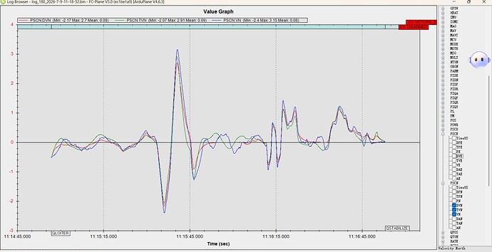

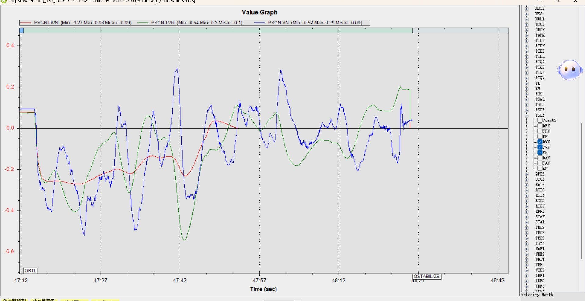

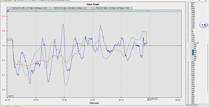

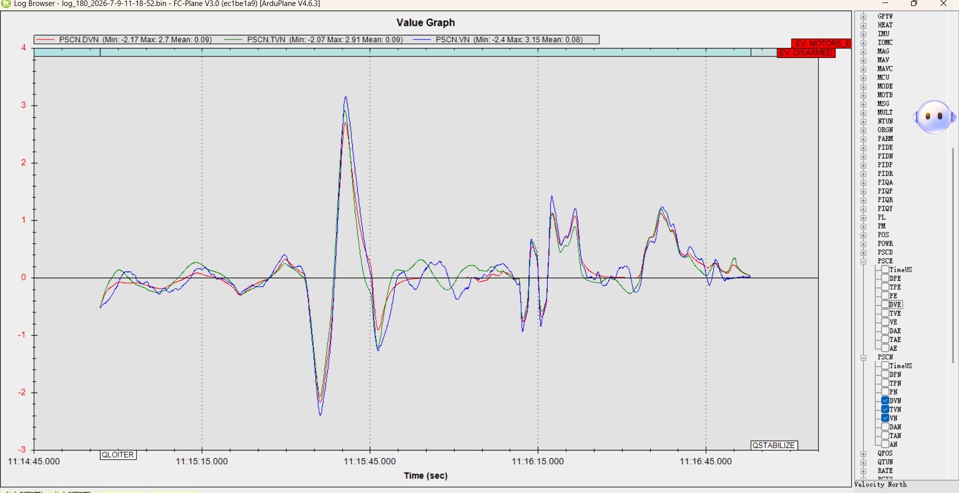

My vertical takeoff and landing drone had poor landing accuracy during the qrtl phase. Even though I used RTK to indicate GPS accuracy, the drone still had an error of about 30cm or even less than 20cm. I don’t know if this is correct. I think it’s because of the PID problem with my position control, but when I adjusted the PID of the position control in qloiter, I found that its position control is still good, but qrtl is not very ideal. Are these two positions controlled differently during vertical landing. https://drive.google.com/file/d/1GuA9kDD8Fhpfbz_z99NC3N0QpikfZVTr/view?usp=drive_linkhttps://drive.google.com/file/d/1H-hEE-273AKp1AssVtWQEi7VfhGytlOs/view?usp=drive_link 169 is a test conducted by my qloiter, and 196 is a test under auto. It is evident that the position is being adjusted back and forth

What mode should I adjust? The two position control curves in the picture have the same parameters and were flown by the same aircraft. So I’m a bit confused, why is there so much difference. I don’t even know how to adjust the direction
I don’t know which flight mode to adjust in. The data curves in the two pictures above are from the same aircraft with the same parameters, but I don’t know why there are so many differences, which makes me confused about how to adjust.

I have changed it to 200, which actually looks much better, but from the data, there is basically no change. I don’t know how to adjust the PID in the position. The landing error of the drone gradually increases every time it is about 1 meter off the ground
