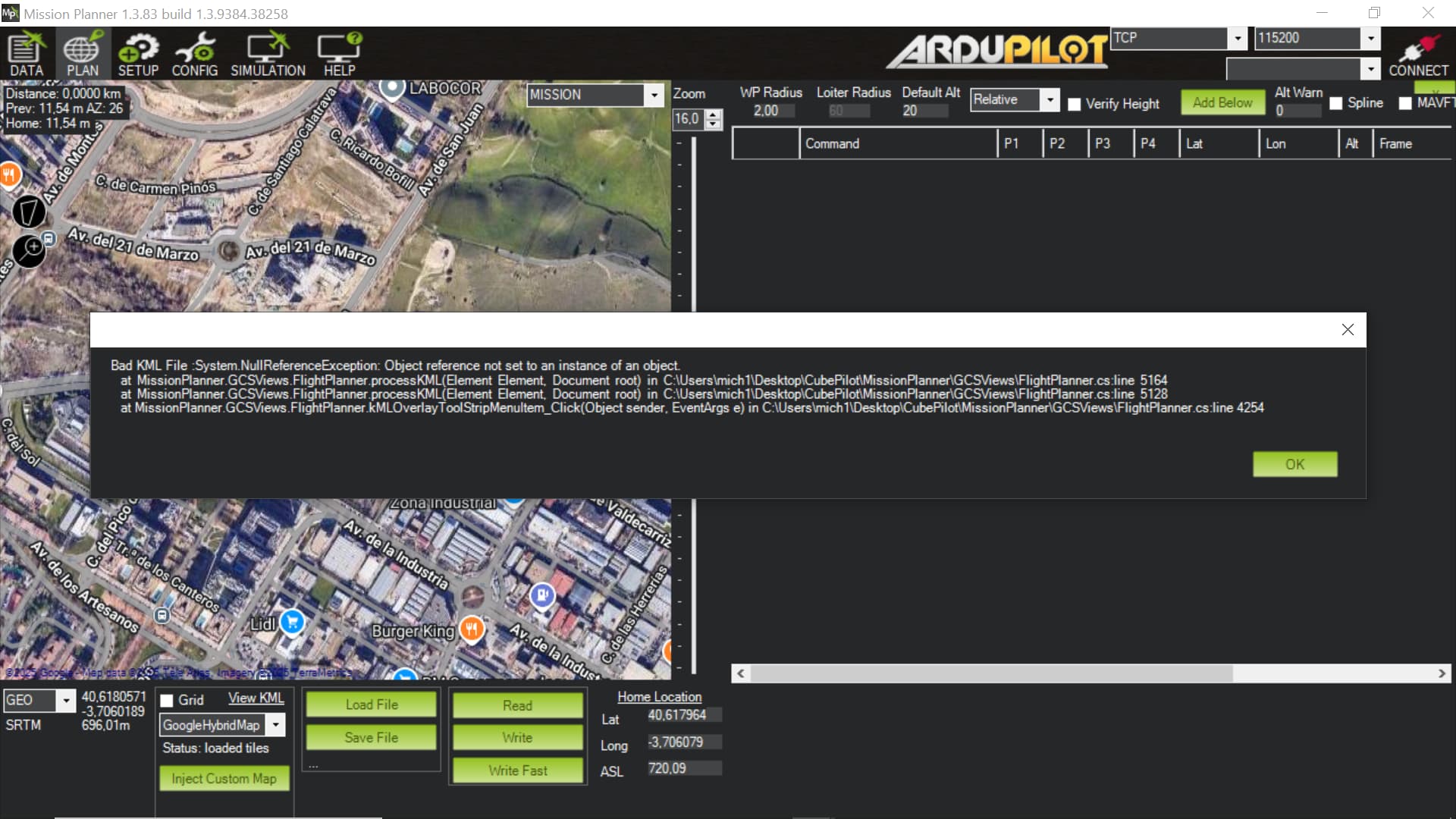

When I try to use a KML file in version 1.3.83, I get this error.
However, if I use version 1.3.81, it works correctly.

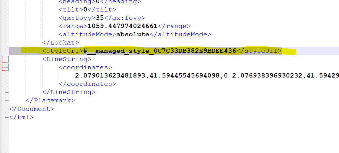

  2. Share your KML so we can check how it is malformed.

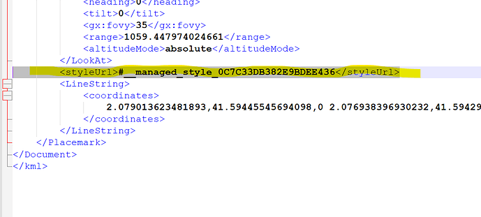

It seems that multi level styles are not handled by MP (yet).
As a quick fix, remove the style from your kml, by deleting the highlighted line.

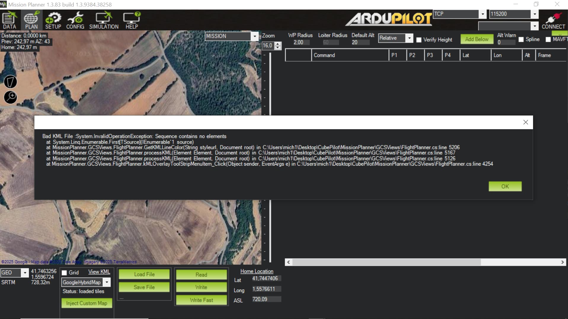

I remove the style url but the error continue.

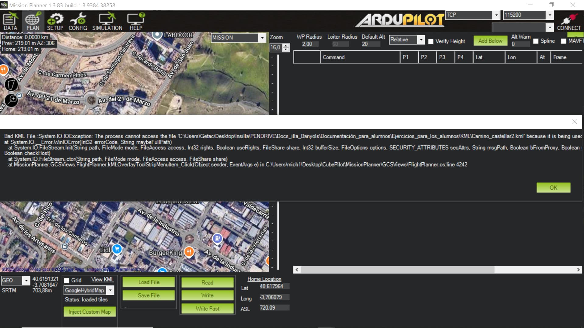

File is still open in editor… close editor and try again
