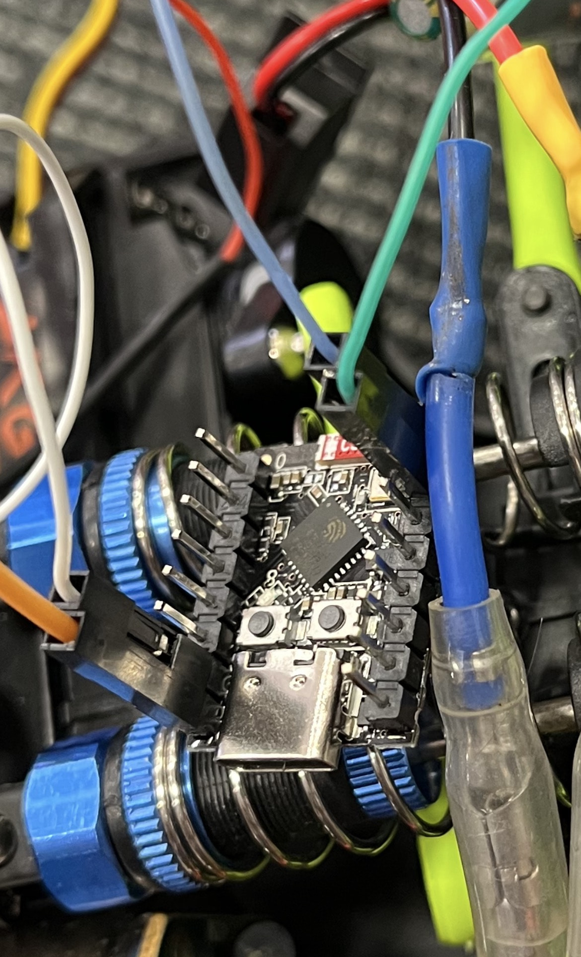

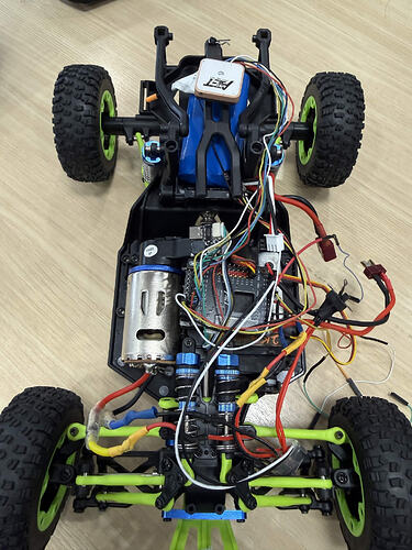

I’ve now loaded the firmware onto the ESP32 and can connect it to the FC via a wired connection. However, the Mission Planner isn’t detecting data from the GPU and IMU—it’s only detecting the heartbeat. If anyone knows the cause, please let me know. The pins I’ve connected on the ESP32 are as shown in the image. I’m using serial port 1.
If any additional data is needed, I’ll attach it
