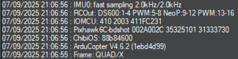

Rounding this off with my final setup and parameter file.
Screenshot below displays my PWM setup, my firmware version, and other details.
  • I re-upgraded to copter 4.6.2-bdshot firmware
  • I switched the motor control back to the ‘main’ I/O PWM outputs because the neopixels in the arms can’t be controlled by these outputs as far as I can tell, so I now have LEDs on AUX/FMU, and the Motors on I/O.
  • I consequently set BRD_IO_DSHOT, 0->1
  • I have set BRD_SAFETY_DEFLT, 0 to disable the safety switch as the temporary solution to this problem
  • I am using BDshot600 as per the conversation above to avoid Dshot1200
Final (for now) full parameter set is linked below in case anyone is curious.

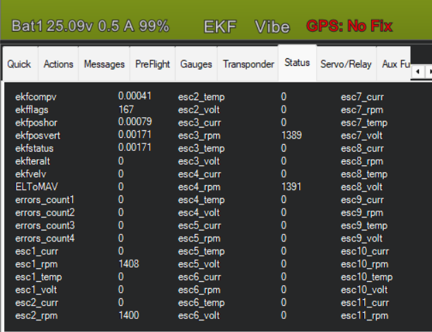

And below is verification that I am seeing RPM feedback for all four ESCs.

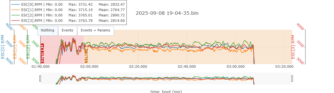

I took the platform out flying yesterday. The logs show good RPM feedback data, and the values match up well with the detected peaks in the vibration logs too which is promising.
At one point I performed a ‘soft’ reset of the flight controller (via mission planner ‘reboot’ button) and all my flights after this point logged no ESC data, and I noticed this at the end of my testing session yesterday that the ESC feedback was not showing up in the status tab.
I’ve just recreated this on the bench too. I verified good rpm feedback, then did a ‘soft’ reboot of the flight controller, and the telemetry stopped coming through. I then did a ‘hard’ reboot by disconnecting the battery and plugging it back in again, and the telemetry was back. It looks like for some reason the flight controller stops reading the telemetry when soft rebooted via the mission planner interface… Good to know!

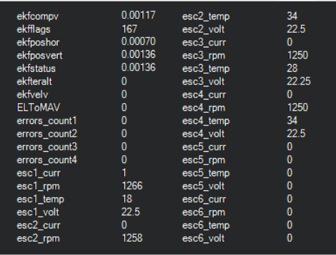

I switched SERVO_DSHOT_ESC,3 and now I am getting voltage and temp data. The current never comes - the Tekko32 page says the unit is capable of current measurement so I wonder whats stopping the data coming through.
Voltages look good, temperatures are a bit confusing to me though, I don’t know why ESC1 is reading so much lower than 2, 3, 4.
