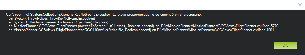

When in Mission Planner reading (MP->PLAN->Load WP file) this very simple mission:
QGC WPL 110
0	1	0	16	0	0	0	0	40.1	-3.1	630.22	1
1	0	3	16	0	0	0	0	40.099994	-3.100006	0	1
2	0	3	194	0	0	0	0	0	0	0	1
3	0	3	16	0	0	0	0	40.099986	-3.100019	0	1
4	0	3	194	1	0	0	0	0	0	0	1
5	0	0	177	1	-1	0	0	0	0	0	1
6	0	3	21	0	0	0	0	40.1	-3.10001	0	1

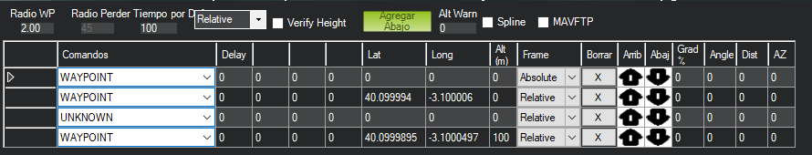

which I have used extensively in the past, this happens:
MP 1.3.82 build 1.3.9228.10685 (also on 1.3.9195.11771 but not on 1.3.80).
If writing above waypoints with 1.3.80 and reading with 1.3.9228.10685:
Certainly, 194 may not have sense in some vehicles, but I see above error when not connected and when connected to a balance bot.

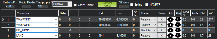

It’s the LAND command that is giving you trouble. WP 6 is MAV_CMD_NAV_LAND (21). Remove it, and your mission should work fine.
Removing the 194’s and maintaining the 21:
QGC WPL 110
2	0	3	16	0	0	0	0	40.099986	-3.100019	0	1
3	0	0	177	1	-1	0	0	0	0	0	1
4	0	3	21	0	0	0	0	40.1	-3.10001	0	1
it is loaded perfectly:
Removing only the 21 the same happens.
(So I assume that MAV_CMD_DO_SET_REVERSE (194) has not been removed and is still supported).
Removing 21 did the trick for me. Not sure how else to help. DO_REVERSE is still supported.

Initially I saw this error unconnected, so I also tried on a connected balance bot (in which clearly 194 makes sense) and the same error appeared. I have tried on two different laptops, one with 1.3.9228.10685 and other with 1.3.9195.11771: same error.
So I tried on a third laptop (unmaintained Windows 7) with a very old 1.3.80 and all was fine. Writing the mission on a Copter with it (all normal), and reading it on laptop with 1.3.9195.11771 the “UNKNOWN” appeared (I suppose the same for the other with 1.3.9195.11771).
All above with MP on Windows 10. I can try on Ubuntu and Mac, but I think the error is unrelated with OS. I cannot locate when this error started to appear.

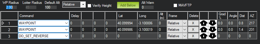

I’ve taken a Rover balance bot, connected (UDP), loaded:
QGC WPL 110
3	0	3	194	1	0	0	0	0	0	0	1
and the same:

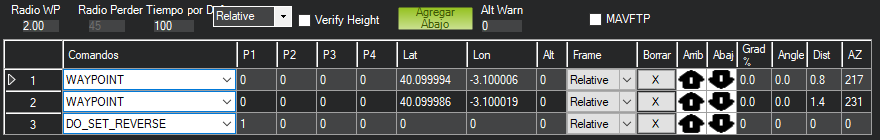

So again slowly:
  1. Config->Planner->UI Language: English.
  2. Restart MP as requested.
  3. Load:
QGC WPL 110
5. Config->Planner->UI Language: Spanish
6. Restart MP as requested.
7. Load:
QGC WPL 110
9. Repeat on the other failing laptop: failure in spanish, change to english, restart, load same with one 194 and no 21: success, change to spanish, restart, load same with one 194 and no 21: success.
So changing language and back does some kind of magic. Go figure.
