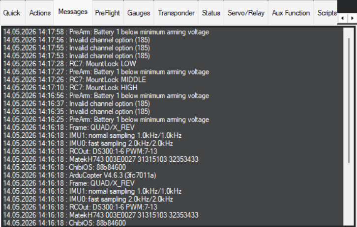

I am using a copter with ArduPilot and a Caddx GM3 gimbal.

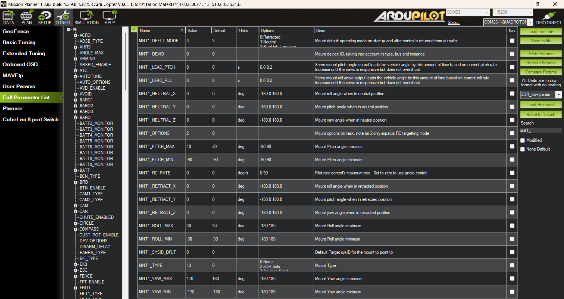

I configured the gimbal according to the ArduPilot documentation CADDX Gimbals — Copter documentation
Most functions are working correctly, including yaw lock mode. However, I cannot configure pitch/roll lock using channel option 185.
When I assign RC7 option 163 (YAW Lock) it works, but when I change RC7 option to 185 (“Mount RP Lock”), ArduPilot shows the error:
“Invalid channel option (185)”
Details:
  • Flight controller MatekH743-slim, firmware: ArduPilot Copter v4.6.3
  • Gimbal: Caddx GM3 firmware v4.8
  • Yaw lock works correctly
  • Pitch/roll lock option 185 is rejected as invalid
Gimbal configuration:

The Mount RP Lock was added for the 4.7 release, it is not in 4.6.
Is it still invalid after updating to 4.7 beta 4 firmware?
I have updated to 4.7 beta 4 firmware and it works!
Thank you so much for your help!
