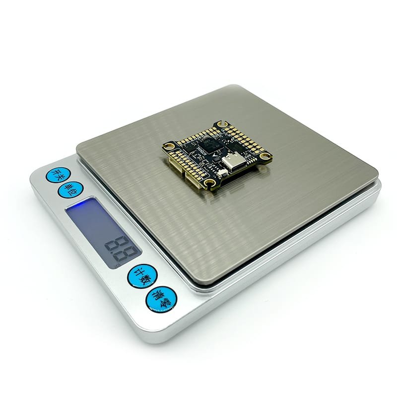

  4. Stay small and light: 37x37mm, 8.8g, standard 30.5x30.5mm mounting

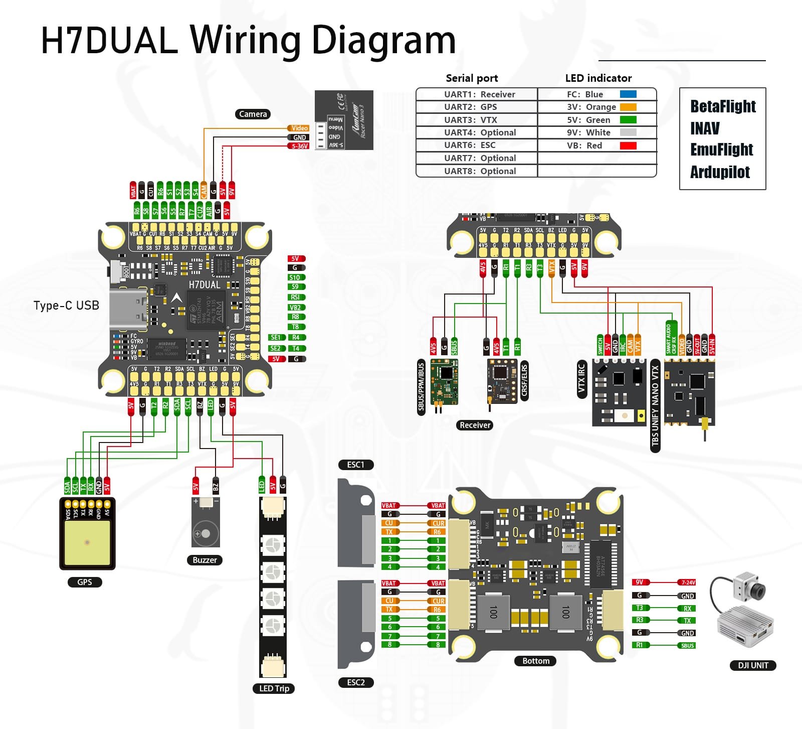

Power — direct 3-6S input, two regulated output rails (5V/2A and 5.9V/3A). One rail powers the flight controller and receiver-class peripherals, the beefier rail is sized for video gear. The wiring diagram below shows the recommended split.

Wiring
The wiring diagram is the single most useful document we publish for this board — every pad, port and power rail is on it. The default UART assignments are:
Port Default assignment
UART1 Receiver
UART2 GPS
UART3 VTX
UART4 Free
UART6 4-in-1 ESC
UART7 / UART8 Free
[IMAGE 3]
Both digital (DJI-class) and analog video links are shown as options on the diagram, so the same board serves an HD build or a cheap analog rig without rewiring the stack. There are three USER pads on the layout: one for the onboard Bluetooth enable switch, one for camera-input switching when you run more than one camera, and one general-purpose IO. The LED status behaviour table is printed on the diagram as well, so field diagnosis doesn’t require a laptop.

Apologies for the “IMAGE” placeholders in the original post — the images were lost on paste. Uploading them here: the PCB board view, the wiring diagram, and the board weight photo referenced in the walkthrough above.
