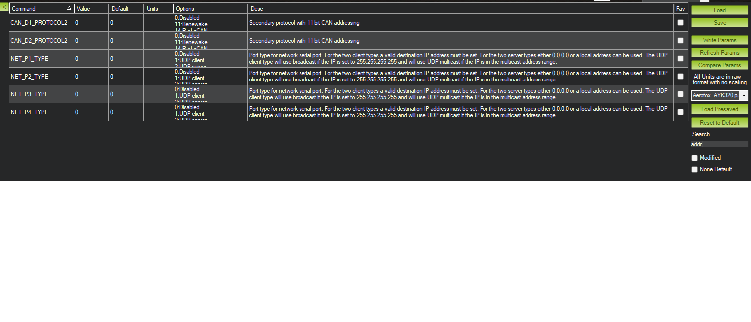

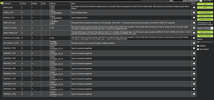

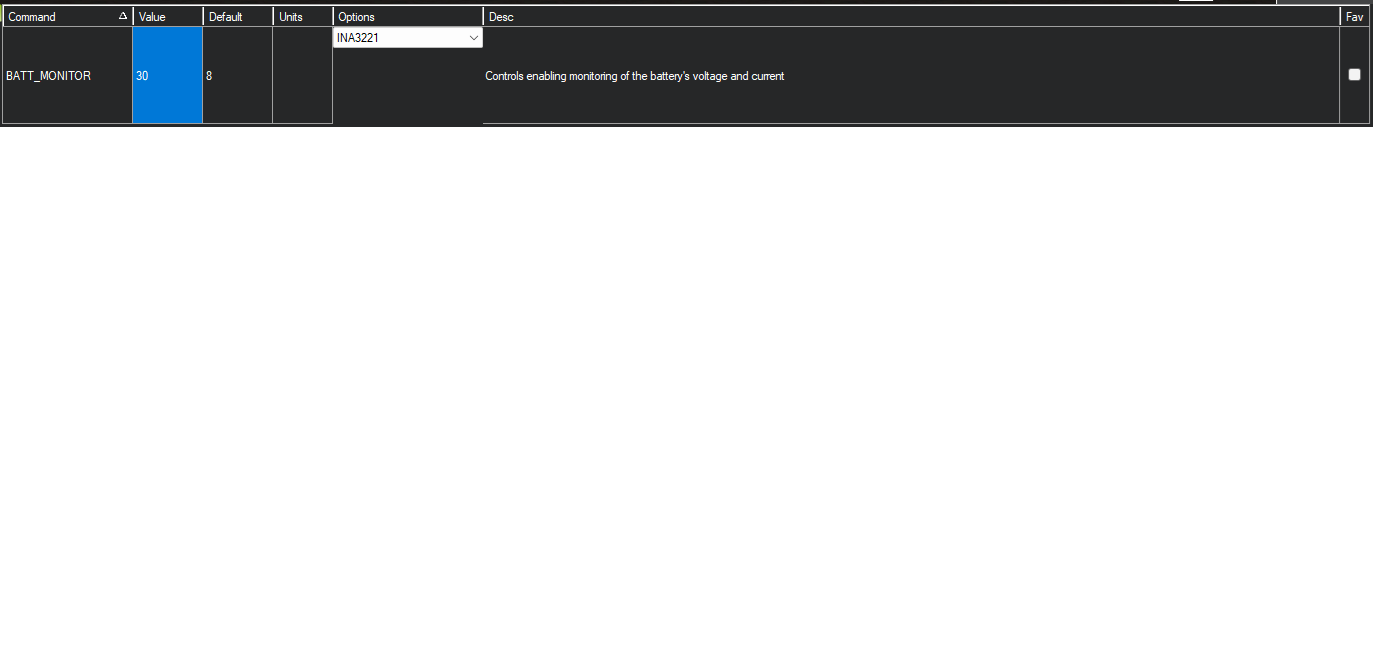

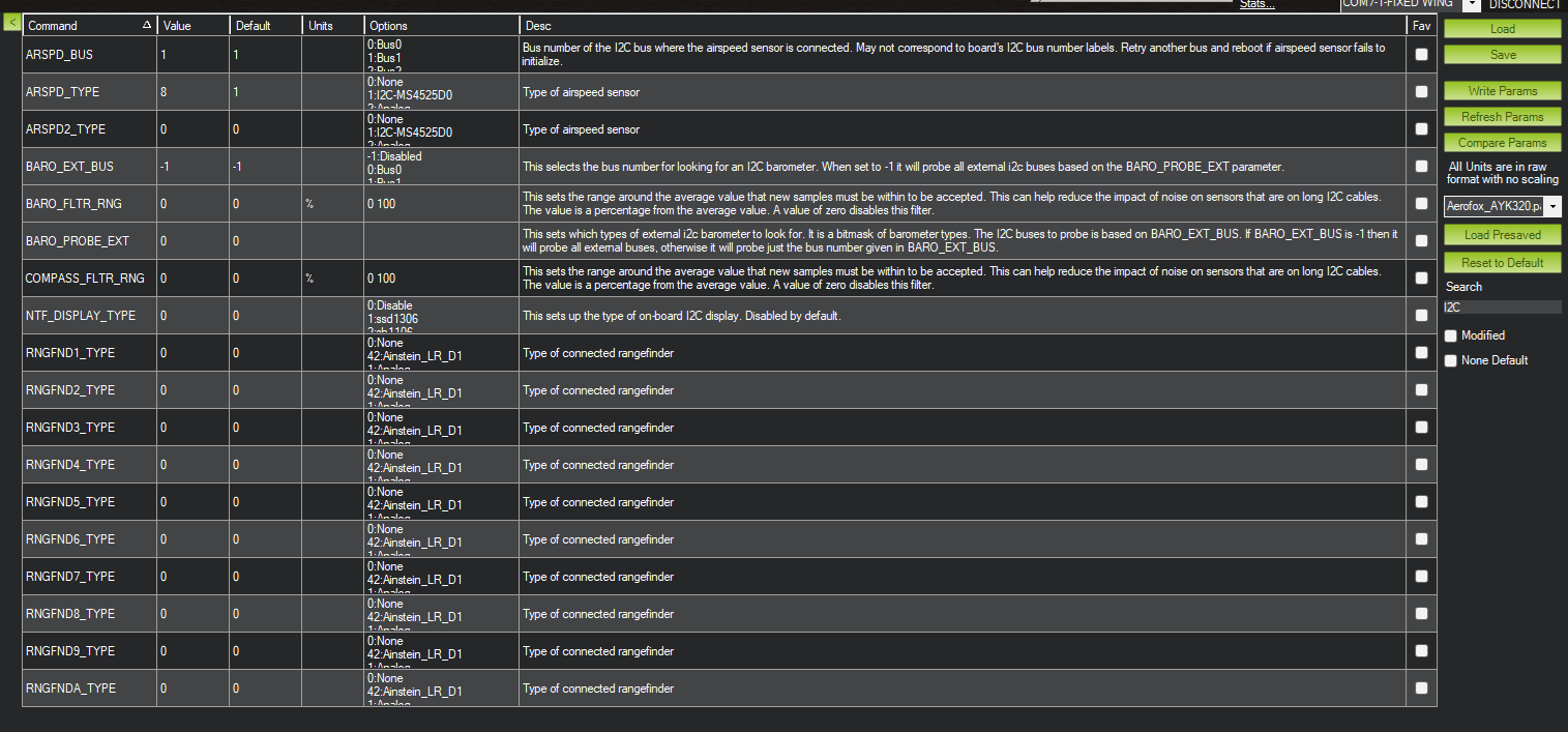

Thank you for your response! I tried looking for the parameters you mentioned, but I could only find one:
  • BATT_MONITOR (set to 30 for INA3221)
The other parameters and BATT_MON_ADDR
don’t appear in my parameter list, as you can see in the attached screenshots, I tiped them in the search bar.

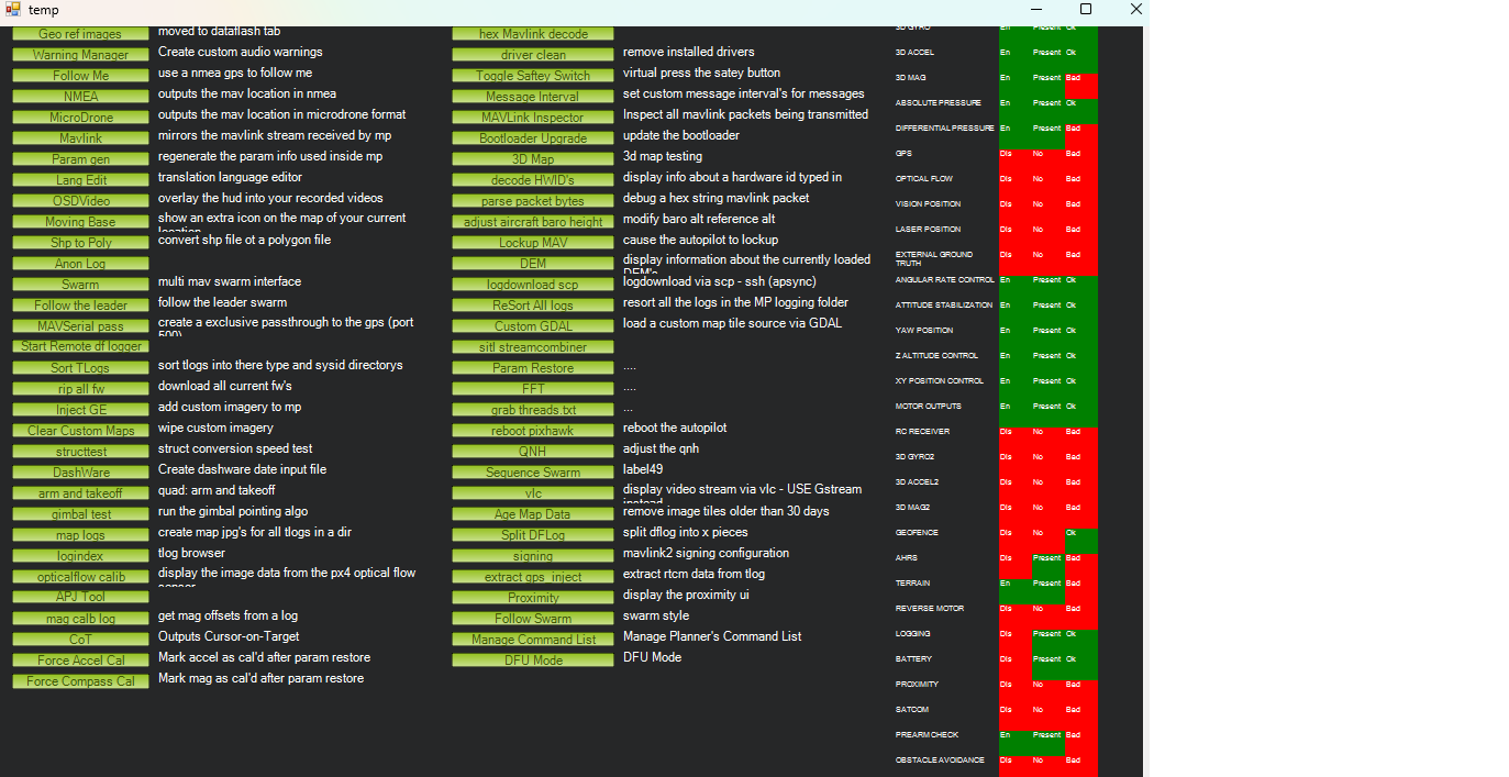

Regarding the script, I’m unsure how to execute it—I can’t access the scripting console in Mission Planner (the option seems unavailable). Any guidance would be greatly appreciated!

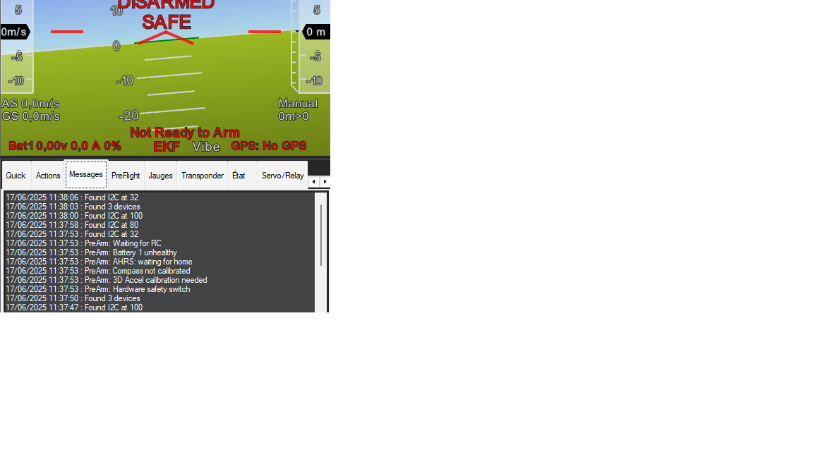

Hi there,
For the scripting part, I found 3 addresses none of them are the INA3221’s 0x40, as you can see in the screenshot. Any guidance would be greatly appreciated!
Thanks again!
I don’t recall capability to use serial as I2C port. Use I2C port instead.
