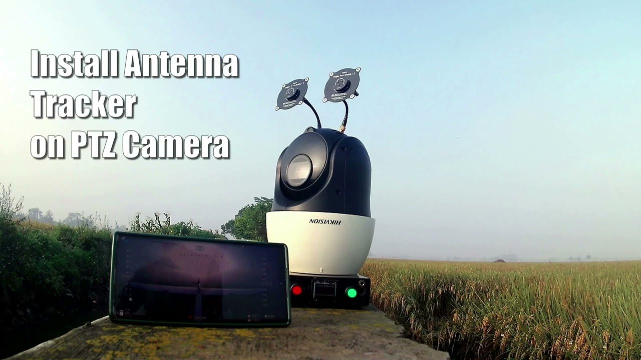

Install Antenna Tracker on PTZ Camera (Hikvision)
Mostly PTZ Camera have API or at least Onvif Support on their system, so i have an idea to put the AAT inside the PTZ Camera, and Convert the AUX for the Servo into API to moving the PTZ
What Inside
Yes, I use Esp32 to translate the PWM OUT from FC into API
The API what we need bassically only two: PAN and TILT
curl -X PUT --data-raw '<PTZData><pan>VALUE</pan></PTZData>' -H Expect: http://a:b@c/ISAPI/PTZCtrl/channels/1/Continuous
a = User Name (Must Administrator)
b = Password
c = IP Address of the PTZ Camera
Example:
Pan right
curl -X PUT --data-raw '<PTZData><pan>30</pan></PTZData>' -H Expect: http://admin:kora1234@192.168.1.100/ISAPI/PTZCtrl/channels/1/Continuous
Pan left
curl -X PUT --data-raw '<PTZData><pan>-30</pan></PTZData>' -H Expect: http://admin:kora1234@192.168.1.100/ISAPI/PTZCtrl/channels/1/Continuous
Stop Pan Movement
curl -X PUT --data-raw '<PTZData><pan>0</pan></PTZData>' -H Expect: http://admin:kora1234@192.168.1.100/ISAPI/PTZCtrl/channels/1/Continuous
Tilt up
curl -X PUT --data-raw '<PTZData><tilt>30</tilt></PTZData>' -H Expect: http://admin:kora1234@192.168.1.100/ISAPI/PTZCtrl/channels/1/Continuous
Tilt Down
curl -X PUT --data-raw '<PTZData><tilt>-30</tilt></PTZData>' -H Expect: http://admin:kora1234@192.168.1.100/ISAPI/PTZCtrl/channels/1/Continuous
Stop Tilt Movement
curl -X PUT --data-raw '<PTZData><tilt>0</tilt></PTZData>' -H Expect: http://admin:kora1234@192.168.1.100/ISAPI/PTZCtrl/channels/1/Continuous
Combining Together
Pan Right + Tilt up
curl -X PUT --data-raw '<PTZData><pan>30</pan><tilt>30</tilt></PTZData>' -H Expect: http://admin:kora1234@192.168.1.100/ISAPI/PTZCtrl/channels/1/Continuous
Pan left + Tilt Down
curl -X PUT --data-raw '<PTZData><pan>-30</pan><tilt>30</tilt></PTZData>' -H Expect: http://admin:kora1234@192.168.1.100/ISAPI/PTZCtrl/channels/1/Continuous
Stop Pan+Tilt Movement
curl -X PUT --data-raw '<PTZData><pan>0</pan><tilt>0</tilt></PTZData>' -H Expect: http://admin:kora1234@192.168.1.100/ISAPI/PTZCtrl/channels/1/Continuous
For Stop, we can give both 0 to stop all movement or to specific such as Pan only and leave the tilt still moving
Result so far
Gentlemen, this thread still develop i create this time because my time are so limited, so i will continue on another my free of time
Later fix:
Seems ZOOM is useless, because when we ZOOM IN into the sky the camera won’t focus, so better I will use ZOOM for other reasons
Compass is not supposed to put on DOME, because Compass must always be HORIZON, the compass seems a little bit glitch when the DOME goes up more than 45 degrees
ILLUSTRATION

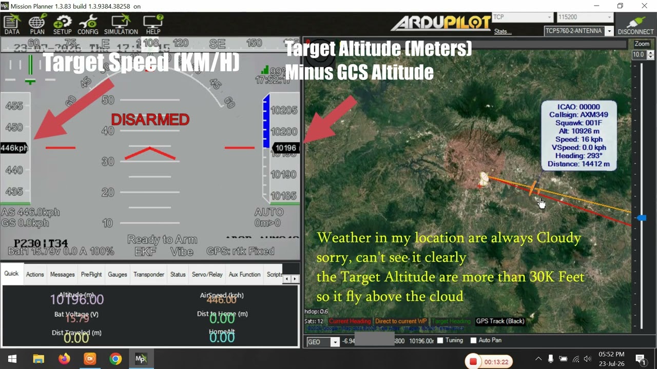

V2 Ardutracker to Tracking an airPlane
what we need
RTL-SDR
Careful of the many fake products. I’ve tried the cheaper ones, and the difference the power maximum only 19dBm and the sensitivity was also very poor.
So be sure to read this link to know which is real and which is fake.
https://www.rtl-sdr.com/genuine
and install dump1090 to decrypt the adsb encryption from here
just follow what they said
after you succeed and loading the dump1090, the port which human can read only at 30003 (you can telnet that port and see it by your self)
so let’s make it more compact
remove previously dump1090 with
make clean
and then replave the net_io.c with the file mod by me (attached)
or you can edit and make some change with it as you needed
and then
make
and load
dump1090 --metric --gain 29.7 --net --quiet
after that if you check again the port 30003 will generate
ICAO_ID|CALLSIGN|LATITUDE|LONGITUDE|ALTITUDE|HEADING|GROUNDSPEED
enough for us to send that data to MAVPROXY as ADSB data
one more script we need to add adsb streaming into mavproxy
load the python script (file attached)
and don’t forget to add this paramater to your running mavproxy
Ps: that’s only the basic how to add adsb data from SDR to MAVPROXY, and that are what i can share with you all, because in real i’m not using this way (mine are a bit complex) so i made simple for you and try to start modifying by your self
and this is the result
