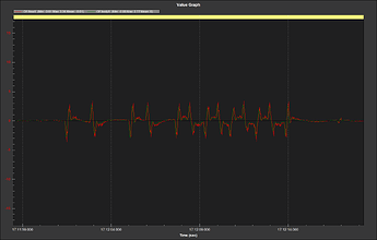

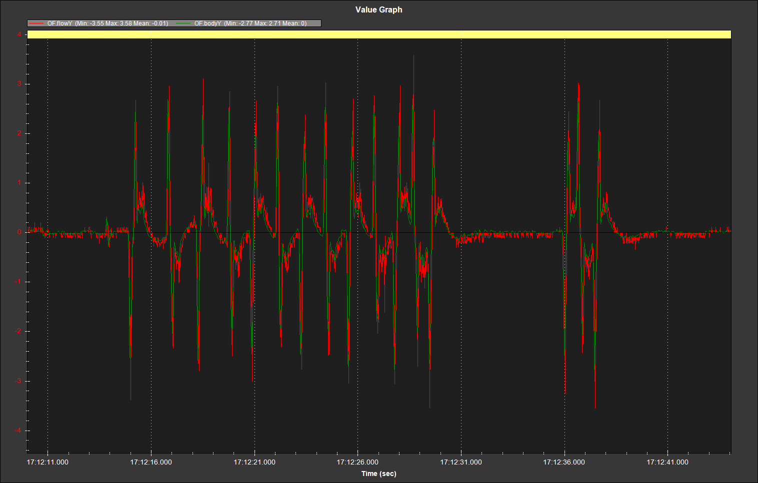

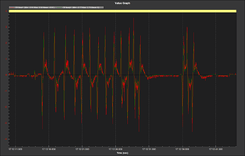

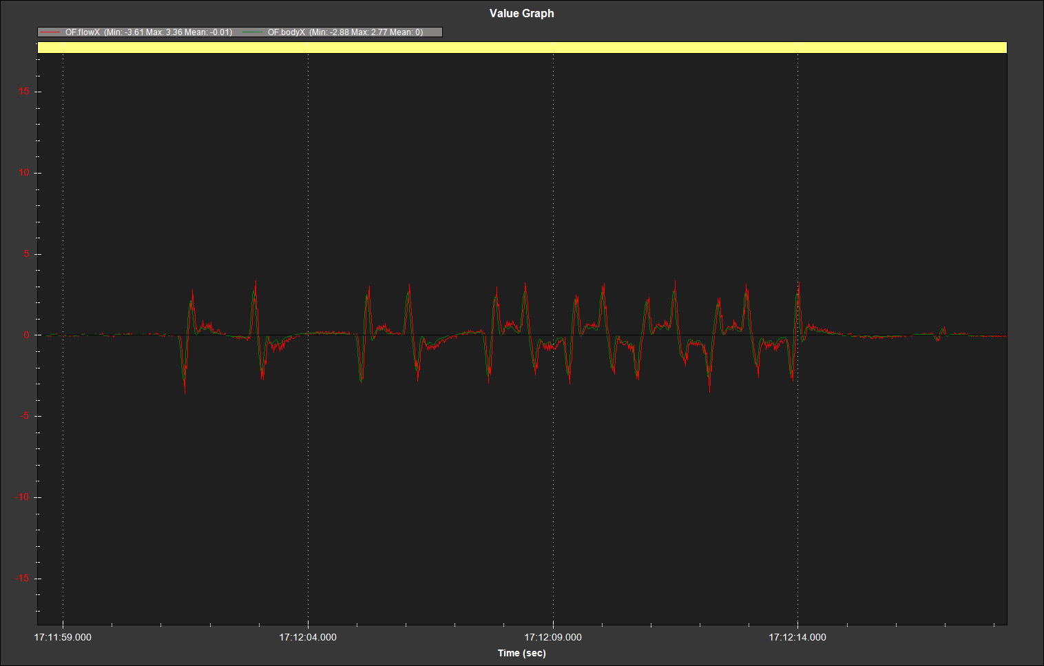

Unable to get a Scalar for Micoair MTF-02P during optical flow in-flight calibration. Attempted twice, and the result is the same. Why? Is it normal? In my experience with other optical flow sensors and with older Arducopter, scalars are always needed.
Offset forward by 7 cm.
Arducopter 4.6.3
FCU: MicoAir MicoAir743v2-AIO-45A
145679	15/9/2026 17:11	MSG	126447485	FlowCal: Started
145696	15/9/2026 17:11	MSG	126449603	FlowCal: x:0% y:0%
161767	15/9/2026 17:11	MSG	129454550	FlowCal: x:14% y:0%
177768	15/9/2026 17:11	MSG	132457141	FlowCal: x:14% y:0%
193779	15/9/2026 17:11	MSG	135462093	FlowCal: x:14% y:0%
209797	15/9/2026 17:11	MSG	138467143	FlowCal: x:14% y:0%
225805	15/9/2026 17:11	MSG	141472372	FlowCal: x:14% y:0%
241822	15/9/2026 17:11	MSG	144477084	FlowCal: x:14% y:0%
257834	15/9/2026 17:11	MSG	147482106	FlowCal: x:14% y:0%
273845	15/9/2026 17:11	MSG	150487130	FlowCal: x:14% y:0%
289836	15/9/2026 17:11	MSG	153488570	FlowCal: x:14% y:0%
305867	15/9/2026 17:11	MSG	156492094	FlowCal: x:14% y:0%
321884	15/9/2026 17:11	MSG	159498546	FlowCal: x:14% y:0%
337901	15/9/2026 17:12	MSG	162502030	FlowCal: x:20% y:0%
353936	15/9/2026 17:12	MSG	165507553	FlowCal: x:46% y:0%
369961	15/9/2026 17:12	MSG	168512045	FlowCal: x:68% y:0%
386005	15/9/2026 17:12	MSG	171517323	FlowCal: x:100% y:0%
402036	15/9/2026 17:12	MSG	174522086	FlowCal: x:100% y:0%
418067	15/9/2026 17:12	MSG	177527411	FlowCal: x:100% y:18%
434100	15/9/2026 17:12	MSG	180532865	FlowCal: x:100% y:48%
450167	15/9/2026 17:12	MSG	183537038	FlowCal: x:100% y:92%
454582	15/9/2026 17:12	MSG	184362442	FlowCal: samples collected
454583	15/9/2026 17:12	MSG	184362480	FlowCal: scalarx:0.000 fit:0.552 too high (>0.5)
454584	15/9/2026 17:12	MSG	184362559	FlowCal: scalary:0.000 fit:0.694 too high (>0.5)

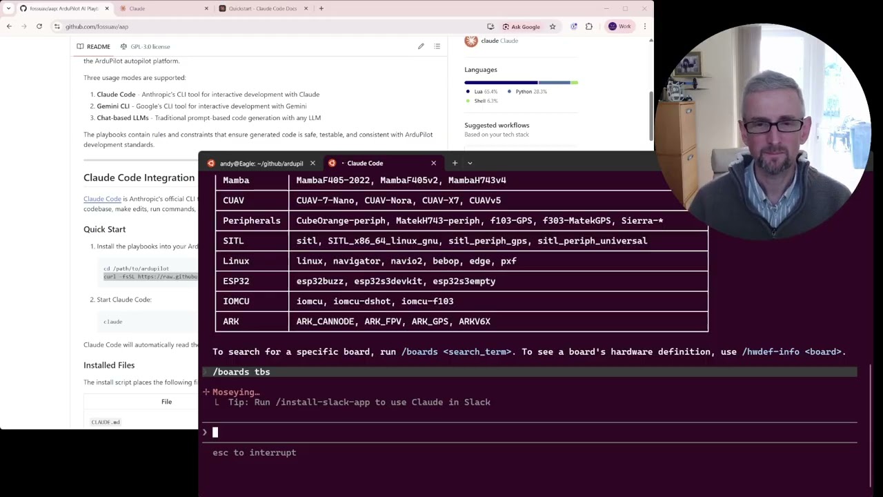

I have found the calibration scheme very unreliable. If you have claude you can use my playbooks to do a calibration through a strafing run - GitHub - fossuav/aap: ArduPilot AI Playbooks · GitHub
After read through a few times and study the structure. I am still lost.
Clone the ardupilot repo. Run the install script. Start claude then ask it how to do a proper flow calibration.
Does it need a GUI? Can I use Microsoft WSL to try and learn?
WSL is fine - that is what I use. No need for a GUI
