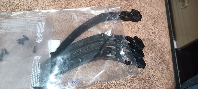

These are F450 ABS redesigned landing gears.
All has arrived. Only the Pixhawk 6C Mini, GPS, and Power Module is remaining.
I should now start extending motor wires and then soldering it somehow into ESC. Then soldering ESC signal wires to Pixhawk ESC out wires.
