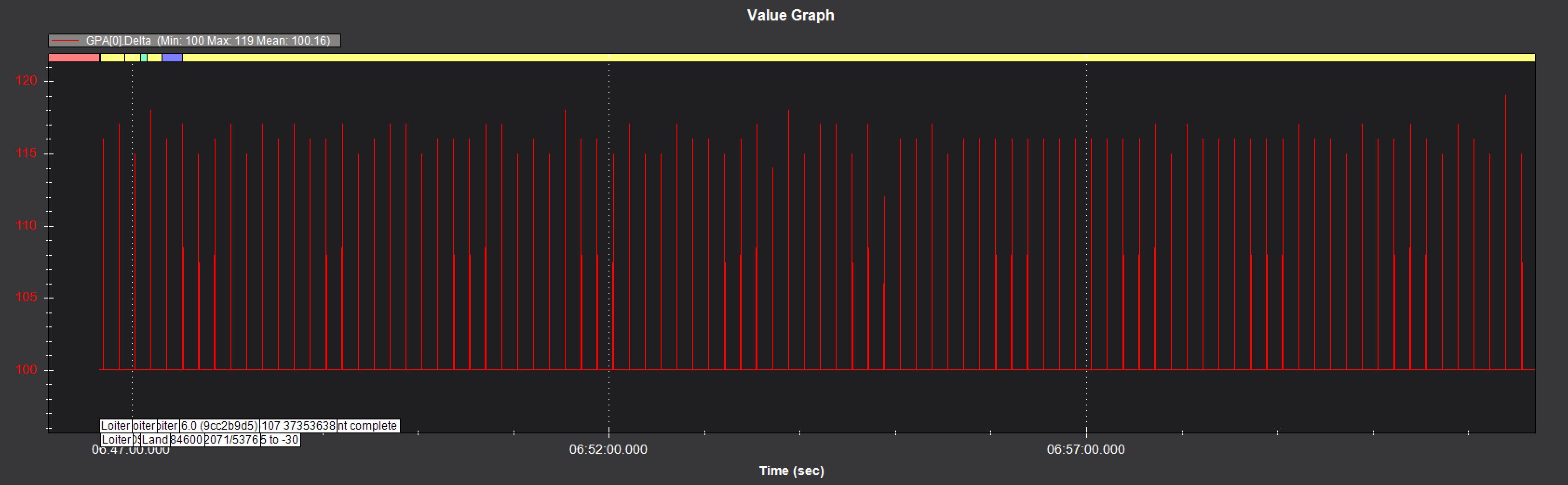

I think there is something else going on with that module. With the default update rate of 200msec (5Hz) that’s what should be seen here:
Not this, which would indicate an unstable ~10Hz rate. So it doesn’t appear to be Auto Configuring.
And, 50 Sats from a cheap module :thinking:
Set GPS_SAVE_CFG,1 and see what happens.
And perhaps set some explicit Constellations rather than default 0 which is leave as configured. Try 2 that work for your location.
