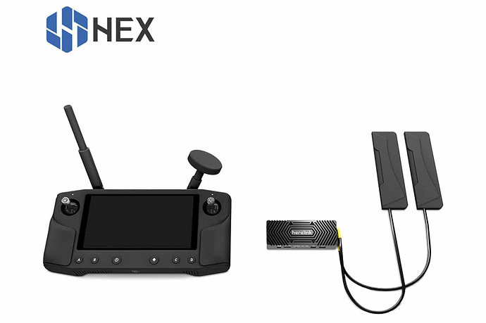

“here2 using UAVCAN” then why are u saying using here2?![here2-01|500x500]
The link you posted is about the herelink system and not the here2 GNSS unit!
I just quickly copied one link from cubepilot.org just to direct you to that site.
